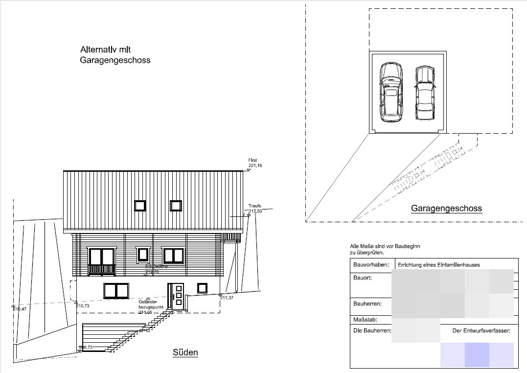

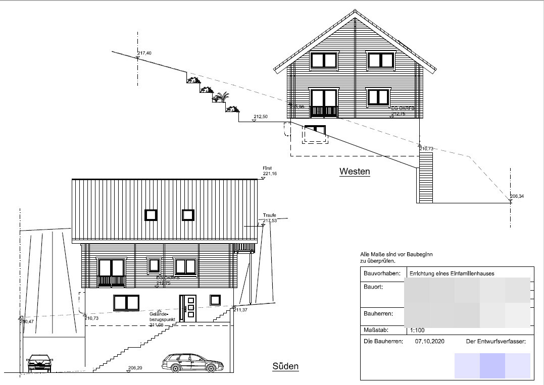

We are more or less about to start the project, and finally, the surveyor has sent the data to our architect.
Now we have a problem with the reference height: our building plot starts 7m (23 feet) from the property boundary, and according to the architect, the bottom edge of our garage is at about 4m (13 feet) elevation. This makes it impossible to create a reasonable driveway directly into the garage, as the slope would be around 50%.
Do you have any suggestions on how to keep this within a sensible range without having to create switchbacks for the garage entrance?
I have attached the architect’s drawings.
Thank you very much and best regards, Anson

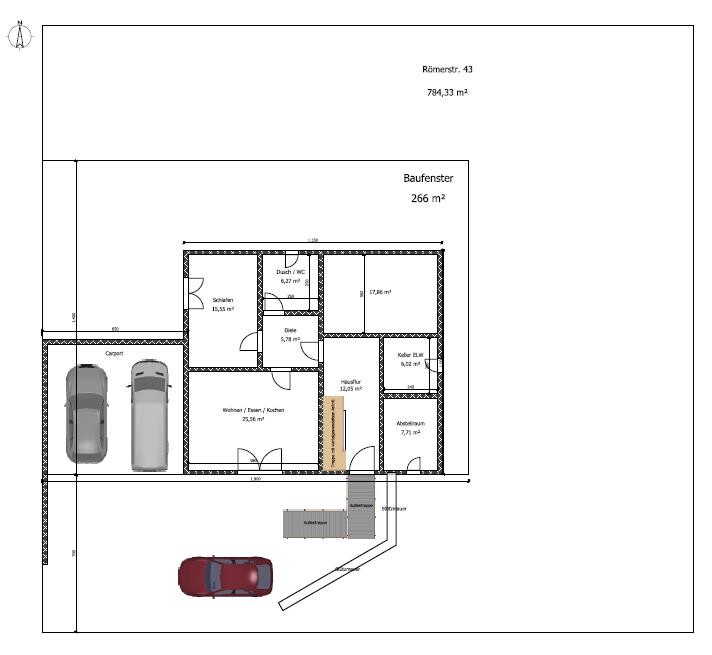

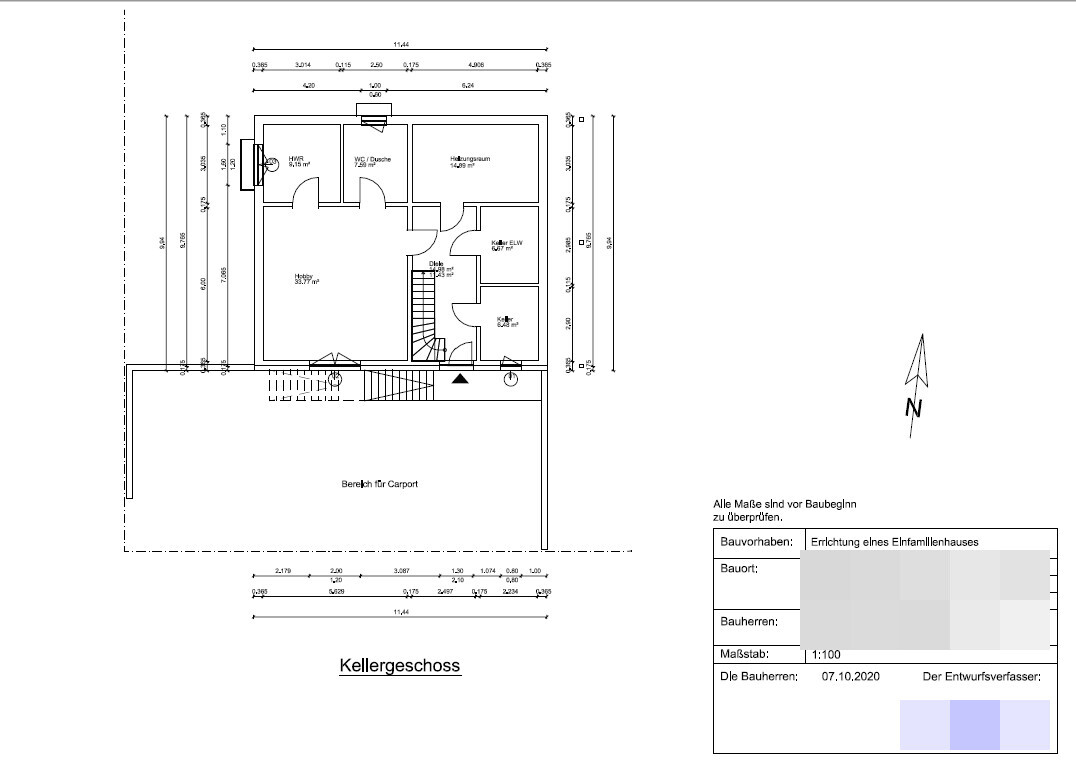

The architect made the attached proposals and still insists on her plan to place the garage under the house.
Unfortunately, I don’t know whether my idea is more sensible or even feasible.
We are also looking for an alternative plot; unfortunately, the only available plots at the moment are those shown in the site plan.
Regards, Anson
Architectural drawing of a two-story house with west and south elevation, roof, windows, and doors
Basement floor plan: utility room, toilet/shower, heating room, hobby room, cellar, hallway, stairs, carport.
Architectural drawing: house with garage floor, south elevation, sketch with dimensions.
Floor plan of a house with carport, living and sleeping areas, bathroom/WC, and outdoor area.

Plan smaller. This is too tight.
Build smaller. The basement floor provides good living space.
Make sure to include the outdoor area in your planning.
You don’t want the main garden to be on the north side.
Compare the costs of retaining walls and backfilling. Sometimes a larger outdoor area can be cheaper or cost the same.
11ant8 Oct 2020 13:18
Now you are considering the alternative of a fully subterranean double garage level beneath the house – but when I suggested simply lowering the double garage in the existing design by one and a half meters (5 feet), I received no response (?)
Anson Argyris schrieb:
The original budget was 600,000 euros without land
currently it is 700,000 euros without land, including a cautious estimate of 40,000 for the additional underground level
there is no buffer left, the maximum loan limit has been reached
This really sounds like a Pyrrhic victory just to avoid further searching. And no, 40,000 euros for a buried double garage is not a cautious estimate compared to the not uncommon 30,000 for an above-ground one.
