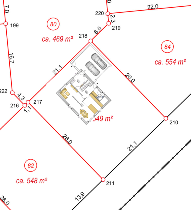

Buddy90
27 Jan 2026 08:48
This is the current plan regarding how to position everything on the plot.
I have already obtained several quotes for the trades. The budget is sufficient.
