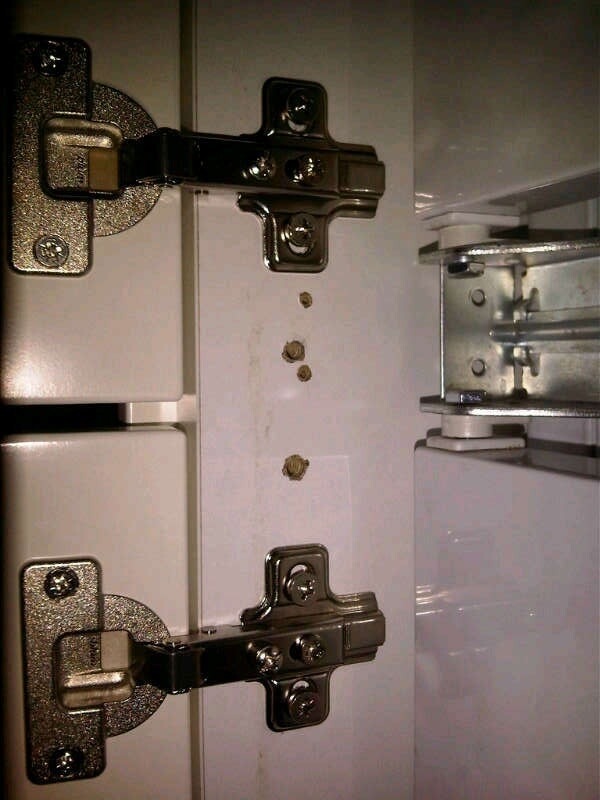

Oh man... can someone explain this to me:
After confirming not only in the forum but also directly with Ikea that there have been no changes to the Faktum cabinet carcasses, I now have to realize, after installing the doors on the cabinet for the fridge/freezer unit, that the gap between the doors is almost one centimeter (0.4 inches), even though the full adjustment range of the hinges has been used. Could it be...
I was already thinking of adjusting the hinges using the arrows, but that can’t be the solution, can it?
Any ideas?
Any ideas?

IKEA-Profi26 Feb 2013 20:31Are these the 153-degree hinges specifically for the cabinet with electrical appliances? Visually, they look like the standard 125-degree hinges.
That alone could be the reason, since NOT only the opening angle is different...

IKEA-Experte26 Feb 2013 21:04The hinges are the correct ones.
A photo showing the entire view can sometimes be helpful as well.

IKEA-Experte27 Feb 2013 10:04What are the dimensions of the cabinet and the doors?
