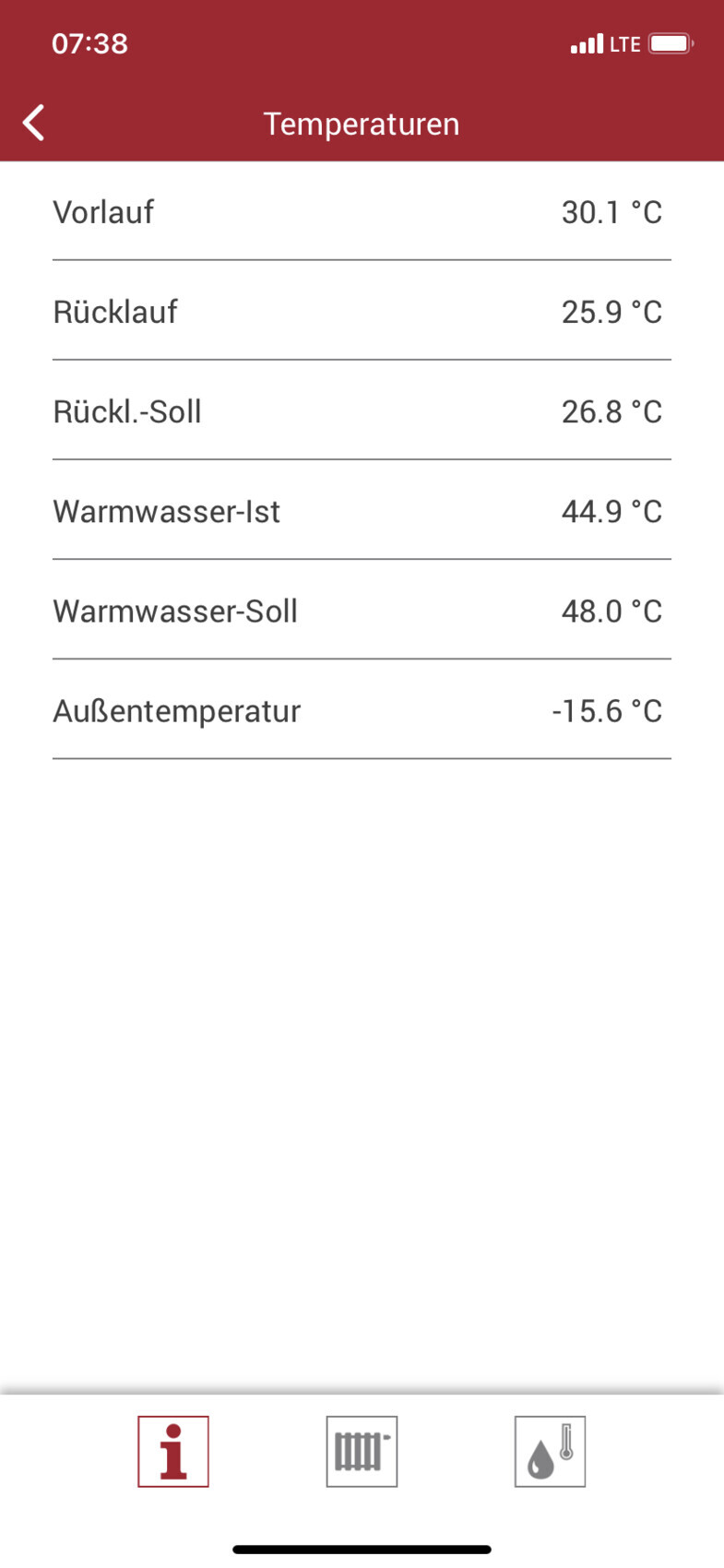

The heated area is 218m² (2,346 ft²). Last night it was really cold... my heat pump lets the return flow drop quite a bit. Compared to 9:00 pm yesterday evening, the indoor temperature is also slightly cooler.
Temperaturwerte der Heizungs-App: Vorlauf 30.1°C, Rücklauf 25.9°C, Außentemperatur -15.6°C
