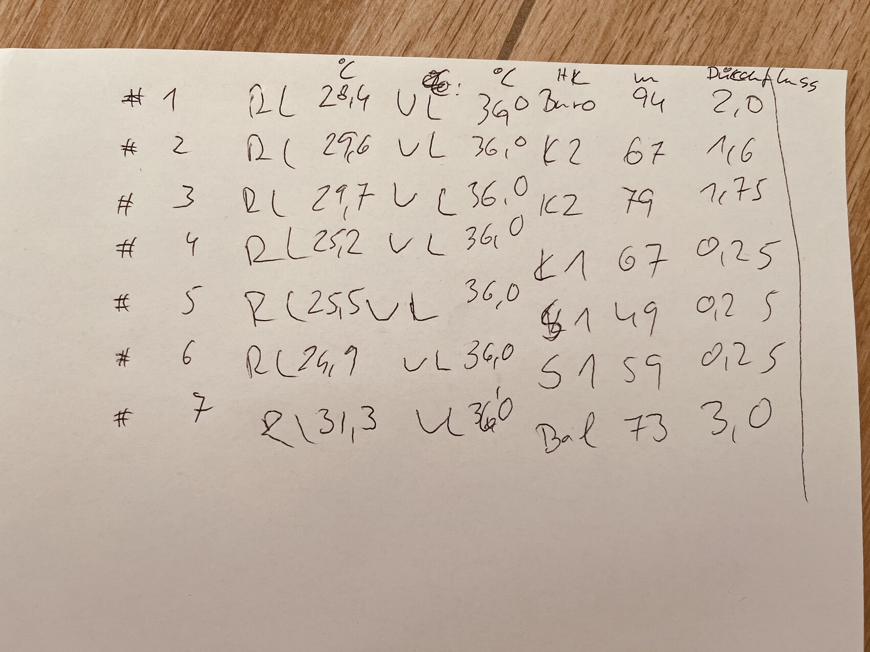

halmi schrieb:
Can you please measure the return flow temperature to check if it is really 22°C (72°F)? Also, measure each individual circuit to possibly find the short circuit.
However, I suspect that the cold return flow is coming from the now connected basement.
Here is the upper floor. Can you read this?
From left to right: return flow temperature, supply flow temperature, heating circuit, length, flow rate
Handwritten table with 7 measurement rows on paper, columns RL/VL and flow rate.
Measured directly at each heating circuit with the handheld IR thermometer.

So now the supply temperature is already at 36 degrees Celsius (97 degrees Fahrenheit)? With a heat pump? What about the energy consumption then? It should be completely out of control.

And it is.

9 Jan 2021 10:19
Zaba12 schrieb:
Here is the upper floor. Is this readable?
From left to right: return temperature, flow temperature, radiator, length, flow rate [ATTACH alt="16B198D0-6C75-46AE-B88D-7A1341B0DB0A.jpeg"]55861[/ATTACH]
Measured directly on each radiator using a handheld IR thermometer.
Hmm, the temperatures are quite high and differ significantly from the heating system’s readings.
I would remove the basement for now, as it will easily take 2-3 days to fully heat up otherwise.
