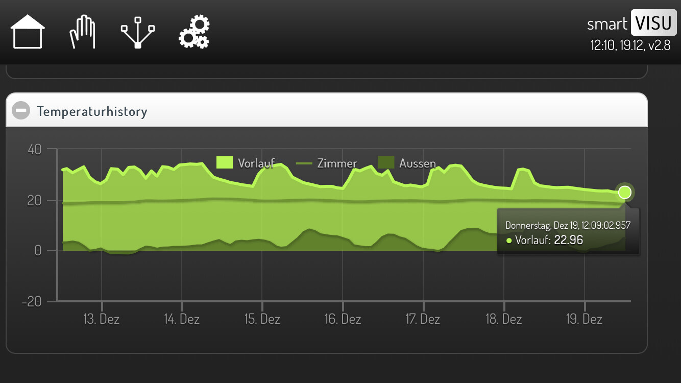

pffreestyler19 Dec 2019 09:22When I read this... I can't even set my Buderus 172-14 to a supply temperature below 30°C (86°F).
That’s not necessary. I don’t skimp on the temperatures. Everything is adjusted according to the outside temperature. In the bedroom, it’s constantly 19-20°C (66-68°F) no matter what. The living room, on the other hand, is usually around 24°C (75°F) thanks to sunlight. Still, I don’t want to pay more than needed. So the gas boiler is set to use only what is necessary. Nothing is being manually adjusted. The system regulates everything automatically.
And when the temperatures allow it, heating is not turned on at all. Just like now and since about yesterday noon. Only this morning the heating was on briefly due to hot water demand for showering. At the moment, the supply temperature is just under 23°C (73°F).
