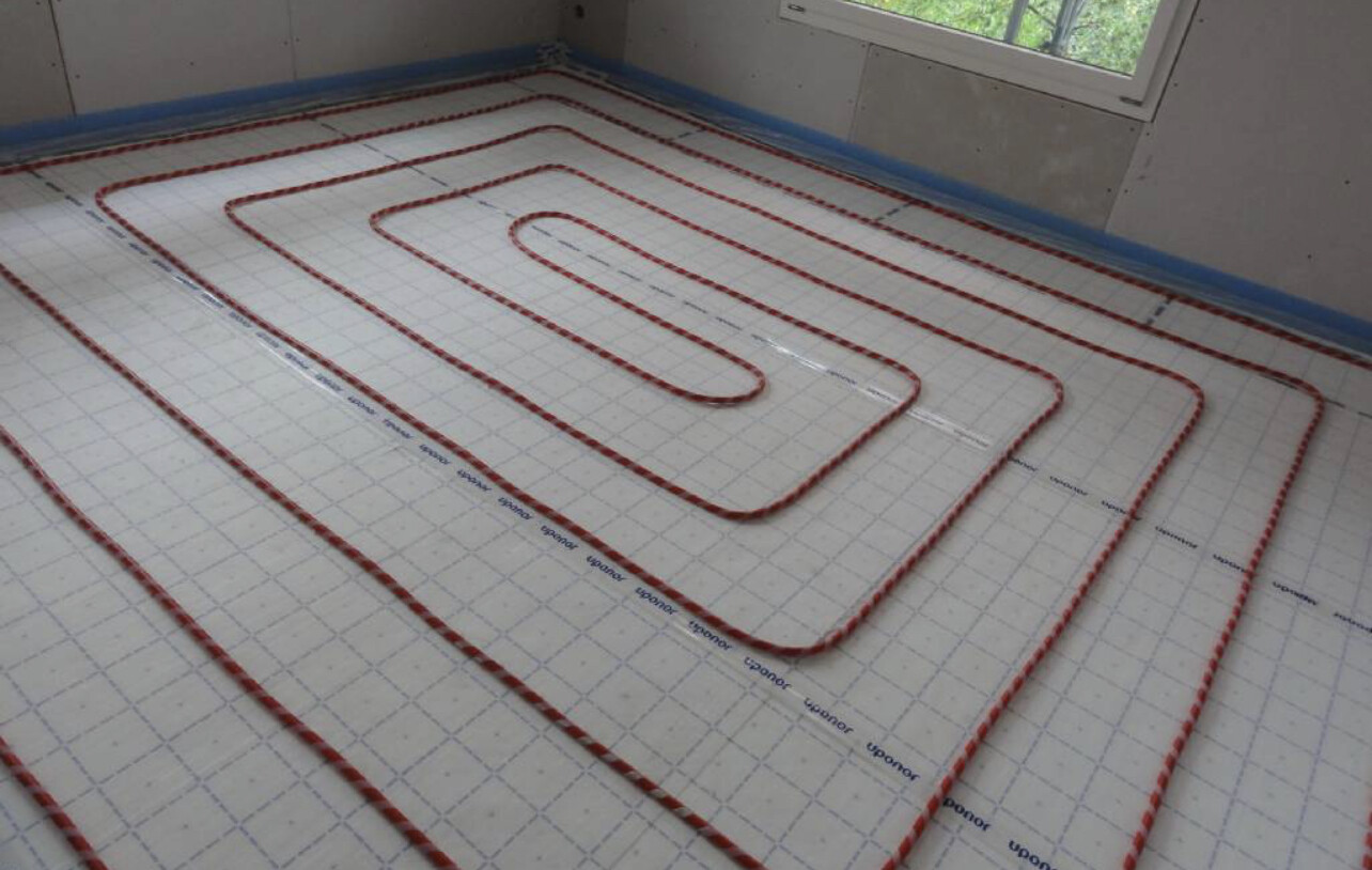

Large heat pump and balancing the installation. Running…
Underfloor heating: red pipe laid in a spiral pattern in a concrete slab, construction site.
Daniel-Sp
5 Jun 2021 19:01
But installed very, very precisely...
driver55
5 Jun 2021 19:01
Zaba12 schrieb:
Large heat pump and compensating for the installation. Works…
[ATTACH alt="6D5769BC-D8C8-42C6-9FE4-A4FB719AE200.jpeg"]62144[/ATTACH]
Help. What is this supposed to be? Can this still be considered underfloor heating? 😳

Zaba12 schrieb:
Large heat pump and compensating for the installation distances. Works.
Large installation spacing is compensated by higher supply temperatures. However, this does not require a higher heating capacity of the heat pump. Higher capacity is only needed for greater heat demand of the building. If the heat pump is oversized, the system tends to short-cycle, which affects its durability. Also, the investment costs increase, and in the case of a ground-source heat pump, the heat exchanger becomes unnecessarily more expensive.
That's 20cm (8 inches), right?
It can exist. With gas and 45°C (113°F) supply temperature, it's certainly possible.

Zaba12 schrieb:
Large heat pump and adjusting the pipe layout. It’s working…
[IMG alt="6D5769BC-D8C8-42C6-9FE4-A4FB719AE200.jpeg"]https://www.hausbau-forum.de/data/attachments/61/61511-7c526a80c3e025d89aae6532a8ca76ce.jpg[/IMG]
With a layout like that, I would have saved 1,000 m (3,280 ft) of piping and a lot of labor time. You should have posted it earlier 😉
