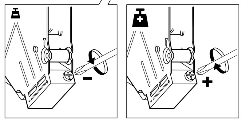

Is it possible to adjust the hinge so that the door "locks" in place at a 90° opening? At the moment, I always have to hold the door with one hand, which probably isn't how it was intended to be used.

2 Jan 2016 18:10
If you loosen the springs, the door will stay open at 90°.

Two diagram sketches show a valve being opened and closed with a screwdriver on a plumbing fixture
or -

2 Jan 2016 18:55
less voltage = -

3 Jan 2016 11:45
You need to increase the tension in the springs so they can hold the door open properly.

3 Jan 2016 11:52
This is how misunderstandings arise. I assumed the door would open the full 107° and that you would need to hold it at 90° to be able to reach it again to close it.
