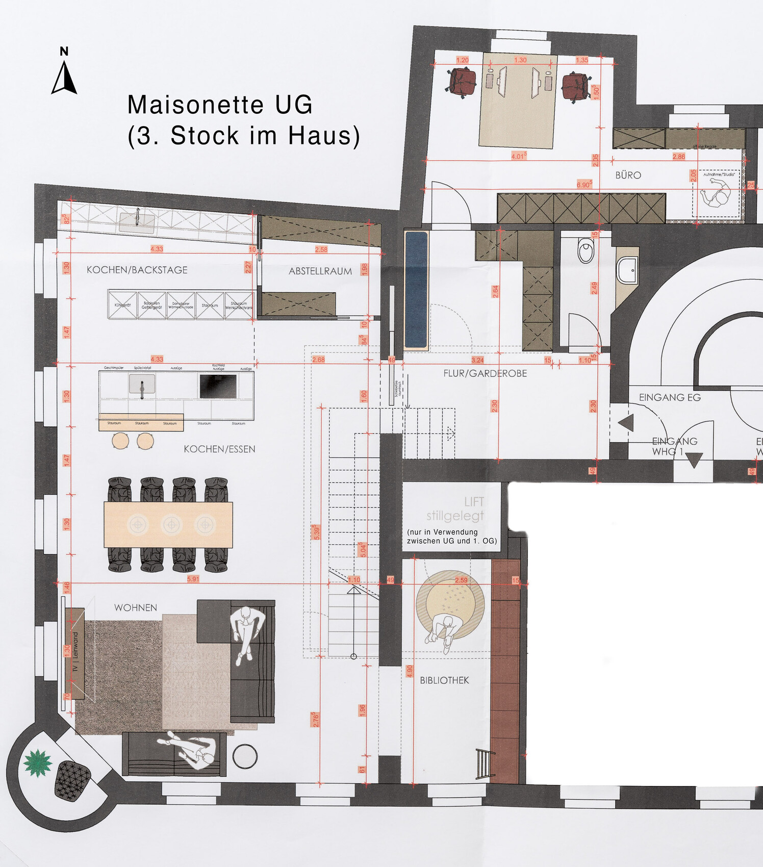

Hello dear forum community,

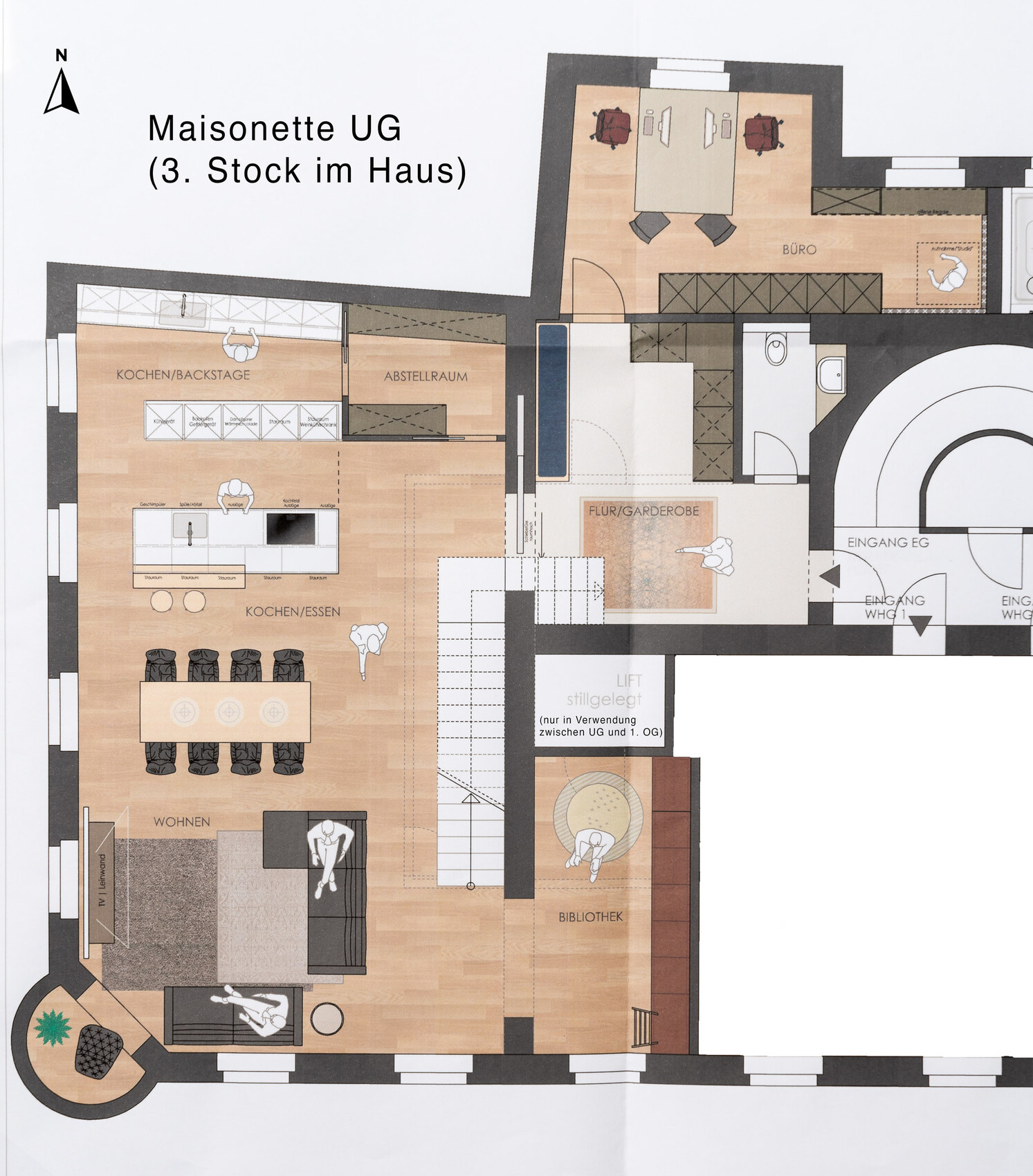

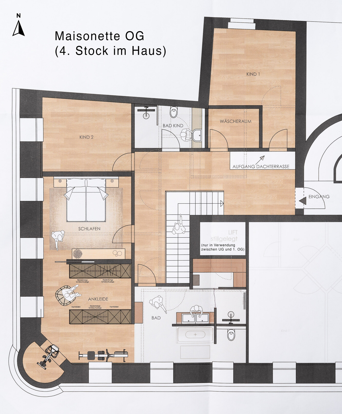

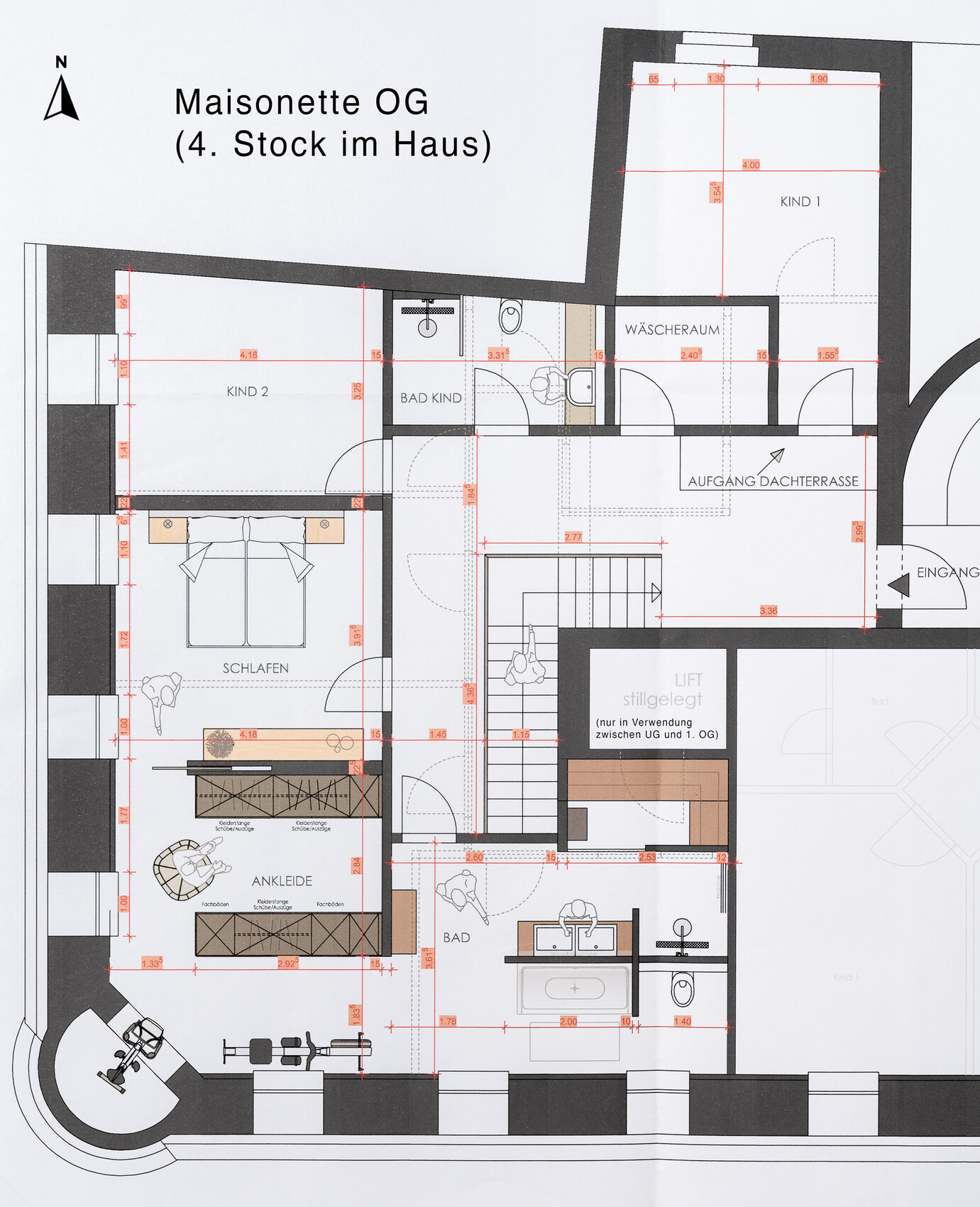

my wife and I are currently working with an interior designer to plan our future apartment in an existing townhouse. We are planning a maisonette with approximately 200 sqm (2,150 sq ft) of usable space plus a roof terrace. The design options are still very flexible. Currently, the floors are not yet connected (except for the main stairwell). The spaces were used commercially until recently; a few decades ago, they were residential units. There are only a few load-bearing walls. Apart from the exterior walls, we have a lot of freedom, and our interior designer has created an initial plan based on the latest building plans (of course, everything will be re-measured, floors opened up, checked by a structural engineer, etc.). Floors, ceilings, interior walls, heating, electrical, plumbing, and so on will all be newly installed. High ceilings (3.50 m (11.5 ft) in the basement, 3 m (9.8 ft) upstairs) also allow for some technical installations to be accommodated in (partly) suspended ceilings.
Restrictions/Requirements
- Townhouse from 1860, completely renovated at the end of the 1980s, including the addition of one floor (previously three, now four stories)
- The façade is under heritage protection, meaning no visible changes to the windows are allowed
- Total living space per floor approximately 300 sqm (3,230 sq ft)
- Size of the owner’s apartment: about 200 sqm (2,150 sq ft), divided over two floors of about 100 sqm (1,075 sq ft) each
- Adjacent living areas on both floors are either occupied by the owner’s family or currently vacant and being converted for rental
- Orientation: windows facing south and west
- To the north, the neighboring house is adjacent; the office and child’s room 1 window look onto an inner courtyard
Owner’s Requirements
- Floors: 2 floors (3rd and 4th floor in the building) plus an added roof terrace (not existing yet; planned conversion/extension of the attic above the 4th floor)
- Number of residents: 2 adults (+ 2 children planned)
- Age: 33, 34 years
- Rooms needed on lower floor: entrance/hall, wardrobe, office for two persons, open kitchen-dining-living area, backup kitchen/laundry room, library/playroom
- Rooms needed on upper floor: master bedroom, walk-in dressing room, master bathroom including fitness/wellness area, 2 children’s rooms, children’s bathroom, possibly laundry room (if not on lower floor), access to the roof terrace
- Office: both self-employed, full workplaces for two people
- Overnight guests per year: minimal or none planned
- Open architecture, open kitchen, freestanding island, freestanding staircase in living space
- Modern construction methods where possible in the existing building
- Number of dining seats: at least 8
- Fireplace: wood possible (existing chimney shaft), ethanol fireplace might be better/more flexible as a design element regarding location?
- Roof terrace: planned with the attic conversion above the upper floor
- Heating: underfloor heating (no problem on the lower floor due to high floor build-up, upper floor still to be checked, if necessary radiators/wall heating)
- Cooling: chilled ceiling (summer in the city center can get very hot and likely will get hotter in the future)
Floor Plan Draft
- Designed by the interior designer
- Likes: generous layout, plenty of storage but still not cramped
- Uncertainties: exact location of the roof terrace access (might mean giving up a separate laundry room)
- Price estimate from the interior designer: to follow shortly but not relevant yet
- Personal price limit for the apartment: no specific limit
Most Important/Fundamental Questions about the Floor Plan
- Have we overlooked anything in the floor plan?
- Should the living room area remain completely open or be partially separated by a room divider (maybe sufficiently structured by different ceiling heights in suspended ceilings)?
- Our idea is to forgo a traditional TV and install a projector and screen in a suspended ceiling – does anyone have experience with this?
- Is it better to have the laundry room upstairs or on the lower floor in the utility room?
- Is a controlled ventilation system worthwhile? Possibly decentralized in the bedrooms (on the upper floor this is possible since the façade is not heritage-protected there), but there is concern about street noise in the city center.

Floor plan of a maisonette (basement): kitchen, dining, living, library, office.
Upper floor plan: sleeping, dressing room, bathroom, child 1/2, laundry room, stairs, roof terrace access.
Floor plan of the maisonette basement, 3rd floor: kitchen/dining, living, library, office, elevator, entrances.
Floor plan of a maisonette upper floor with bedroom, dressing room, bathroom, two children’s rooms and roof terrace

Okay, I think I understand what you mean. It’s funny because we usually start from our own perspective, which is exactly why it’s good to join a forum like this one.
My own childhood bedroom wasn’t very large (with a bigger apartment, you tend to spend time playing or reading elsewhere, and the “library” in the plan will probably serve as a playroom, music room, or something else), my childhood bathroom (shared with my sister) had no window, and I spent many happy hours splashing in the bathtub in my parents’ bathroom filled with bubbles; later on, when they added a steam function to their shower, that was a nice bonus. The hallway in my parents’ home also didn’t have natural light but had plenty of lamps instead.
Of course, building standards and habits were different 30 years ago, and looking back, there’s definitely room for improvement. I just want to point out that children’s expectations may not be as high as you sometimes think.
Compared to a “classic” detached house, my plan’s biggest drawback is that due to the apartment’s position within the building and the building’s orientation, the entire east side and most of the north side have no windows. Unfortunately, there’s nothing we can do about that. But on the bright side, having windows on two sides is still better than just one (and in this case, south and west), and because we’re quite high up, a good amount of natural light comes in. Having natural light in every single room, including closets and hallways, is really difficult or impossible. In the basement, maybe with frosted glass doors, and upstairs from the access to the roof terrace, so it won’t be that bad.
But first, the staircase should be planned. It connects your three levels and is the main traffic route.
I fully agree with you here. I’ll clarify this with the architect as soon as possible, and then we’ll adjust the plan again. I’ll keep you updated. 🙂
Thanks again for all your previous responses. If you have any more ideas or want to completely rethink the plan, don’t hesitate to share. :p

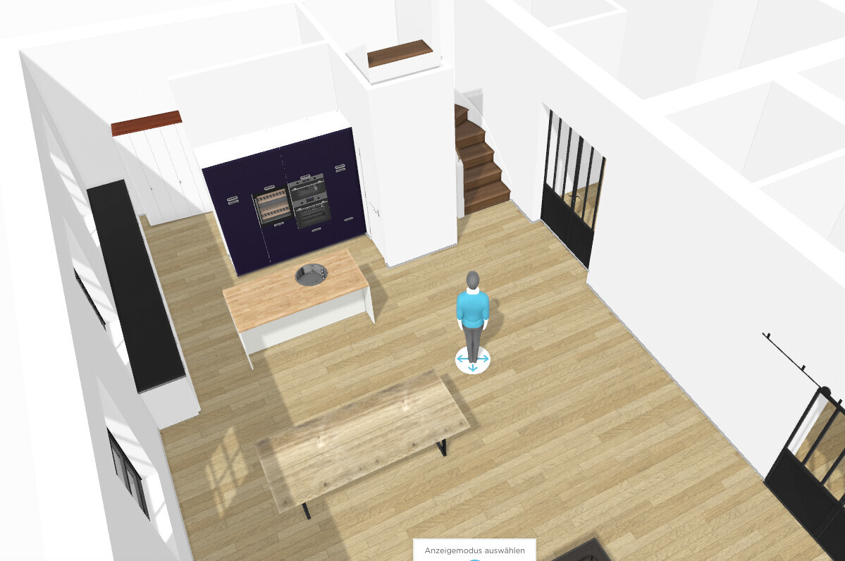

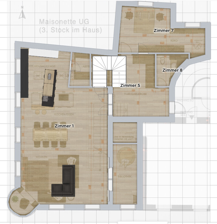

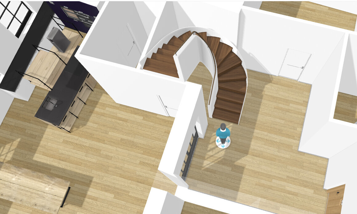

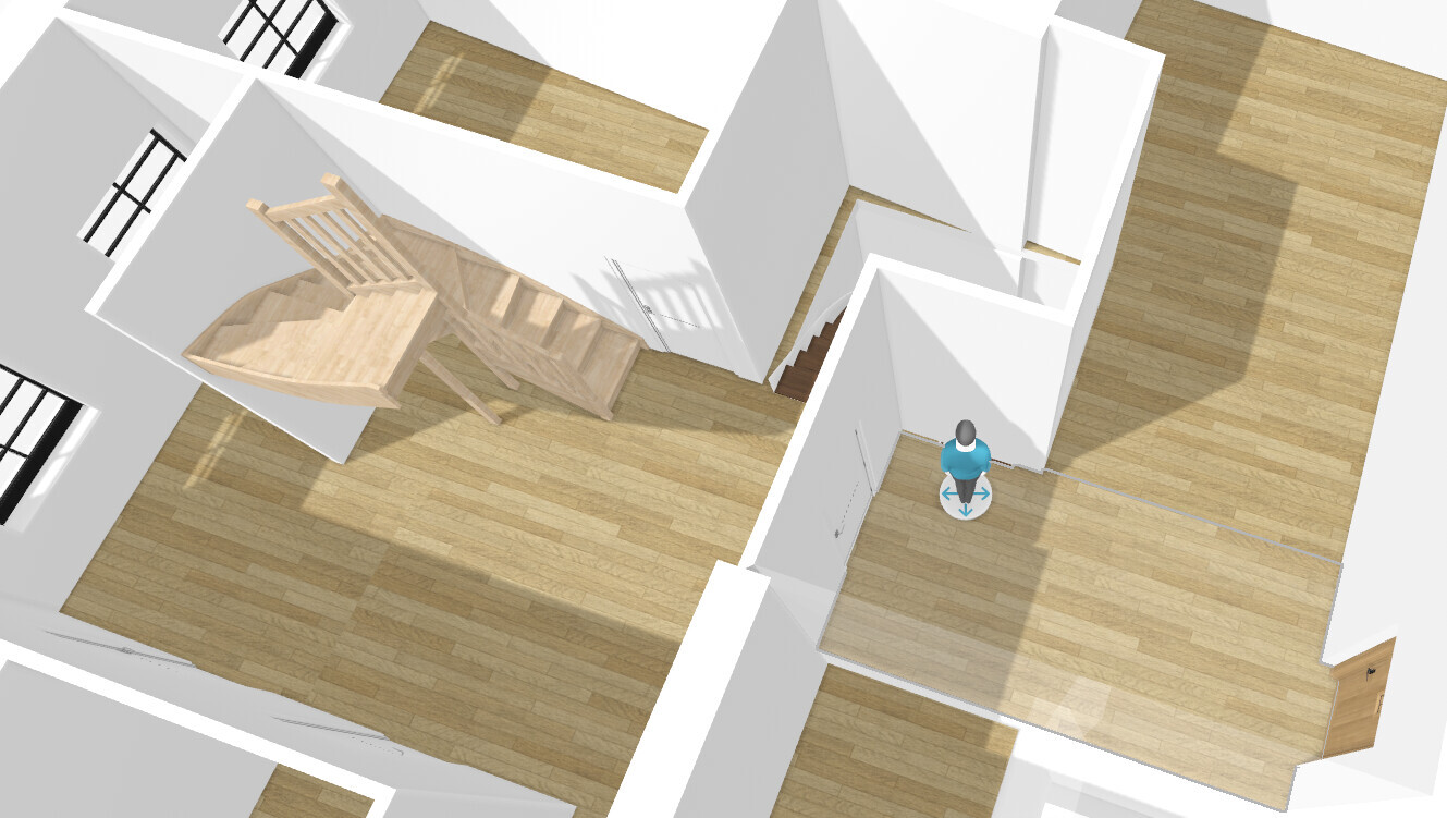

I played around with the walls once, regarding the staircase layout... but I’m deleting that now because I need the project layer, so here it’s preserved again 😉
Floor plan of an upper floor with master bedroom, two children’s rooms, hallway, bathroom, dressing room, and utility room.
3D floor plan of a living space with light wood flooring, spiral staircase, and avatar in the hallway
Top view of a modern interior with spiral wooden staircase, kitchen, wood floor, and person.
Floor plan of a maisonette apartment: living room, kitchen, dining area, library, hallway, and stairwell.

I played around with the walls a bit to explore a possible staircase layout...
Wow, thanks for your effort! I find the staircase from the basement to the upper floor a very interesting alternative. Structurally, I would have to check this because one of the few load-bearing walls would be broken through. The (relatively spacious) hallway/vestibule loses some area and storage space. Here, you could either shift the door to the office (room 7) slightly to the left to fit cabinets on the right or consider a solution under the stairs.
On the upper floor, you created space for an efficient access to the roof terrace, which is great. Apart from that, I am somewhat more skeptical. The hallway feels more like it has become larger rather than smaller (probably unavoidable in general for terrace access). Whether one wants more light in the hallway or in the dressing room and master bedroom is probably a matter of preference. I agree that the bedroom doesn’t need much light. It would definitely be nice to have more light in the dressing room and then a direct connection to the bathroom. Given the size, is there really only room for one shared family bathroom? Or would the utility room at the bottom right become a children’s bathroom? My dream of a fitness area would probably not be feasible then.
I will also ask the architect if it might be possible to build the staircase from the upper floor to the terrace directly above the staircase from the basement to the upper floor — maybe that could work out.

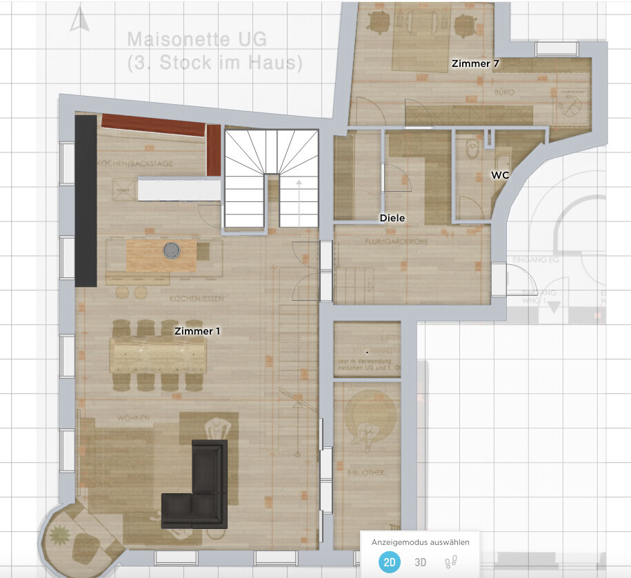

6 Mar 2021 11:08
misterNES schrieb:
Structurally, I would need to have that checked, since one of the few load-bearing walls is going to be opened up.
Is it really a load-bearing existing wall? I was just surprised because the planned staircase for you also breaks through it, and a sliding door in a solid wall also seems odd to me 😉 The opening would have to be properly supported, or does it already exist?

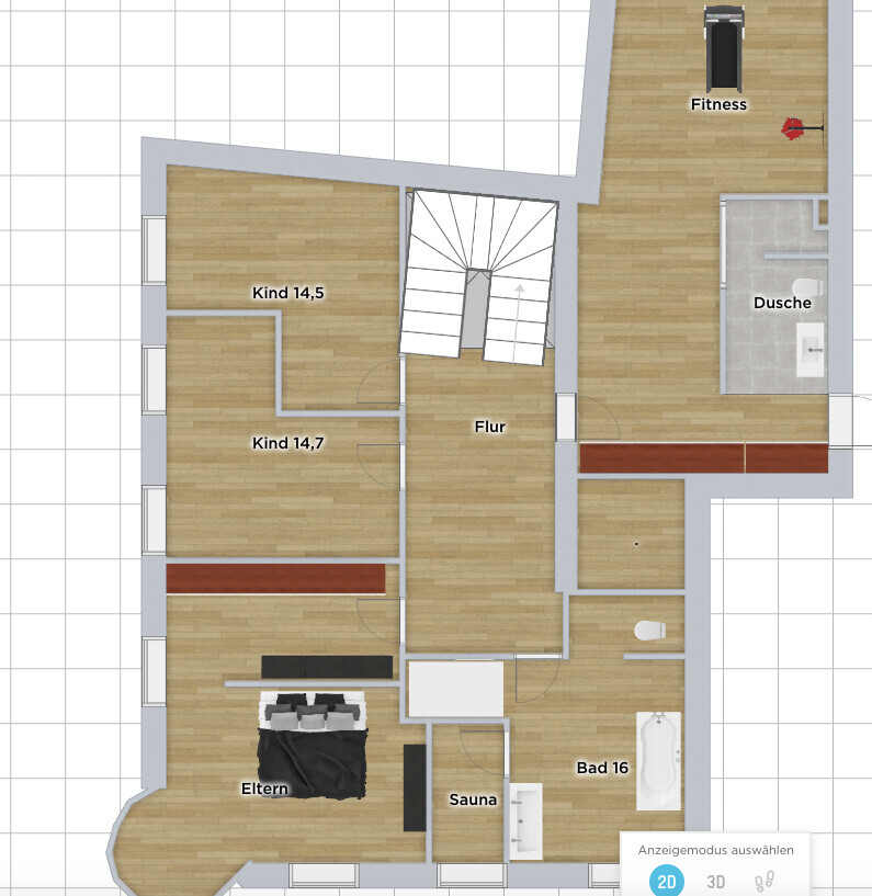

misterNES schrieb:
My dream of having a fitness area probably won’t be feasible then.
misterNES schrieb:
The hallway actually feels bigger rather than smaller (which might be inevitable for the terrace access).
Sorry, the text wasn’t included: the hallway has a fitness area by the windows behind the staircase. This space can fit 2-3 training devices, a mirror, and either a ballet barre or a TV. The hallway has some livable space. There is also room for storage for terrace equipment.

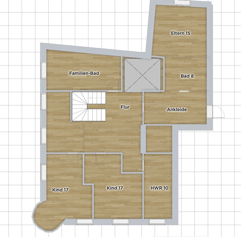

6 Mar 2021 19:18
Me again 🙂
I haven’t deleted this yet... and regarding the load-bearing wall and the staircase, here’s another idea—at least it’s close to yours but fair to everyone 😉
P.S. The stairs are now aligned one above the other, and the fitness area can also be used by the kids.
