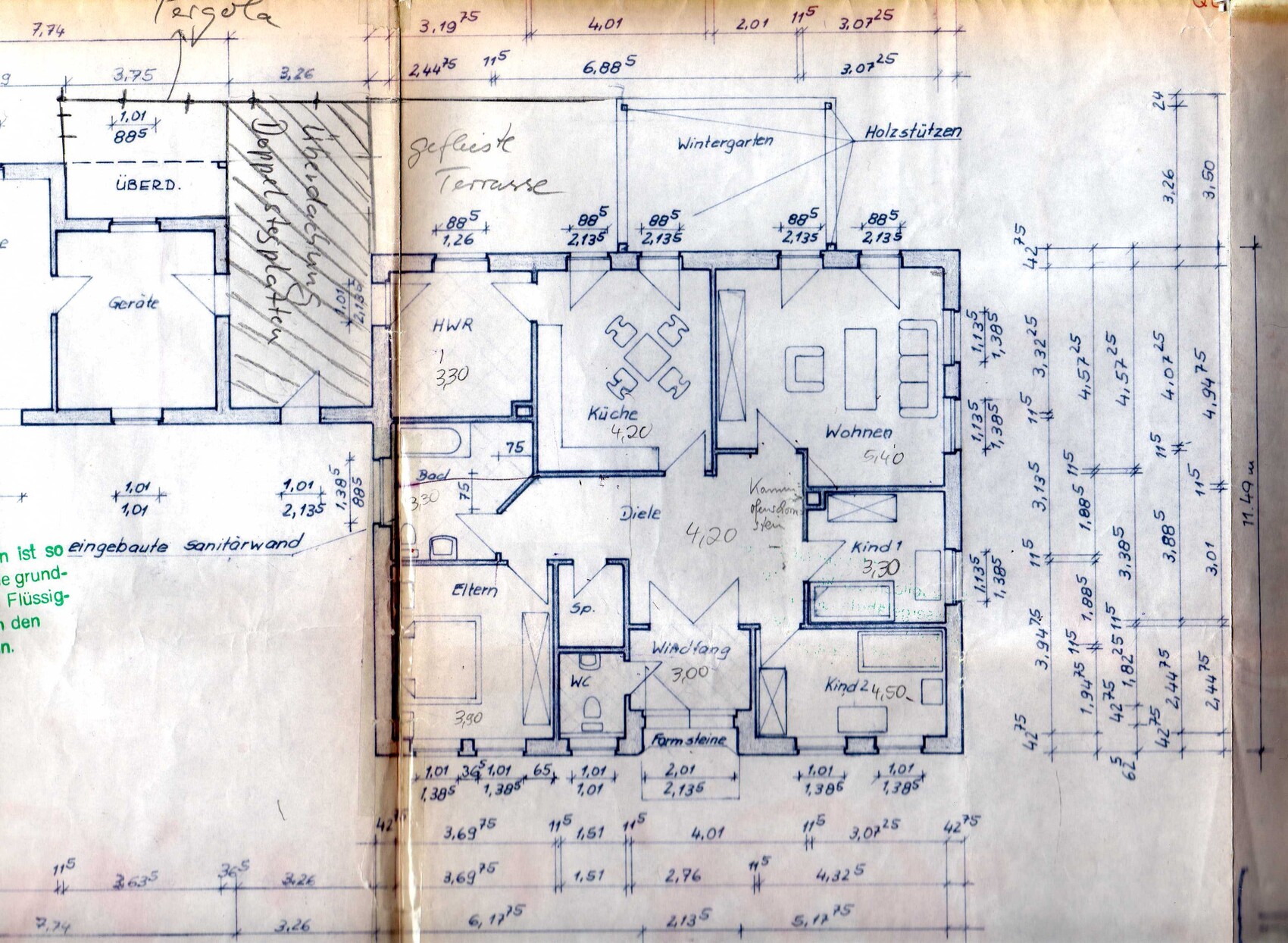

I am new here and could use your help. We are the owners and residents of a hipped roof bungalow. Now that we have a child and are planning for more in the medium term, we want to convert the existing attic into living space.
We are currently facing the problem of not having a clear idea where to place the staircase. Although the hallway is quite large (unfortunately, because this means losing actual living space), there still seems to be hardly any room for a staircase.
We have considered a few ideas:
1. A straight staircase from the kitchen door up toward the bathroom door (problem: the hallway is only 1.85m (6 ft) wide, so the staircase would make it very narrow)
2. A built-in staircase in the pantry (problem: the pantry is only 1.51m (5 ft) wide, so this option is probably not feasible)
3. Combine Child’s Bedroom 1 with the living room, close the door to the bedroom, and install a straight staircase from the middle of the hallway toward the new living room (problem: the staircase would divide the hallway, and you would always have to walk around it)
4. Same as option 3, combine Child’s Bedroom 1 with the living room, close the old door to the living room, and install a half-turn staircase with a landing in the newly created corner (problem: the convenient access to the living room would be lost, and closing the current (glass) living room door would make the hallway darker)
5. Sacrifice Child’s Bedroom 1 and install a half-turn staircase with a landing there (problem: this would sacrifice a lot of living space)
Do you perhaps have a good idea?

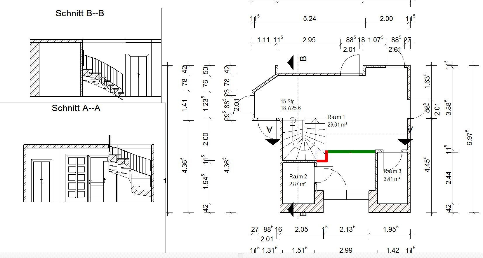

It’s not possible from the bathroom side, since you can only use up to 295 cm (116 inches) there.
And honestly, I don’t see your problem with version 2. It’s just about the small corner that needs to be added here, marked in red. The green shows the existing vestibule wall. The door there might need to be moved slightly to the right.
Otherwise, you should draw in where everything is located. I created versions 1 and 2 using the dimensions from the floor plan you posted.
Also, if the staircase is properly designed, you can place built-in cabinets or cupboards under the stairs on the right side.

Silke123
5 Jan 2015 15:49
Sorry, I was confused. I thought the entire wall of the vestibule would need to be moved closer to the entrance door. If it’s just that small corner, then it really shouldn’t be a problem.
I also really like the last suggestion because I’m a big fan of the half-turned staircases.
Thank you very much for your effort!
