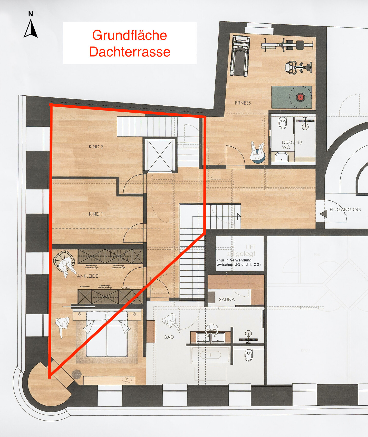

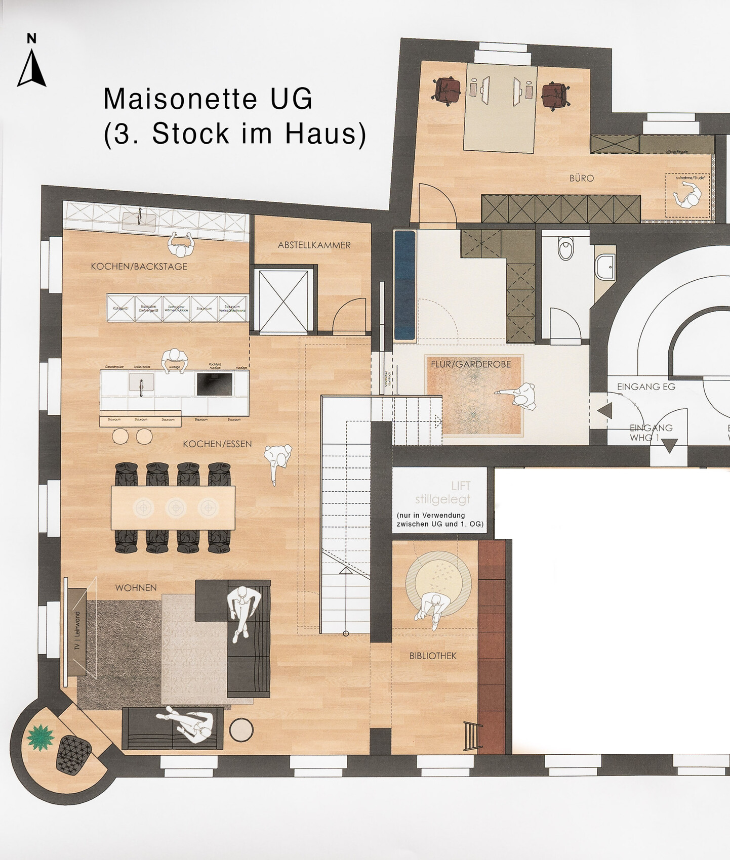

Floor Plan Draft
- Designed by the interior designer
- Likes: generous layout, plenty of storage but still not cramped
- Uncertainties: exact location of the roof terrace access (might mean giving up a separate laundry room)
- Price estimate from the interior designer: to follow shortly but not relevant yet
- Personal price limit for the apartment: no specific limit
Most Important/Fundamental Questions about the Floor Plan
- Have we overlooked anything in the floor plan?
- Should the living room area remain completely open or be partially separated by a room divider (maybe sufficiently structured by different ceiling heights in suspended ceilings)?
- Our idea is to forgo a traditional TV and install a projector and screen in a suspended ceiling – does anyone have experience with this?
- Is it better to have the laundry room upstairs or on the lower floor in the utility room?
- Is a controlled ventilation system worthwhile? Possibly decentralized in the bedrooms (on the upper floor this is possible since the façade is not heritage-protected there), but there is concern about street noise in the city center.
Dominik
Floor plan of a maisonette (basement): kitchen, dining, living, library, office.
Upper floor plan: sleeping, dressing room, bathroom, child 1/2, laundry room, stairs, roof terrace access.
Floor plan of the maisonette basement, 3rd floor: kitchen/dining, living, library, office, elevator, entrances.
Floor plan of a maisonette upper floor with bedroom, dressing room, bathroom, two children’s rooms and roof terrace

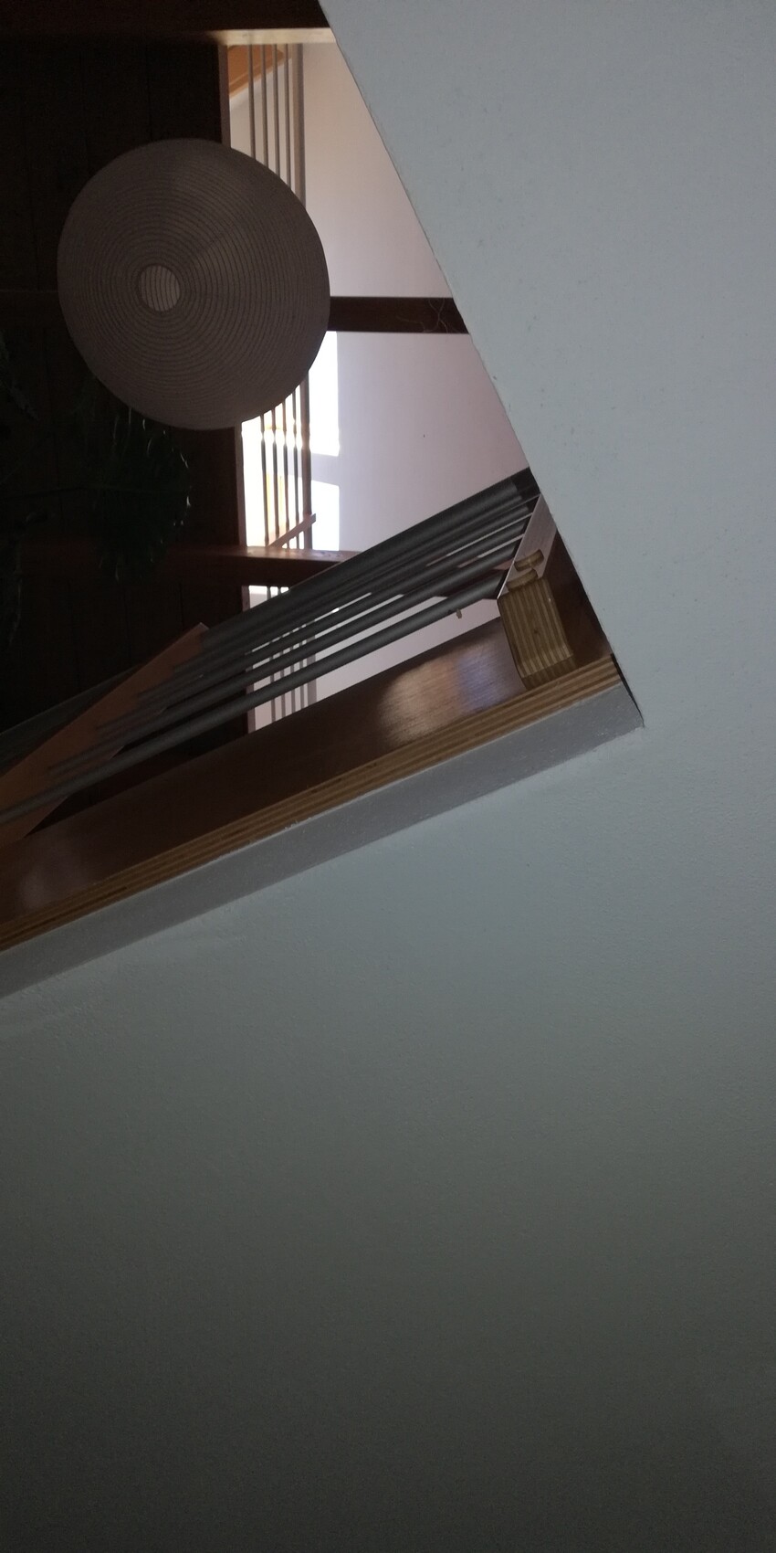

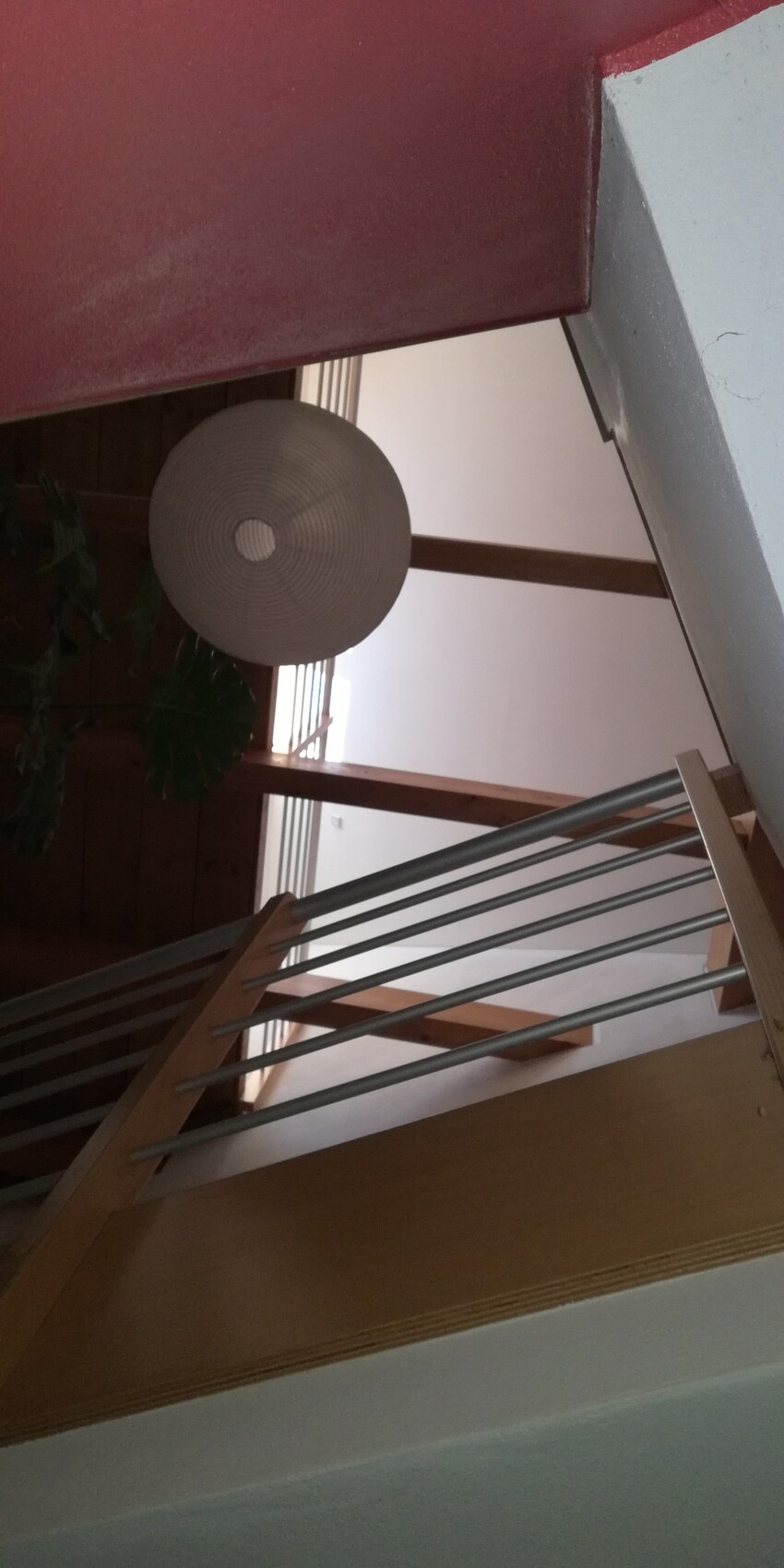

Round pendant light over staircase; railing with wooden handrail and metal rods, plant in the background.
Large round woven pendant light in the stairwell next to wooden railing.

@icandoit thanks for your photos as well. It doesn’t really look like there is much natural light, but that probably depends on various other factors.

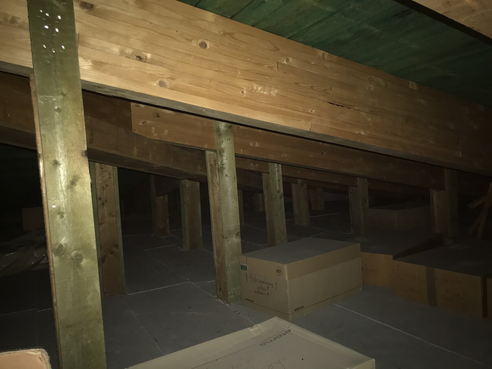

In the next two weeks, we will also visit the installer and take a close look at different options like chilled ceilings, wall heating, etc., in the showroom. An attic inspection is also planned, to explore the possibilities for the roof terrace (I am attaching a photo to show how it looks up there).
I’ll keep you updated, but since we’re not in a hurry with the renovation and don’t even know if it will take place this year or next (the architect advises the latter, to allow more time for planning/tendering, etc.), there may be a few days or even weeks between updates.
Dachboden mit Holzbalken, Stützpfosten und Kartons auf dem staubigen Boden.

I’d like to share an update with you. For your information, we’re still at the rough planning stage (structural measures, etc.). The detailed planning (bathroom layout, etc.) will come later, and construction will only start next year.
I’ve attached the new floor plans and summarized the changes here:
  • A passenger elevator has been integrated (see further considerations below)
  • Access to the roof terrace now meets the actual requirements
  • Children’s bedroom 2 is now on the west side, and the northern room has been changed to a fitness room with an adjacent children’s bathroom (based on an idea from @ypg)
  • The walk-in closet and master bedroom have been swapped
I’d like to go into a few things in more detail:
Passenger Elevator
The biggest benefit is the direct connection from the kitchen to the roof terrace without long walking distances. Initially, I had planned only a dumbwaiter, but the space required for a (small) fully functional passenger elevator isn’t much larger, and with it, you can comfortably transport many things upstairs at once using, for example, a serving cart.
Other advantages: The roof terrace can also be used with limited mobility, and it provides an alternative route to the upper floor without having to go through the living area.
Staircase from Basement to Upper Floor
I have received many great suggestions from @ypg and others here, which I discussed in detail with my architect, who has been working on various options. Unfortunately, the (otherwise lovely) high ceiling complicates things. To overcome the floor height, 23 steps and a landing (required by regulations) are necessary. To position the staircase so you exit at a sensible point without compromising the floor plan (meaning on the interior side of the house, so that living spaces really have windows), the staircase placement is quite limited. We personally like a freestanding staircase in the dining-living area (underneath there would be space for a large fireplace), but it’s hard to say whether the potential “through traffic” would be bothersome. As mentioned before, the door to the stairwell on the upper floor can be “activated” anytime (especially useful during teenage years).
Size of the Children’s Bedrooms
It’s understandable that the comment was made that the children’s bedrooms are only 12 sqm (129 sq ft) in a house of this size. But considering that the future children will have their own playroom in the “library,” and there is enough storage for seasonal clothing, toys, etc., both within the apartment and in other parts of the house (attic, basement), are 12 sqm really too small? I myself grew up in a 12 sqm room in a 180 sqm (1,938 sq ft) apartment, but one shouldn’t always compare to one’s own experience.
And what would the alternative be? We are bound by the window locations (heritage protection), so either we give up the walk-in closet entirely to enlarge the children’s rooms, or I move everything around: children’s bedrooms go to the south, which reduces the size of the master area; the children’s bathroom is then quite far from the bedrooms; and the master bathroom somewhere in the west would be far from the plumbing connections (and the ceiling below would likely have to be lowered more due to the roof slope).
I’m really looking forward to your opinions on this point 😉
One more note: As part of our renovation, on the same floor as our basement, we will create two apartments totaling around 200 sqm (2,153 sq ft) for (short-term) rental. The smaller of the two apartments could be used as a “youth area” during the older children’s teenage years. Whether this partition is desired, of course, is another question.

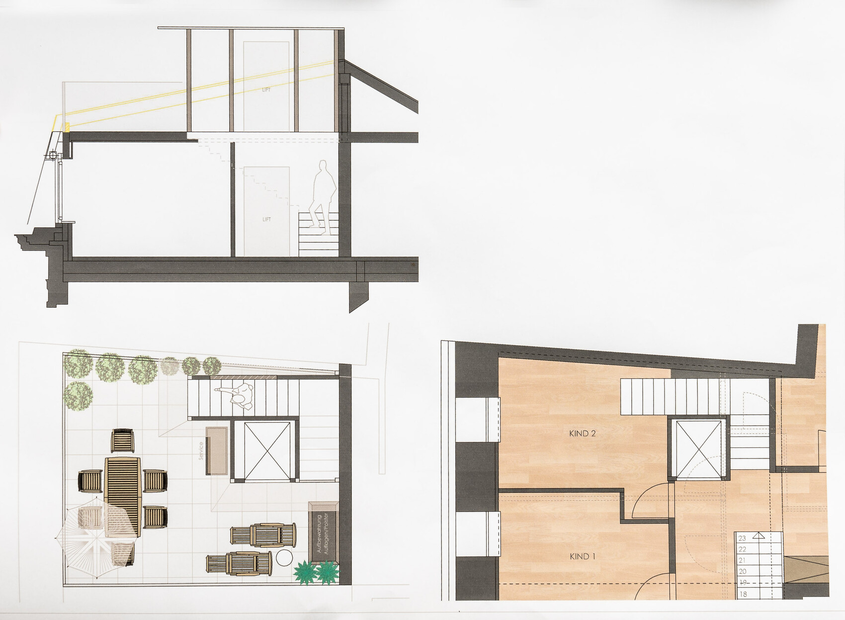

Roof Terrace
This is probably the most complex (and expensive) part of the renovation in this existing building, but still manageable. A structural engineer has already looked into it and given approval. We now know that the ceiling of the upper floor is not self-supporting, but is suspended from the roof frame by large glued laminated timber beams. To build a roof terrace here, the (copper) roof must be opened and the ceiling removed; then steel beams are inserted into load-bearing outer and inner walls; afterwards, it’s closed up again (the ceiling is now load-bearing) and finally, the terrace structure is placed on top.
I apologize for my amateur wording, but I’m sure the attached plans will help you understand what I mean. The large load-bearing glued laminated beams cannot be completely removed because the roof structure over the adjacent apartment of my parents must not be altered. I’ve also attached a plan with a possible floor layout for the roof terrace marked in red, showing the maximum possible area.
Thanks in advance for your time — I’m looking forward to your responses! 🙂
Floor plan of the maisonette basement level: kitchen/dining, living, library, office, hallway/wardrobe, entrance.
Floor plan of the maisonette upper level: bathroom, shower/WC, sauna, fitness, two children’s bedrooms, elevator.
Architectural section of the building with elevator and stairs, terrace with garden furniture, floor plan CHILD 1/2.
Floor plan: roof terrace with red outline; left children’s bedroom, walk-in closet and bedroom.
hanghaus2000
16 May 2021 08:59
Much better. But also significantly more expensive. What does the architect say about the costs for the loft and elevator?
Elevator shaft and stairs to the loft—what does the structural engineer say? How will the loads be transferred down?
