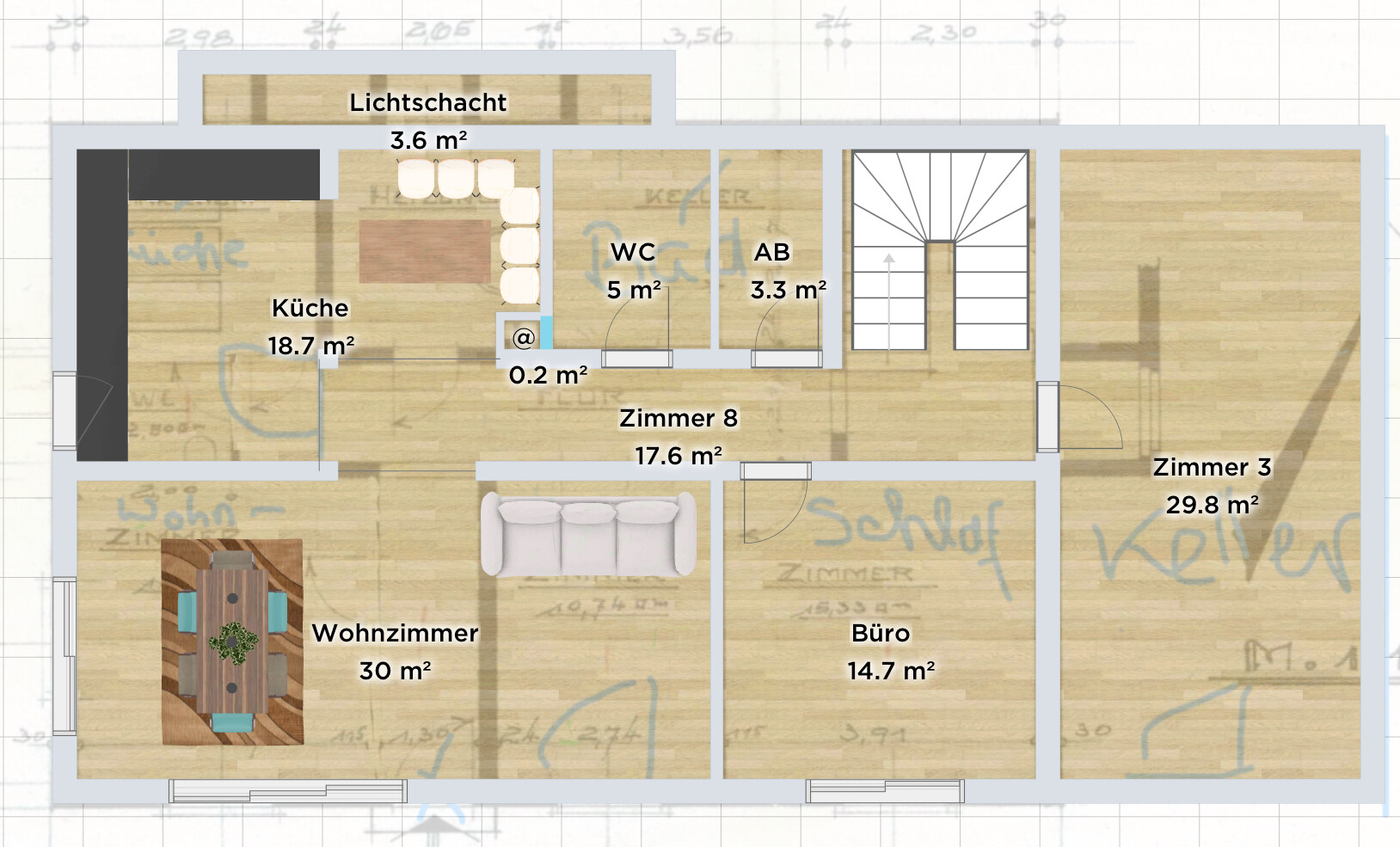

@ypg Thank you very much for your sketch.
I understood the plans for the ground floor. We really like the idea of the wardrobe and the staircase. Whether the existing staircase to the attic will work in detail still needs to be checked.
We didn’t quite understand the sketches of the basement. Did you try to transfer the ground floor layout to the basement? I’m not entirely sure which walls on the left would remain. Are you leaving the right room as a separate space? Maybe you could sketch the basement again more clearly so I can better understand your idea. Thanks.
We discussed the various options over the weekend. At the moment, we feel that converting the basement into a family-friendly kitchen and a large living room, as well as making the ground floor similar to the plans for the upper floor, would be quite complex. More walls would need to be removed or repositioned. But maybe we are still thinking in outdated patterns. If anyone has input regarding the redesign of the basement and ground floor, we’d be glad to hear it.

Traumhaus schrieb:
Whether using the existing staircase to the attic works in detail still needs to be checked.
? I thought you wanted a new staircase anyway..
Traumhaus schrieb:
Did you try to transfer the layout from the ground floor to the basement?
Not really. Here it is again, neatly marked with the load-bearing elements.
2D floor plan of a house with kitchen, living room, office, bedroom, bathroom, stairs and light well
In the end, what really matters is that you—and not us—feel comfortable. If you see more benefits in “your” version, then that’s fine.
However, I don’t understand your concerns about the granny flat. You don’t address them either. On one hand, it is meant to be rented out, then the tenant is supposed to be evicted if the grandparents need a guest room.
You also rightly argue about unwanted contact with the tenant, but the fact is, they will be parking on your driveway and, as mentioned before, can watch you in the garden.
Traumhaus schrieb:
that we can move between the ground floor and basement without encountering the tenant.
But with your plan, that is the case both on the driveway and in the backyard. And as others have already said and noted several times here: owning a garden is more than just having a place for the gas grill, as many apartment tenants think.
This idea of “I can do whatever I want with a tenant” or choosing an “invisible tenant who behaves the way I want” just doesn’t work.

Thank you very much for the new sketch. It helps me understand better.
We have not yet made a final decision about the staircase, whether a complete renovation would justify the costs from a cost-benefit perspective.
Regarding the granny flat: If we decide to include it, we plan to rent it out to others for 5-10 years and then reassess. Only then will we know for sure how many children we have, how often and how long our parents and other relatives visit, and whether we will need the additional space. We don’t mind encounters in the courtyard or views of the garden, as the neighbors can see it too. My main concern with the granny flat on the upper floor is whether it’s even possible to have internal stair access, since both living units must be separately accessible.
Even if it may not have come across so far, we both grew up in single-family homes and currently live in an apartment with a small garden. If I want a garden with complete privacy, I need an adequate hedge or, better yet, a secluded plot.
