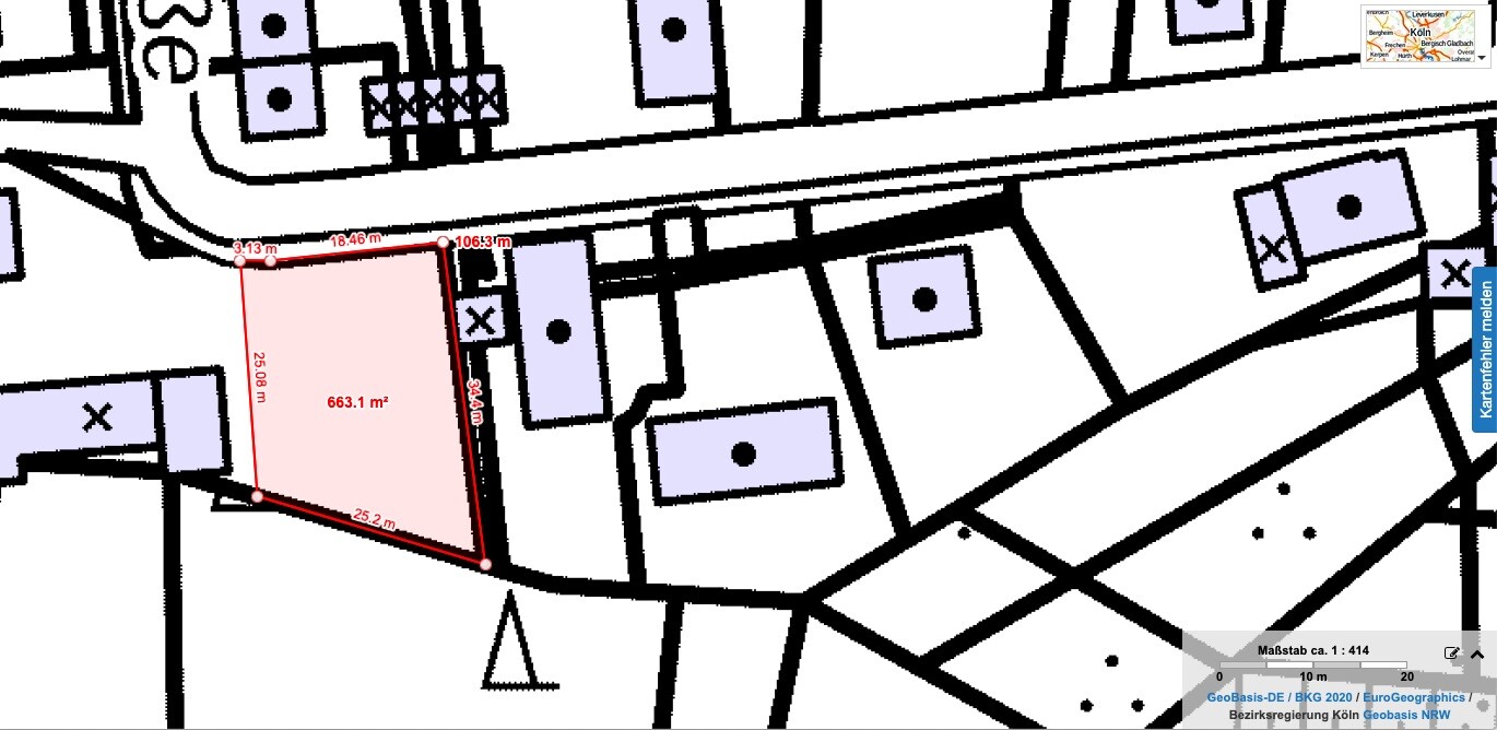

Plot size: 665 sqm (7151 sq ft), the plot is flat
Slope: Adjacent to the plot, a forested slope begins to the south
No development plan. Local customary building allows 3 full floors and any roof style.

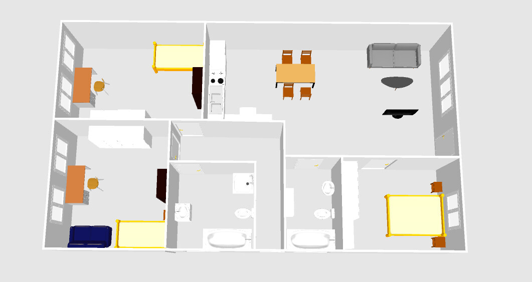

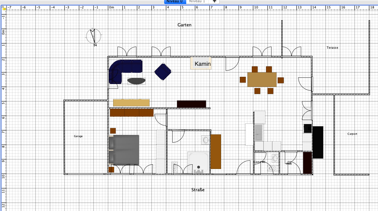

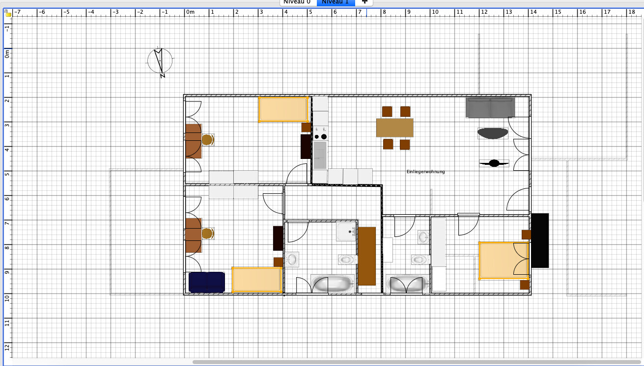

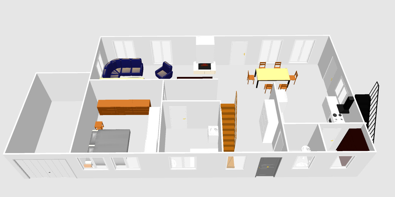

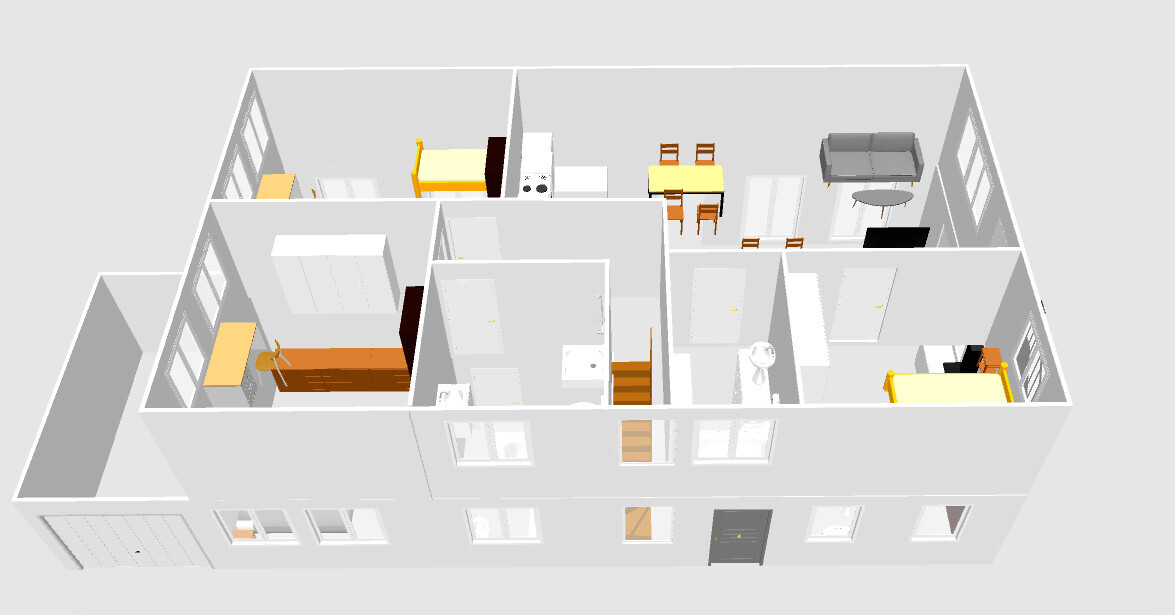

Matthew032 Apr 2020 15:19Please include the measurements, counting the squares is too time-consuming...
How many square meters should it be in the end? The budget will not be enough, it says 300,000 including equipment...?! What about additional costs?
Dimensions don’t work: living room too narrow, while space is wasted in the hallway axis. Staircase way too small and short.
Consider drainage planning (currently a topic elsewhere in the forum).
The utility room as shown is not usable as such. Even as a pantry, it gives you almost no additional space compared to simply integrating the cabinet marked in black into the kitchen layout.
Drop the granny flat (unless you have a strong reason other than rental income) and go for a standard single-story house with knee walls and a gable roof ("1.5" floors).
Otherwise... well... boring? Nothing appealing about it. It looks like an apartment block or multi-family building.
There are definitely plenty of floor plans in the standard offerings from general contractors that would suit you. You don’t seem to have any special requirements, so I would look there and at show homes to pick something “finished” (and functional!).
I’m always amazed at how much people plan their house not for the present, but for old age. There are stairlifts, so why does everything have to be on one level later on? I think that especially after living in your home for decades, you wouldn’t want to share that space with a stranger walking all over you.
Instead of building a second shift bedroom, I’d rather have a separate walk-in closet so you can continue sleeping peacefully. I also work shifts, so I know what I’m talking about.
The house does not fit the budget. Something needs to be adjusted.
Basement – raised basement
Does this mean that the ground floor has no level entrance and no access to the terrace?
What is the large basement needed for?
What is the purpose of the granny flat?
Remove the basement,
make the floor area smaller, the bedroom can be moved upstairs, there is a stair lift and so on.
Remove the granny flat.
