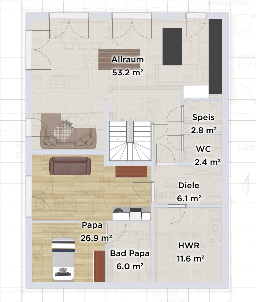

Attached are current ALKIS excerpt, aerial photo, and building plan excerpt, all oriented north and approximately the same section. I hope they are legible… Red borders and points mark the plot.

You’re paying a huge amount of money for this narrow living room—think carefully about it!
That’s exactly what I thought. In the new post, I forgot about the granny flat and wondered why anyone would build with a secondary suite if they have to restrict themselves like this. I’ve actually seen many apartments that offer more open living space.
… but then I read from the beginning and saw it includes the granny flat.
The secondary suite can do without a hallway. And I also find the section with the bedroom poorly designed.

BucheOnBoard
18 Oct 2023 22:57
I am definitely open to ideas, and the architect has never seen my drawings. However, we have communicated the layout with the granny flat facing east and our living area facing west (garden). Therefore, I would really appreciate a drawing from @ypg.
The recessed section allows for a reasonably high knee wall on the upper floor, which of course also creates more space in the attic.
The scenario where the father living in the house might no longer be there could happen sooner than you might expect, but I wouldn’t really plan for that—it could last until 65, but possibly not in very good condition.
And the TV would definitely not be there, @K a t j a; most likely, there wouldn’t be one at all.
I can’t give more ideas about the plan itself yet because I didn’t have time today (but I wished for a plan with more measurements to try sketching our furniture in).
One more thing that came to mind while working on it: the design is now 13.5m (44 feet) by 10m (33 feet) in size.

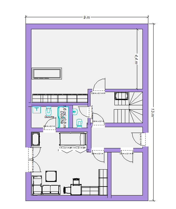

K a t j a18 Oct 2023 23:24
BucheOnBoard schrieb:
And there definitely wouldn’t be a TV for @K a t j a, probably none at all.
Yes, a dying breed. For us, it’s just a dust collector now.
A quick sketch of just the ground floor:
Floor plan of an apartment with purple walls, doors, stairs, and furniture.
The dimensions are 13 by 9 meters (43 by 30 feet), yet the living room has more space. The pantry had to go, and Dad can only have a regular small bathroom. If necessary, the dimensions mentioned in #44 can be used. The pantry is removed to create more living space – the kitchen is bigger as a result. A U-shaped staircase along the exterior wall should also provide decent rooms upstairs with a knee wall height of 1.30 m (4 ft 3 in), fully built over, sacrificing the roof peak.
I can provide the upper floor plan if needed.

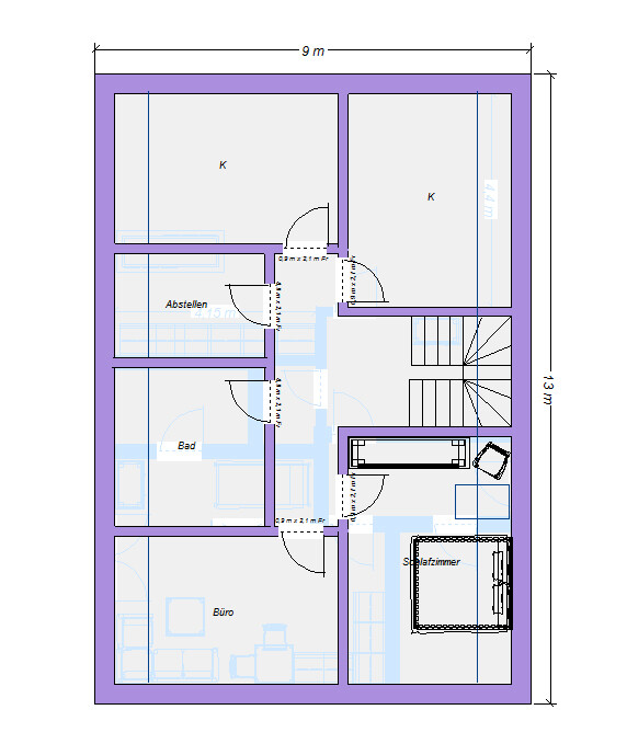

K a t j a18 Oct 2023 23:54
Just so it doesn’t fail because of that. Knee wall assumed to be 130 cm (51 inches):
Floor plan of a rectangular house: two large rooms (K), office, bathroom, storage room, bedroom.

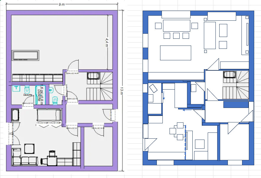

19 Oct 2023 00:06
Just a quick thought… though I’m wondering if the offset should be towards the garden. In that case, the staircase would need to be different.
Floor plan of a house with open-plan living area, dad’s room, dad’s bathroom, utility room, pantry, WC, hallway, staircase.
hanghaus2023
19 Oct 2023 14:25
I have slightly optimized the design by @K a t j a to gain an additional 0.5 m (1.6 ft).
Two floor plans of a house: left plan with purple walls, right plan with furniture.
