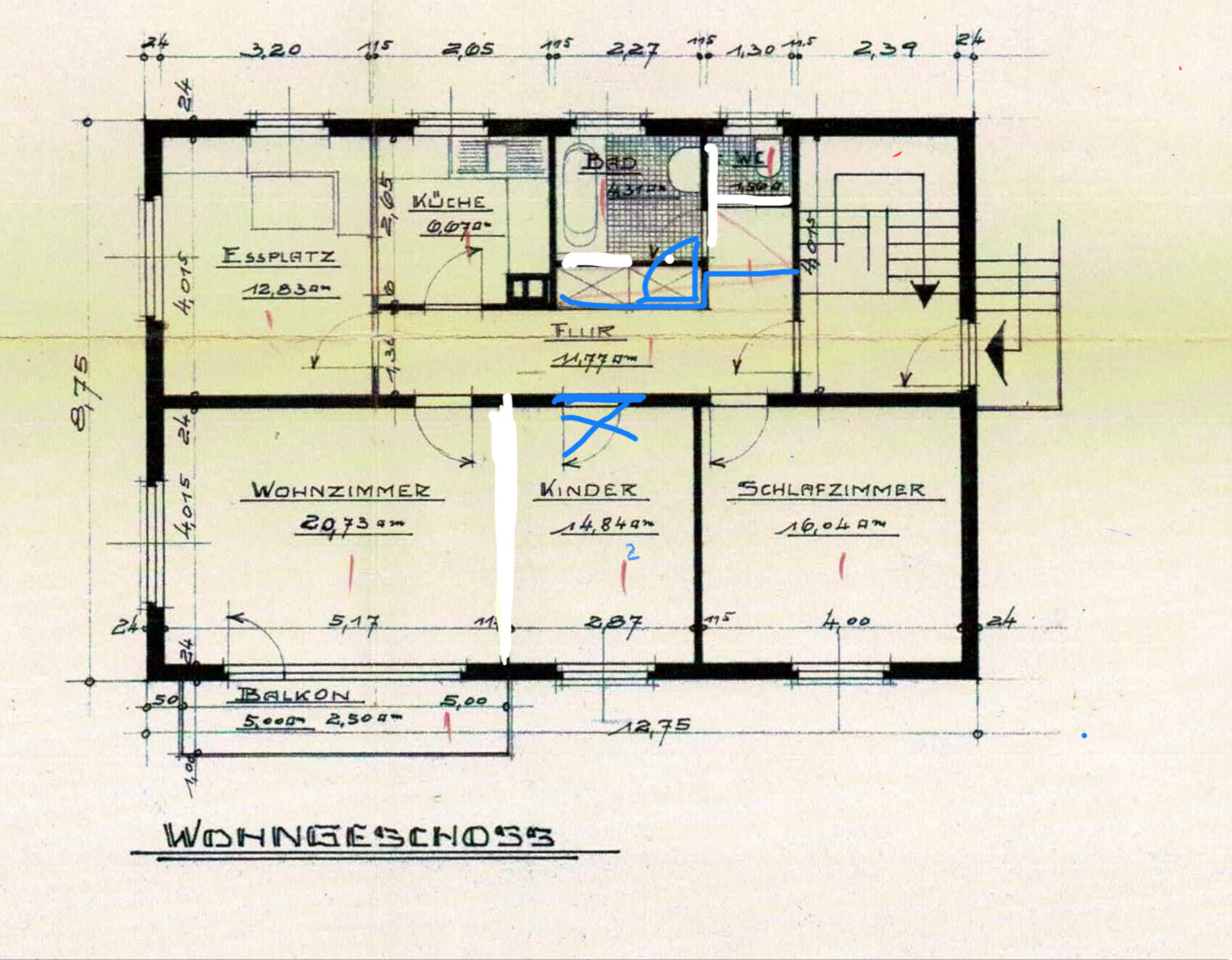

Sorry, but I really find it difficult to understand and process all the different aspects. Apparently, others are having the same problem. I can't even tell if information is missing or not.
The drawings are hardly clear to me either. Which one is the new plan, and which are the existing drawings?
Are the thin green lines supposed to represent walls or not? Where are the doors, and where are they supposed to be removed? If this plan is the new one, I don’t see any advantage compared to the existing layout. What is the objective?
Where is the basement, and what are the height differences to the garden that require a staircase? Where should the staircase go? Is it shown in the drawing? As I said, there are many unclear details.

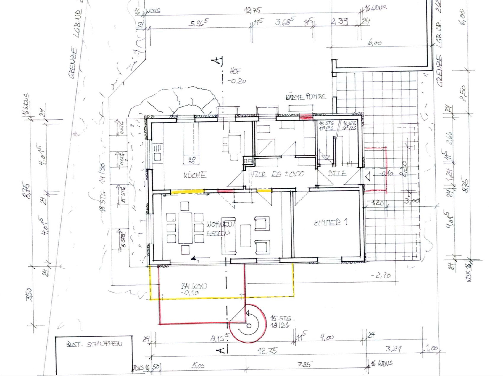

So..
there is an existing house, an old floor plan with green markings as well as red and blue labels.
Does the red question mark apply to us?
Then there is an architect’s design— is that new or is it an old one?
Then there is a rotated floor.
Certainly.. but first you need to know which design this is referring to.
For example, I don’t understand why there is a balcony on the ground floor at all. Then there is the design with a very long staircase drawn in. How high is the ground floor above the terrain?
Here too, I can’t see the reference: what is current, what is old?
Where is the basement shown here? Of course, if you read about a basement at some point, that explains a balcony, but honestly? There are so many question marks for the reader that you lose interest in continuing to read.
You put in a lot of effort, but with an existing building, you also have to communicate to the reader which is the existing design and which is the new one. Then I saw something above about a final decision, but I don’t actually see anything.
With existing buildings, it helps to approach the project systematically and to show the reader photos if possible, as they explain much and say more than a thousand words.
And honestly? If it’s just about making a bathroom smaller, then just do it.
Where are angled entrances? I only see two doors arranged diagonally in the hallway. That’s done when there are many rooms that need to be accessed. Is that what you mean? But that is not important here in the first place. As you see: questions upon questions.

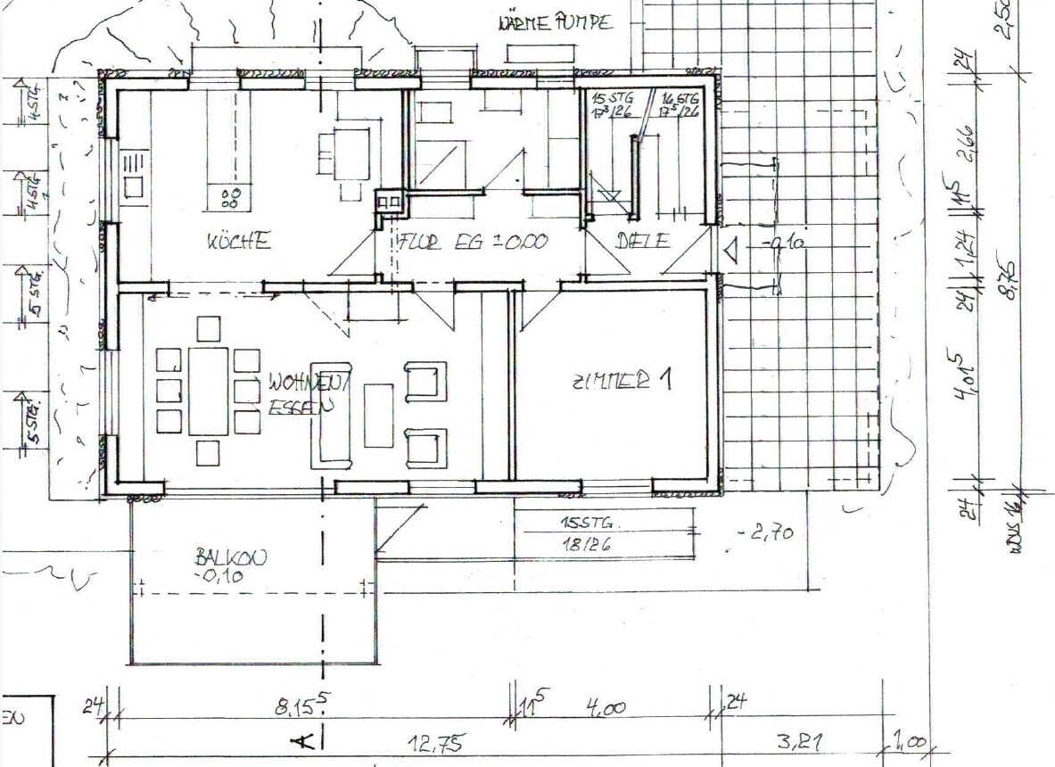

Traumhaus schrieb:
Any ideas?
Traumhaus schrieb:
Ground floor balcony: We want a staircase to the garden,
Traumhaus schrieb:
- Upper floor: basically being completely rebuilt,
Traumhaus schrieb:
Basement renovation

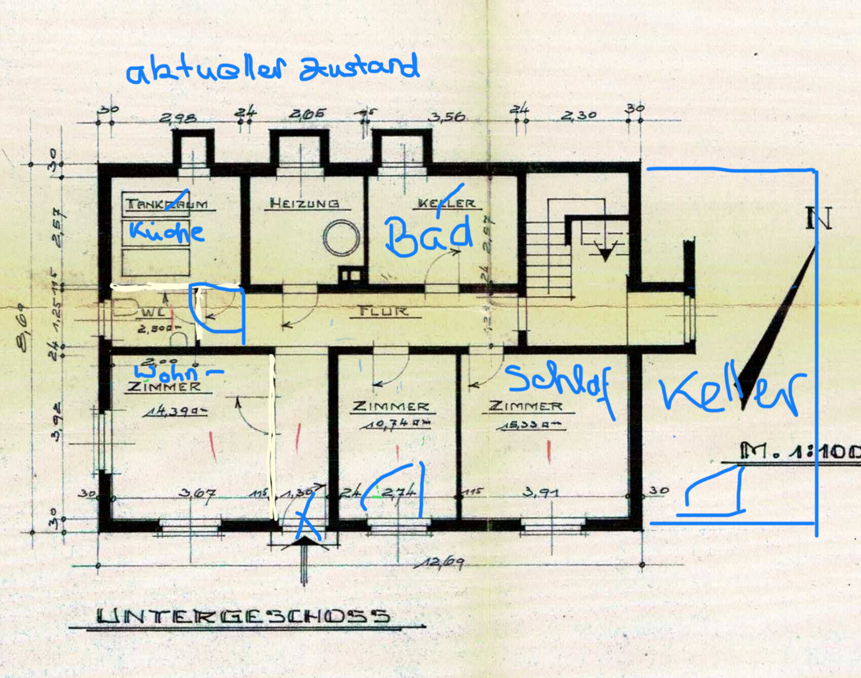

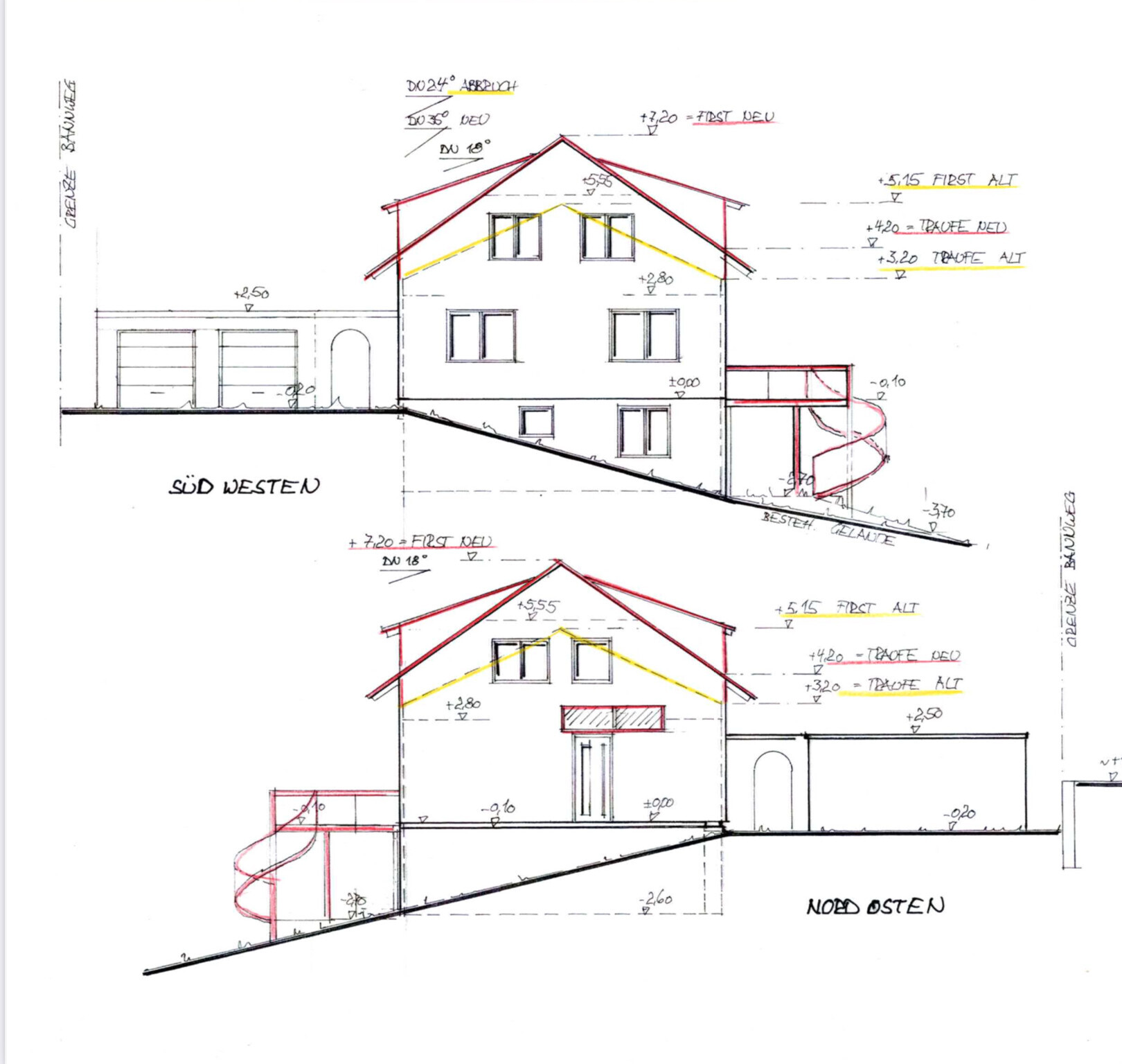

Traumhaus26 Mar 2025 21:30Thank you for your answers. Sorry for the unclear phrasing in my original question.
I will try to present our questions more clearly this time.
I have re-uploaded both the current and old plans with proper labels.
Unfortunately, we only have the floor plan from the original build year and the current plans.
I have marked the alterations made over the past decades on the old plans in blue and white. This reflects the current state of the house.
The new plans are the latest version for the building permit / planning permission application.
Besides general criticism, suggestions, or ideas regarding the current renovation plans, I would appreciate input on the following questions.
I will briefly go through each floor, mentioning what we like and what questions we still have.

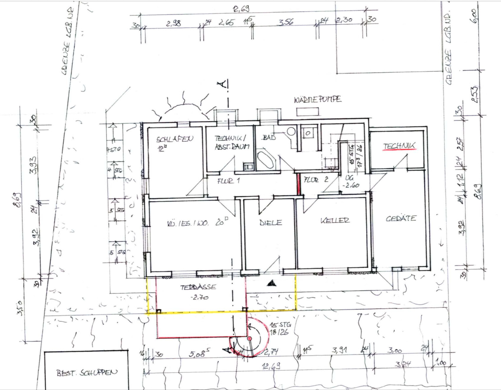

Ground floor:
We want to keep the living room and room 1 as they are. The doors in the living room are planned to be changed roughly as shown in the drawings. Our wish has been to convert the kitchen into a large open space. The connection between the kitchen and living room should be semi-open. Room 1 will be used as a study/guest room.
1) We want to reduce the size of the current bathroom to gain space for a cloakroom as well as to widen the hallway slightly.
Neither we nor our architect have come up with a good solution yet for a bathroom that includes a shower, toilet, washbasin, plus a cloakroom/storage room. He thinks it will be too narrow.
2) I find the hall behind the entrance door a bit narrow. We are considering whether we could gain some space by changing the half-landing stairs into quarter-turn stairs. Something definitely needs to be done with the stairs, but whether a complete rebuild is worth it is questionable. What do you think?
3) In the current plan, the balcony has a spiral staircase leading down to the garden. So far, we think this is the best idea. We really disliked the stair design in the original post. Are there better alternatives? Our architect has not suggested many ideas here. The balcony should be large enough to fit a small lounge area, a large dining area, and possibly a gas grill. It offers a nice view.

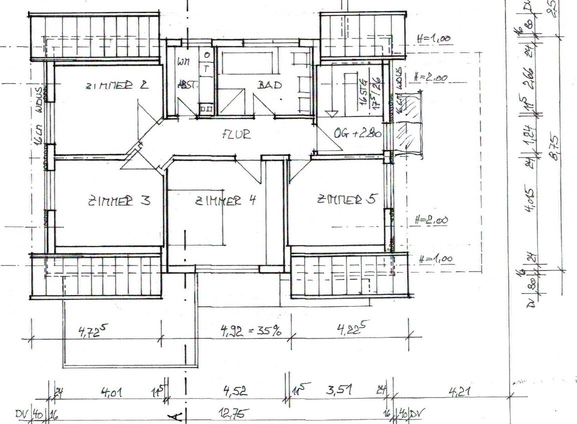

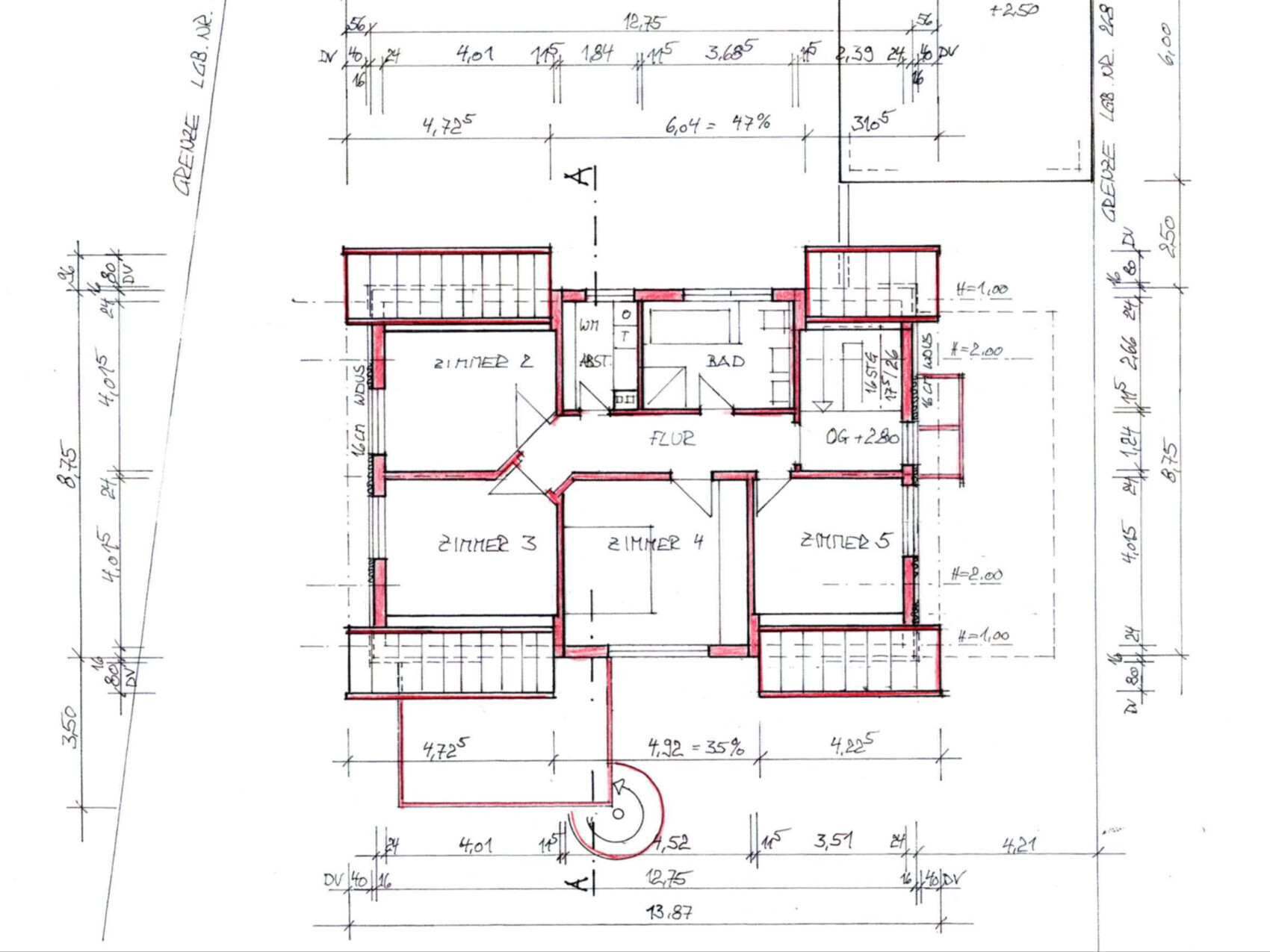

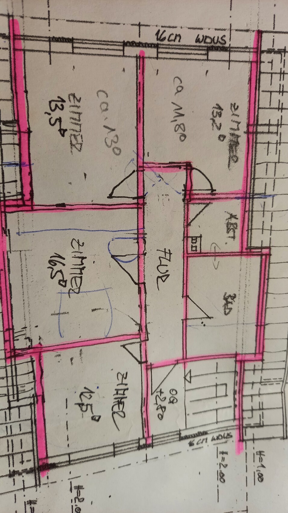

Upper floor:
Currently, this is an officially unfinished attic without knee walls. Everything will be new due to the extension.
We quite like the design. Better than a previously proposed version with three rooms and a dressing area.
We are still looking for the best solution for access to rooms 2 and 3 and are considering making room 4 a bit smaller so that room 5 can become bigger.
Ground floor:
Upper floor:
Which of those rooms will be our bedroom is still under internal discussion.
Regarding the bathroom, we are unsure if the size is sufficient for a family bathroom with a walk-in shower, bathtub, two washbasins, and a toilet.
Basement:
To allow renting out the granny flat, the utility room will be relocated to the basement extension. We want to do as little remodeling here as possible since this area was renovated most recently. It is important to us to keep the current bedroom as a basement room. Our architect excluded further changes from the building permit / planning permission documents to avoid too many alterations. Basically, the plan is to create a small rental flat.
If anyone wants to share their thoughts on this, that would be welcome. We have considered relocating the bathroom to the current boiler room in the long term and keeping the existing bathroom as additional basement space and possibly a third toilet with good access from the garden. Otherwise, having a separate sleeping area is most important to us.

The existing house is located on a sloped site. From the street, you enter the ground floor at level. The basement is at garden level.
If I forgot anything, please let me know. Thank you.
So, regarding the ground floor toilet: I think the architect’s layout is perfectly fine. I find having a separate room for it unusual. We also have a separate toilet room, but it’s only 1sqm (11 sq ft), so it’s basically just a cupboard.
Otherwise, you could partition off 2sqm (22 sq ft) here with the small window, using the left side for the shower toilet. It doesn’t have to be a bulky shower, maybe something rounded to make the space more appealing.
One person needs the rental income; the other is thinking practically. Personally, I’m not a big fan of deliberately enlarging a house solely for renting.
Besides, this involves major work including building a cellar extension, relocating the utility connections, and raising the roof.
And there’s the undeniable downside of having tenants in the house. They don’t just share the driveway; they also have contact points with the garden. In this case, even the entrance. You can’t build a wall in front of the windows either.
This comes with many disadvantages beyond the costs:
You won’t be walking down the spiral staircase to the pool in your underwear.
The tenant has a view into the garden, which isn’t ideal with children or a partner. You can feel watched. The tenant can basically spend the whole day outside your front door or at the window, watching you. There’s nothing you can do about it.
Personally, I’m also not a fan of a home where something—whether a balcony or stairs—separates me from the garden. A stairway remains a barrier. You can’t just quickly go into the garden while something is cooking on the stove. When you’re lying on the sun lounger or gardening, and the phone rings upstairs, it’s annoying to have to get up.
It becomes a completely different situation when children are involved: you bring a basket if child 1 or 2 wants to go outside, with snacks and juice… then you’re downstairs, the toddler needs the toilet… do you take the other child upstairs with you or just one?
@haydee can explain this better.
My advice:
skip the renter and avoid the complicated attic conversion. Finish the basement for your own use; move the kitchen and living room there, keep the sleeping area on the ground floor, and use the attic as a reserve for work and hobbies. Create a living space with a garden—outdoor life means more than just a gas grill—and privacy is more than just having a bedroom in the attic.
