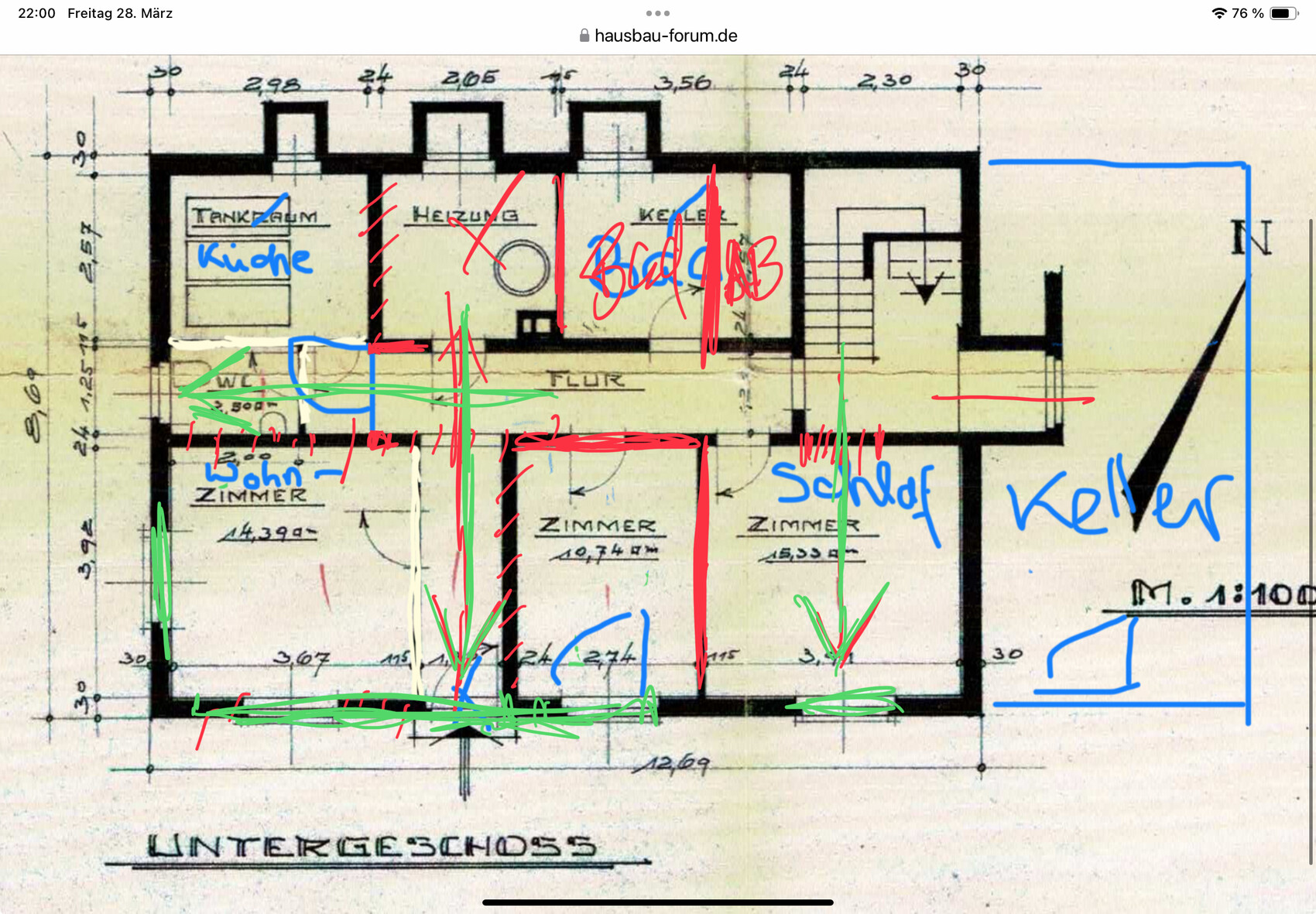

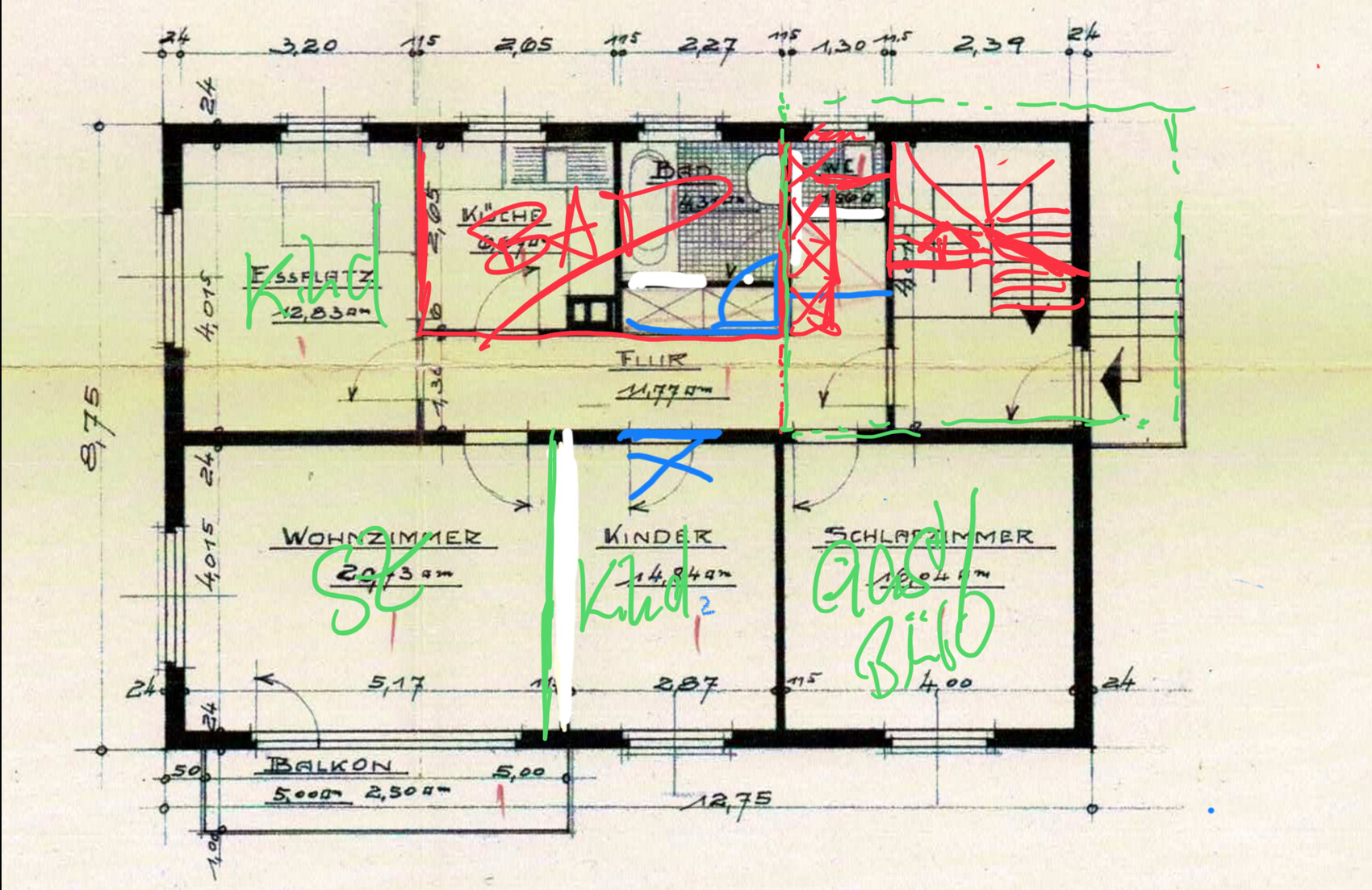

Traumhaus28 Mar 2025 21:38We have just revisited the option of moving the living or sleeping rooms to the basement. We want to use the weekend to gather ideas and see if this fits our space requirements and layout preferences. We don’t want to send the architect back to the drawing board only to find out later that it was all unnecessary.
During brainstorming, we ran into the many load-bearing walls again. If we move the living areas to the basement, we would like the option of a semi-open kitchen and living room facing the garden. The kitchen should include a dining nook for everyday use, and the living room should have a dining table, fireplace, piano, and a seating area. Connecting the fireplace to the existing chimney is possible, so the floor level shouldn’t matter. Whether there is room downstairs for an additional room next to the bathroom and possibly a storage room doesn’t matter to us for now. Do you have any ideas, or do we need a structural engineer for these considerations anyway?
On the ground floor, we could basically use the layout planned for the upper floor, with the problem that there would be no cloakroom area at all. We definitely need space for a cloakroom on the ground floor. It doesn't make sense to walk downstairs in dirty shoes and jackets. Are there any practical ideas? The bathroom currently planned on the ground floor seems a bit small to us for a family bathroom.
In the attic, at least the office would need to be located, possibly a guest room and the option for a third bathroom, in case we have three children and four rooms on the ground floor are not sufficient, and we eventually need to move the bedroom upstairs.
My husband is also interested in knowing what costs could be saved by not adding an additional floor. The roof would probably still need to be replaced because the rafters are too thin for solar panels. In this context, two dormers would be installed to create three functional rooms in the attic without adding another floor.
We would appreciate any input since we are quickly reverting to the old plans. A sensible conversion of the basement always seemed impossible to us. The main living level was always planned for the ground floor.

Traumhaus schrieb:
The floor plan of the upper floor could basically be used for the ground floor.I envision a very simple layout where the walls of the basement are carried over to the ground floor. In this way, I see four rooms on the ground floor plus a bathroom and a kitchen, which could be combined into a family bathroom. The cloakroom I previously suggested could then be opened up with the new staircase leading to the entrance area on the ground floor. A partition wall would be placed immediately behind the toilet to separate the private areas, so the bathroom remains private with the bedrooms. The only exception would be the 16sqm (172 sq ft) room, which would then be connected to the stairwell—but the stairwell is not meant to appear as a stairwell anymore, rather integrated and designed as a living space for all users.
Here are a few rough sketches: arrows indicate sight lines; otherwise, just some scribbles—I hope it’s understandable.
