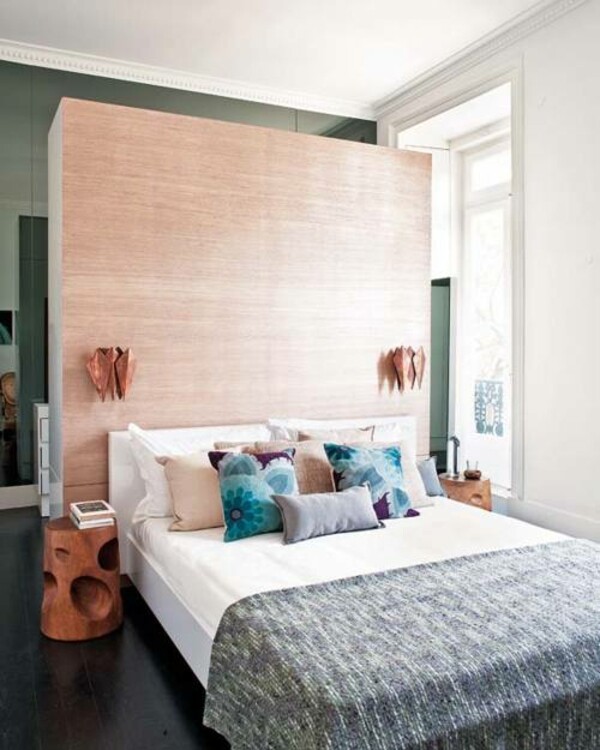

I find the concept of going from the hallway into the dressing room and then into the bedroom quite nice. We once saw this in a show home, where the bed was placed in the middle of the room against a drywall partition, and behind that wall were wardrobes—one along the drywall and another along the room wall. I thought that looked really good. In a dressing room, you usually have so much space that it never appears untidy.
Edit:
Something like this, for example:

DaGoodness23 Apr 2015 09:09We have now decided against having the walk-in closet. So, the two roof windows will be removed, and instead, like in the children's rooms, a large window will be installed on the side.
