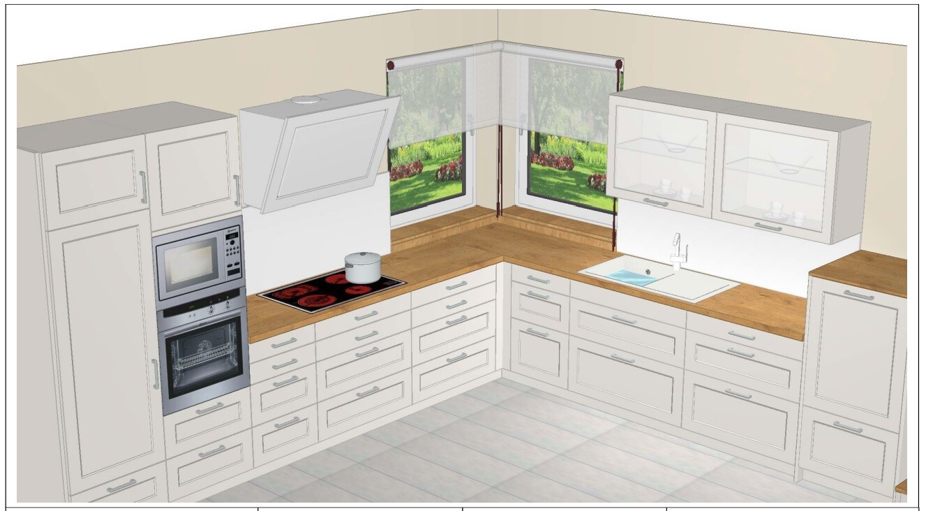

3cm (1.2 inches) too high, and a higher kitchen is not an option. The planned countertop height was 92cm (36 inches), the next possible step would be 6cm (2.4 inches) higher, and for me at 1.60m (5 feet 3 inches), that is way too tall... Not sure what to do. Waiting for a suggestion from the kitchen specialist... But I’m really disappointed... Everything had been going so well until now...
Couldn’t the countertop in the window reveal be made “thinner” from underneath? Do you know what I mean?
A simple solution would be to use niche material, which isn’t that thick, in the window reveal. That would create a seam, although seams in laminate countertops are usually quite invisible. The downside is that depending on the material, the grain or pattern might not continue seamlessly. That’s why I would first try to pursue the “thinning method.”

And why are baseboard height adjustments only possible in increments of 6cm (2.4 inches)?

Thanks kbt09 for your suggestions. I had something similar in mind, but it’s not feasible. My husband didn’t explain it quite correctly yesterday. I spoke with the kitchen specialist today, and the issue is that the current sill height is just under 93 cm (36.6 inches). However, we have a total height of 91.8 cm (36.1 inches) including the countertop. This means that once the kitchen is installed, the sill will still protrude above it.
This suggestion was made by the kitchen specialist... What do you think? Do you have any other ideas?
