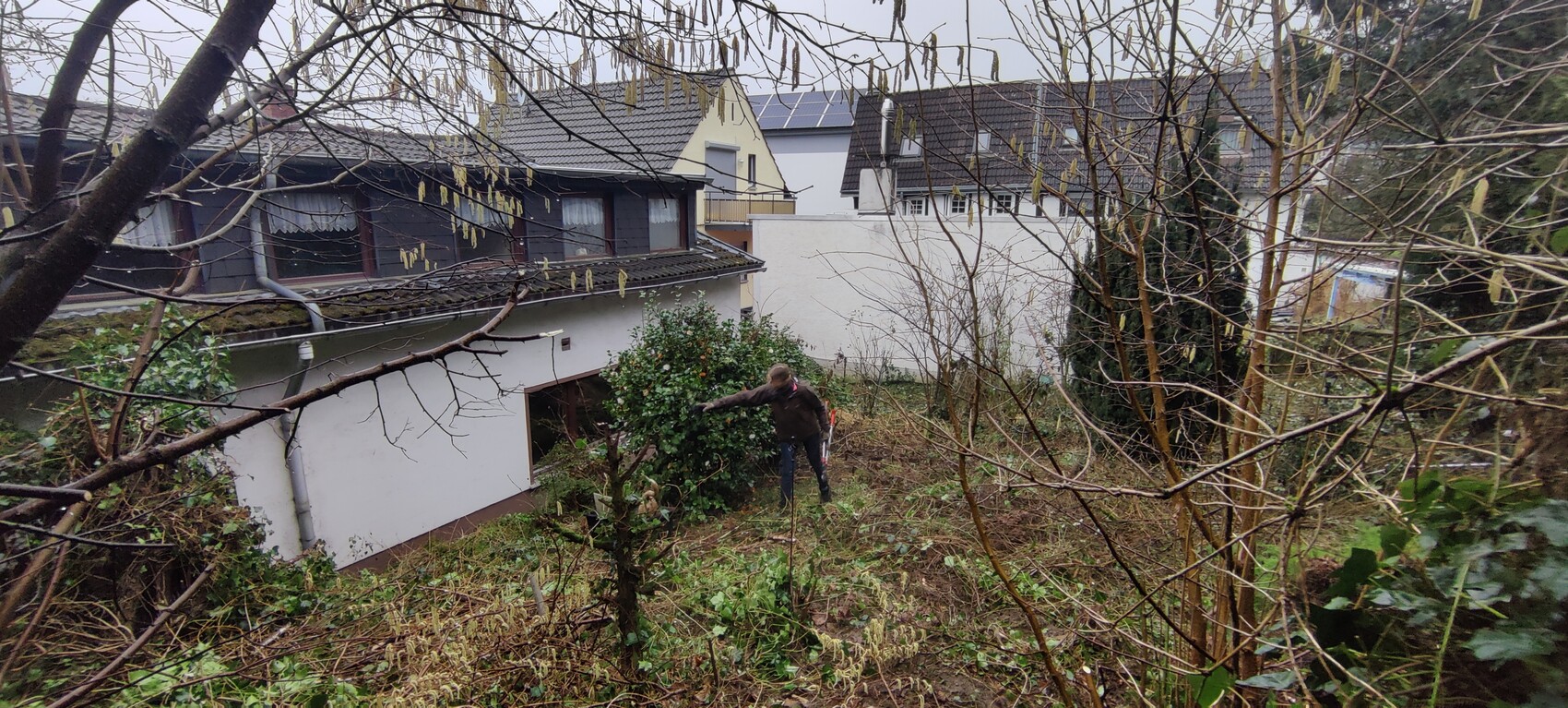

Plot size: buildable - 390 m² (4200 sq ft), with green space behind

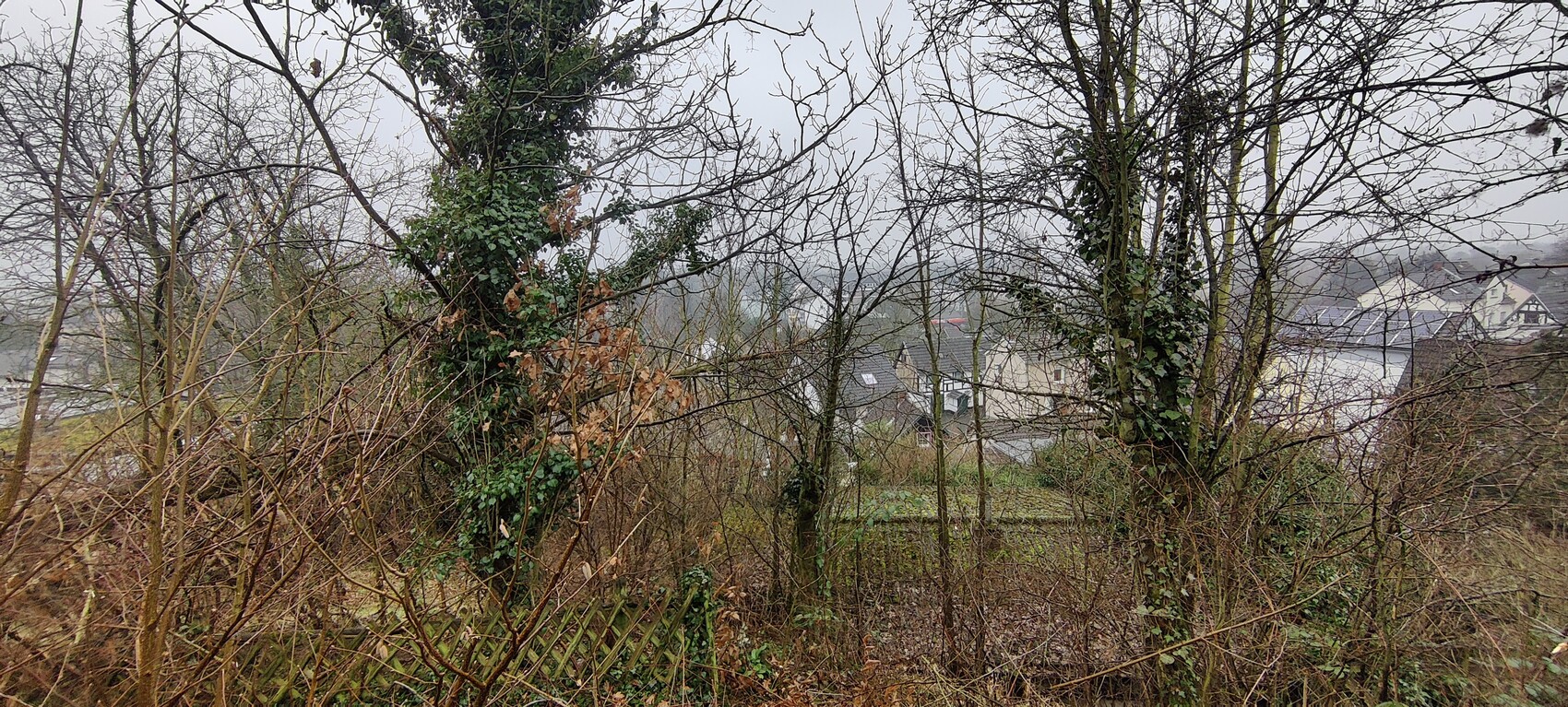

Slope: yes, ascending towards the rear, with an incline between 8 and 12 %, so the house will sit at the lower part of the slope. Unfortunately, the view into the valley can only be enjoyed from the upper floor due to buildings on the opposite side of the street.

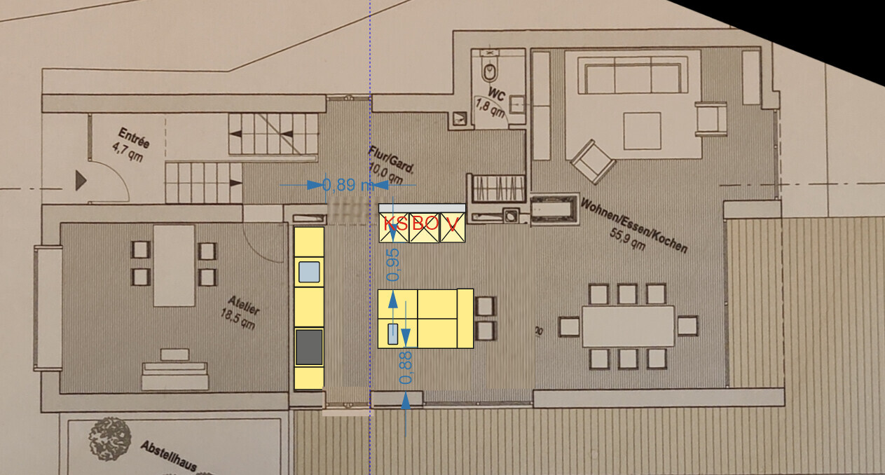

kbt09 schrieb:
I’m not a fan of downdraft vents, I’m generally not in favor of any recesses in the island 😉
buttyhome schrieb:
Or maybe a door? A sliding door? Sliding doors are also usually unnecessary. It really depends on your personal preference—whether you want privacy in the kitchen or how you use the hallway. Each household has different ways of organizing and managing space.
The kitchen could also look like this
The work island rotated, possibly just with a small sink.
Otherwise, on the left side, a work row with the cooktop and sink, and the tall cabinets along the top wall, including refrigerator, oven cabinet, and an additional 45cm (18 inches) pantry cabinet with pull-out shelves.
Wood-burning stove rotated.
Window at the bottom wall roughly opposite the hallway window.
buttyhome25 Jun 2025 21:15That’s a great idea! Both the space in the hallway and the rotated island are interesting. However, I find it unusual that you definitely have to pass visually through the kitchen to get to the living room...

buttyhome7 Dec 2025 19:27Almost half a year later, we can finally move forward with the building permit / planning permission application. We had extensive discussions with the heritage office and reviewed many plans. In the end, we were able to design the building volume accordingly, but the roof had to be somewhat steeper, and the windows smaller to protect the ensemble. Unfortunately, the staircase with the landing in the middle didn’t work out, so it has now been moved lengthwise into the hallway with a long flight.
The balconies have largely remained. The facade is now made of wood only in one area, also at the request of the heritage office.
Could you please do me the favor of giving your critical feedback on the floor plans once again? What have we overlooked? Which areas are too small, and where are we wasting space? I am uncertain about whether to equip the passageway between the hallway and kitchen with cabinets or leave a narrow wall. This would reduce the length of the kitchen and island by 40cm (15.7 inches), but gain us the cabinet space. What would you do? I would like to have a small storage closet in the hallway, but I can manage without it if necessary.
