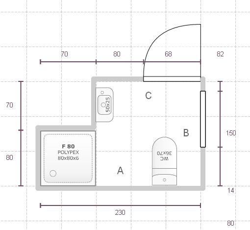

Here is the draft of the guest bathroom:
@Dirk: Something like this? It’s really tiny, isn’t it? Would that work, or will I get in trouble when my dad visits us with his beer belly : )

Doc.Schnaggls3 Sep 2014 16:13Hello Heiko,
yes, that looks quite neat. The shower tray you have planned now is an 80 x 80 cm (31 x 31 inches) unit. That is a very standard size.
Our shower tray in the apartment with 90 x 90 cm (35 x 35 inches) was still considered a luxury size 14 years ago...
Now, in the house, there is a shower in the guest bathroom measuring 80 x 90 cm (31 x 35 inches) – I think that should definitely be sufficient.
The toilet you have planned is quite deep at 70 cm (28 inches) – you could gain some space with a shorter (standard) toilet.
Get some information on what your final knee wall height and roof pitch will be – the usability of the attic floor really depends on that.

heiko6006 schrieb:
...toilet then on the upper left wall side and the shower bottom left. The two washbasins at the bottom, as planned? In a T-shaped layout? Is that currently common?That unfortunately doesn’t work at all, because you need a standing height of 2 meters (6.6 feet) for the toilet, shower, and washbasins.
The only current option that is visible and works is the one from @Manu1976: you recover the 2 m² (21.5 ft²) from the child’s room by moving the partition wall. This way you actually get two rooms of equal size 🙂
