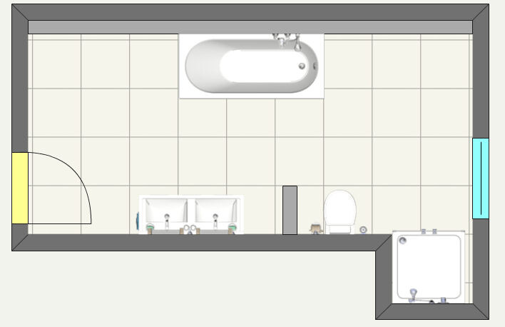

Doc.Schnaggls3 Sep 2014 15:05Hello Heiko,
I believe you will be able to manage with the bathroom planner.
Try searching on Google for "online bathroom planner." Quite high in the results, you will find a bathroom planner from Austria (.at).
I spent a long time working with it until our bathroom design was finalized, and I have also created a "draft" for your guest bathroom.
Enjoy "playing" with it...

The upstairs bathroom will really be a challenge. Are you working with a developer or planning it yourselves? Would it be possible to rotate the roof so that the sloped sides are at the front and back instead of on the sides? I find it a bit inconvenient with the current layout if the gable end is at the entrance.
I might have an idea for the bathroom, but it would reduce the size of Child 1’s room:
Straighten the wall of the children’s room and move the bathroom entrance to the side, behind the stairs. Then you could place the bathtub under the roof slope, put a shower in the niche where the bathroom door is now, install the sink on the wall next to the stairs, and place the toilet in front of the shower – the standing height should still be sufficient.
In the resulting niche between the bathroom and the child’s room, you could also create a small storage closet for toilet paper and cleaning supplies.

Doc.Schnaggls3 Sep 2014 15:33Manu's bathroom looks quite good.
However, due to the sloping ceiling, it might get a bit tight above the bathtub.
Therefore, in this design, I would prefer to install the bathtub as a "corner installation" right next to the door or beside the window.
@Manu1976: The idea of rotating the roof is not bad, but it’s relatively difficult to implement in a semi-detached house.
