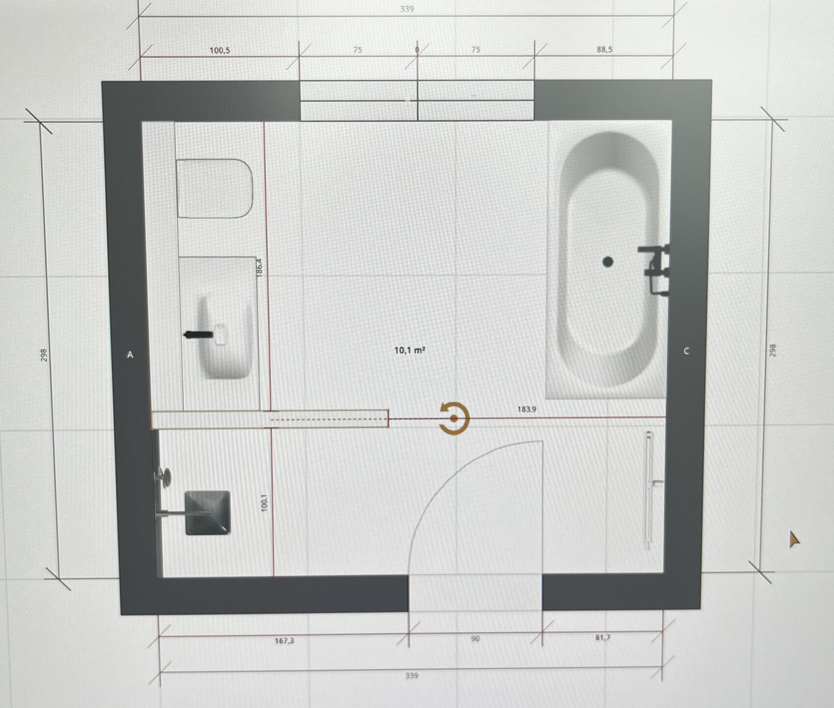

What do you think about the idea for the bathroom upstairs? The shower wall is marked as 1.5 m (5 feet) there. It’s probably not ideal near the door, but we would like to have an open shower without a door. The bathtub is located there in the
Grundriss eines Badezimmers: Badewanne rechts, Waschbecken links, Tür unten.
Also, we reconsidered the guest toilet because your comments regarding the layout and, consequently, the size are quite valid. Would it generally be possible to have the entrance to the office under the stairs (with the staircase turned back)? Would this work height-wise? That way, the guest toilet could be moved forward to create more space.

You also have a gap behind the door there, and the toilet and washbasin are really close together, meaning only a rather narrow washbasin is possible.
I find Yvonne’s @ypg approach from post 111 better.
