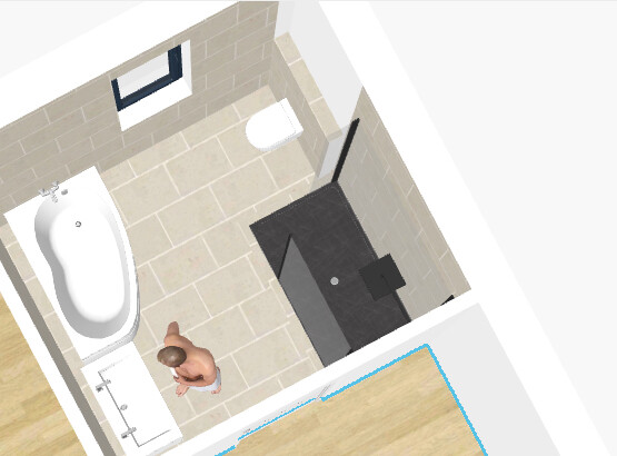

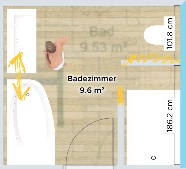

Calculate the bathtub width as 80 cm (31.5 inches) and the washbasin width as 50–55 cm (20–22 inches). That leaves 72–77 cm (28–30 inches) from the total 207 cm (81.5 inches). It will be getting tighter. And these are still rough construction measurements.
The wall for the shower can, for example, be built with a height of 210 to 220 cm (83–87 inches), so that during the day you don’t need additional lighting (this works well in my bathroom). And honestly, who needs full daylight while showering? If it is too dark or actually dark outside, I simply have a spotlight in the shower that I can switch on separately.

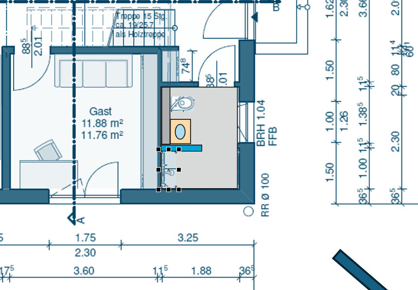

By the way, I would arrange the guest bathroom on the ground floor (250 cm × 188 cm / 98 × 74 inches) like this: a shower with a width of 90 cm (35.5 inches), a washbasin with a width of 60 cm (24 inches), leaving about 85 cm (33 inches) for the toilet.
kbt09 schrieb:
And these are still just the shell dimensions. I don’t need natural light when showering. It actually works fine without artificial lighting.
But we have already discussed the bathroom dimensions and made the OP aware of the issue. I still think the guest toilet is problematic. However, we don’t want to keep repeating the same discussion. If no agreement can be reached, or the OP doesn’t want to understand, is not open to it, or does not verify anything personally, then they have to take responsibility for that themselves.
As mentioned, we are still working on the guest bathroom. I really like the suggestion from @kbt09. Is the open part of the shower then closed off with a shower door as a splash guard? Or is that not necessary?
We will take the note about the clearances in the bathroom into the detailed planning phase.
Daylight in the shower is not really important to us. I also like the suggestion from @kbt09 regarding the slightly lower wall.

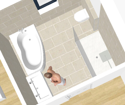

LeFy2023 schrieb:
Do you close the open part of the shower with a splash guard, like a shower door? Or is that not necessary? We have a shower curtain spanning the entire width without any partial wall because
- no one wants to constantly clean glass panels,
- the room feels more spacious with the curtain open,
- it is a guest bathroom/toilet,
- the curtain is washable,
- and it is a cost-effective solution.
LeFy2023 schrieb:
I also like @kbt09’s suggestion of having a slightly lower wall. In the past, people used to build a wall between the bathtub and shower. It was 2 meters (6 ft 7 in) high and worked perfectly as a child-safe shelf for shampoo and shower gel.
