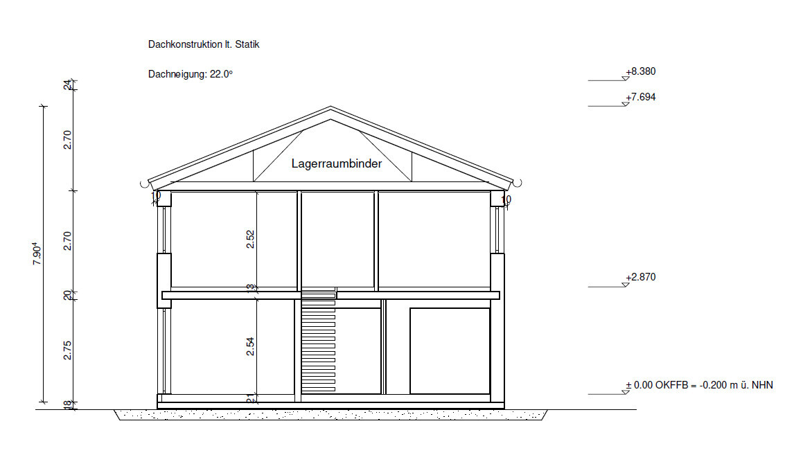

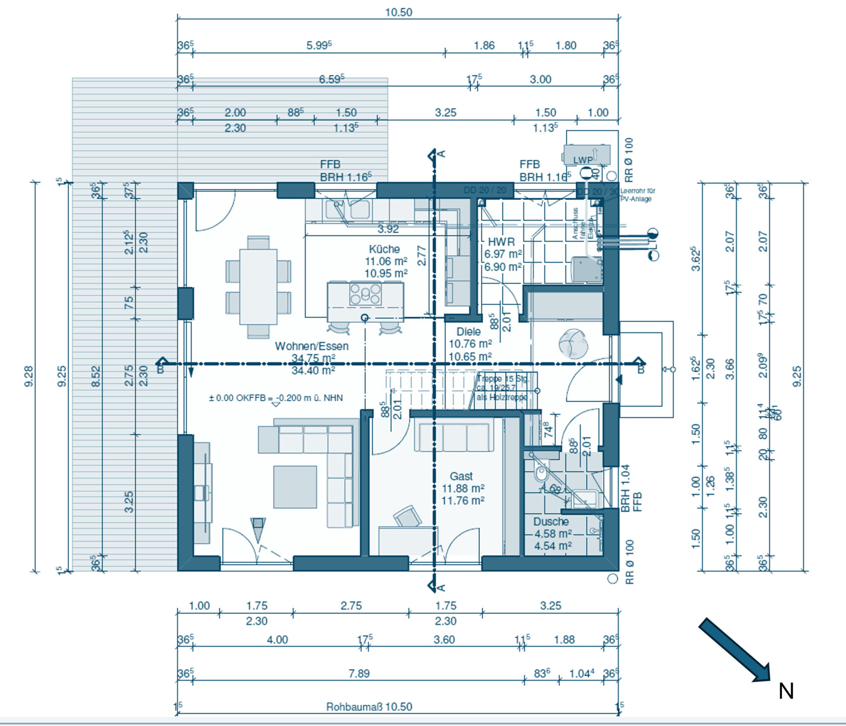

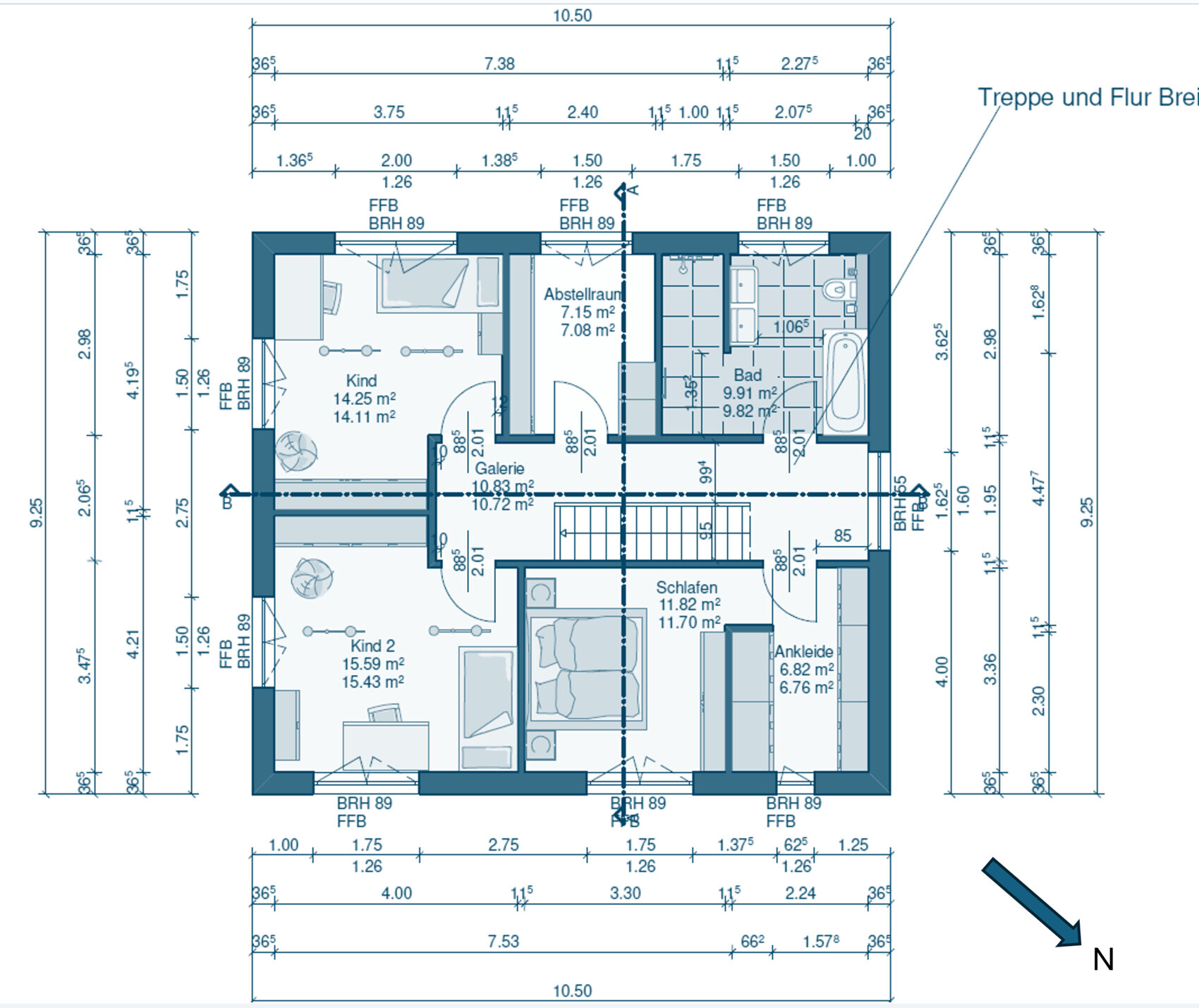

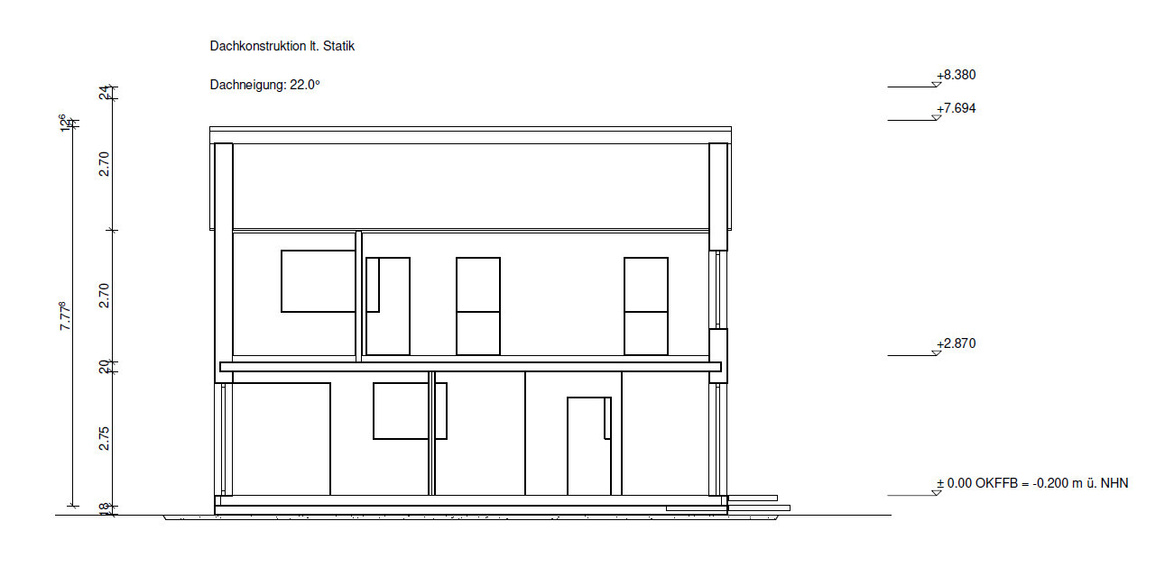

here is the current status of the preliminary planning. We are now taking this into the building permit / planning permission discussion with the construction company. The details (such as the guest toilet, final staircase length, etc.) will be clarified afterwards as part of the detailed planning phase.
There will also be some changes to the windows at the beginning of next week. I will then send the final version of the preliminary planning again.
Blue floor plan of a house with kitchen, living/dining, guest, hallway, bathroom; north arrow bottom right.
Floor plan upper floor: bedroom, 2 children’s rooms, storage room, gallery, bathroom, dressing room, staircase/hallway.
Cross-section of a two-story house with roof structure, staircase, and height dimensions.
Section through a multi-story residential building with interior rooms and 22° roof pitch.

I think it’s generally fine, especially the layout of the bathroom upstairs, which I like. However, be prepared to move the left wall adjacent to the utility room at least 20 to 30 cm (8 to 12 inches) further to the left.
Between the shower and the exterior wall, there are 207 cm (82 inches) of rough construction space, of which 100-105 cm (39 to 41 inches) should be used as a passage. That leaves only about 100 cm (39 inches) for the sink and bathtub combined, which does not work.
Plan for an 80 cm (31 inches) bathtub and a 50-55 cm (20 to 22 inches) washbasin.
motorradsilke
22 Jun 2024 16:09
kbt09 schrieb:
I think it’s generally okay, only for the upstairs bathroom (I like the layout), you should plan to move the left wall towards the utility room at least 20 to 30 cm (8 to 12 inches) further to the left.
There are 207 cm (82 inches) of rough construction space between the shower and the exterior wall, of which 100-105 cm (39 to 41 inches) should be the passageway. That leaves just over 100 cm (39 inches) total for the sink and bathtub, which won’t fit.
Plan on the bathtub being 80 cm (31 inches) and the vanity 50-55 cm (20 to 22 inches).
No, it’s actually 227 cm (89 inches) in the rough construction. Look, there’s still 20 cm (8 inches) left for the toilet extension.
Unfortunately, it will be quite dark in the shower then.
22 Jun 2024 23:51
I would leave out the short side wall in the walk-in closet. It’s not necessary and only restricts the space. You can decide on the guest bathroom later as a surprise. Otherwise, everything seems to fit quite well.
kbt09
23 Jun 2024 00:38
motorradsilke schrieb:
No, there are 227 cm (89 inches) in the shell construction. Look, there are another 20 cm (8 inches) for the extension in front of the toilet.
But 106 cm (42 inches) between the small washbasins and the tub, marked on a total length of 207 cm (81 inches)
motorradsilke
23 Jun 2024 07:42
kbt09 schrieb:
But 106cm (42 inches) between the mini-sinks and the tub is marked on a total length of 207cm (81.5 inches)
Yes, it definitely won’t be 106cm (42 inches), more like 80cm (31.5 inches) for the walkway. But that would be enough.
I wouldn’t like it—shower in a dark spot, pushed to the back, and a lot of space at the front left. But it doesn’t have to be, since it’s for the OP. It will work.
