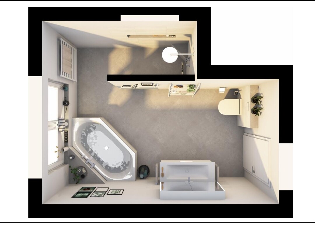

Really? Have you taken a close look at your bathroom? Having the toilet right behind the door is quite awkward in my opinion. The door actually swings the wrong way entirely. If you reverse it, the toilet placement gets even worse. So that’s a fail.
LisaO schrieb:
The windows are not symmetrical yet, the roof window is too small for us, and the access to Child 1’s room is not ideal.
Exactly! Offering something like that in a new build is a joke! Please don’t let anyone talk you into this, and NO! it’s not cozy, it’s just ridiculous.

I completely understand the criticism regarding the child’s room access. Since we were uncertain about the bathroom layout, we had it professionally planned and are actually quite satisfied. Do you think the toilet is poorly positioned in terms of appearance?
Top view of bathroom floor plan: bathtub, sink, toilet.
