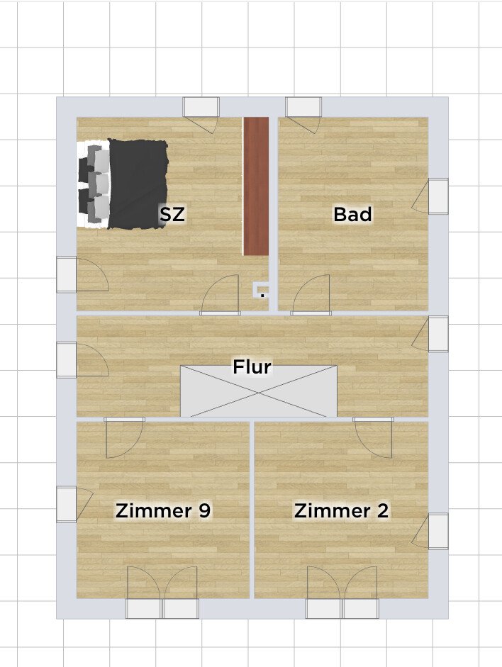

I am currently experimenting with this stair layout. Your drawing doesn’t work as well in such a minimalist way because you overlook the focus on the kitchen, wardrobe, etc. 😉

It’s somehow not working. Or maybe I’m just missing the obvious.
The cloakroom is smaller, the island has shrunk to 2 meters (6.5 feet), and the pantry is gone. To compensate, I enlarged the utility room (the shower had to be removed). Then the disaster: despite the spiral staircase, there’s no longer any space for an office upstairs 🙁

10 Mar 2023 22:21
And here is the crazy staircase captured by @K a t j a. (looks a bit distorted in my software)

11 Mar 2023 00:25
It somehow doesn’t work. Or I might have a mental block.
The cloakroom is smaller, the island has been reduced to 2 meters (6.5 feet), but then the pantry is missing. To compensate, I enlarged the utility room (the shower had to go). Then the disaster: despite the spiral staircase, there is no longer any space for the office on the upper floor 🙁
It would have been too good to be true! … Still, thank you very much for your efforts. It helps tremendously!
