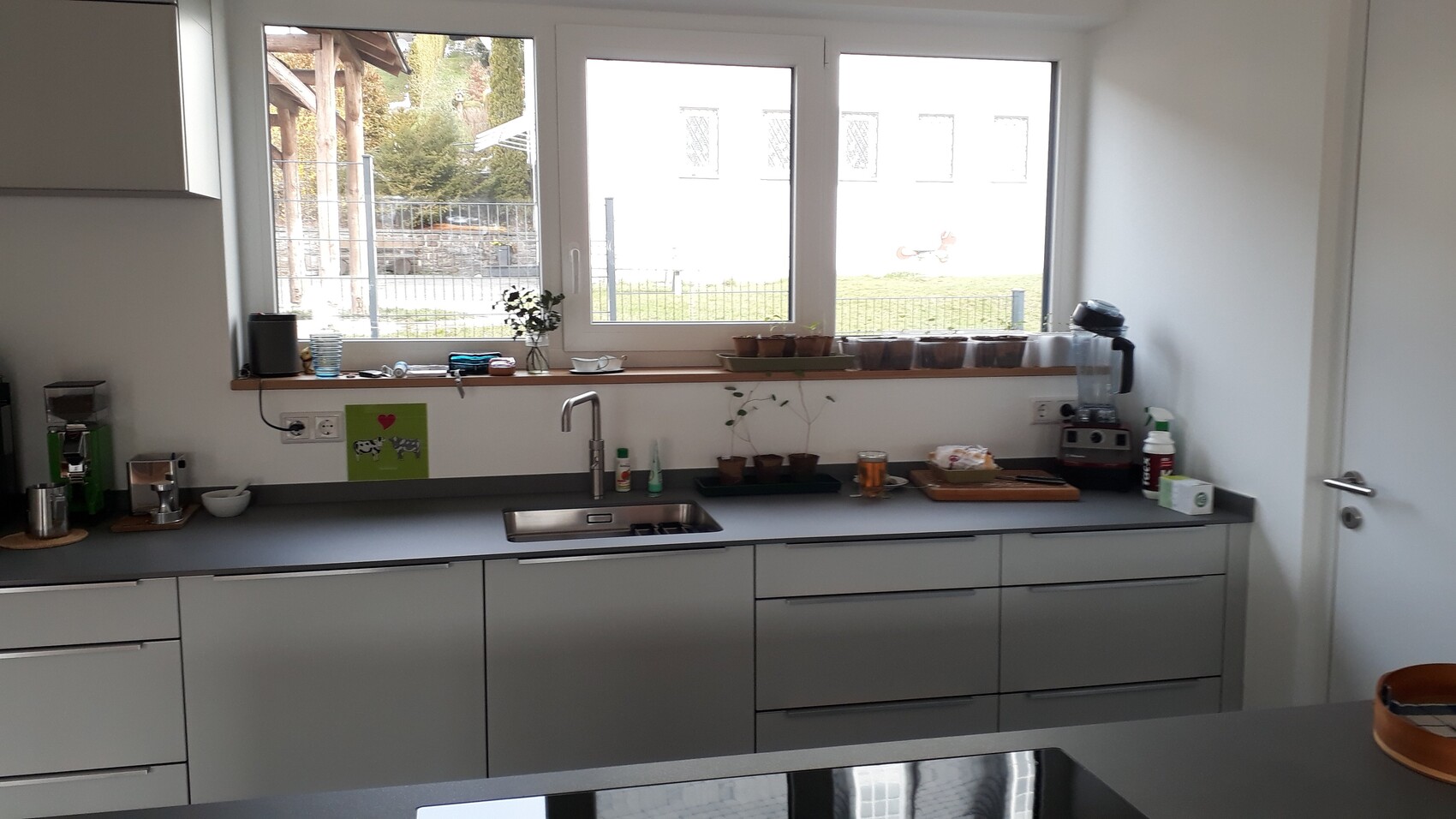

We are planning a long fixed window element above the kitchen countertop. The architect has designed a sill height of 1.35 m (4 ft 5 in). I am only 1.60 m (5 ft 3 in) tall. Somehow, I can’t really picture it well. I do like that the window doesn’t start directly at the countertop, but is this height common or practical?

You also have storage space even if the countertop does not extend into the recess, it’s just a bit higher:
However, a woman who is 160cm (5 ft 3 in) tall still needs to be able to reach it.
Toilet cisterns are generally not 135cm (53 inches) high. I believe the standard height is around 110cm (43 inches), and there are also extra slim models (about 85cm (33 inches)) that are operated from the top. So, no worries regarding symmetry either.
