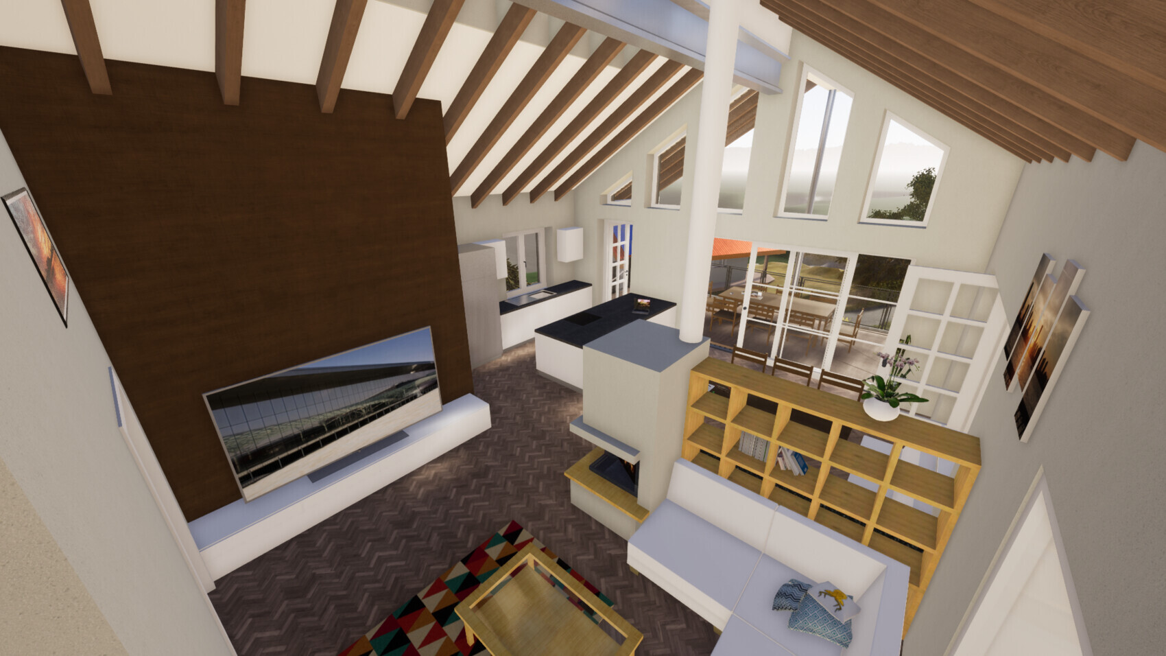

Advantages of the current layout are the 5m (16.4 ft) ceiling height upstairs and the better distant view.Wow. 5m (16.4 ft) ceiling height – is that desirable? That’s like in a church. Have you walked through it in 3D yet?So if the granny flat is for a family member and the distant view is that stunning, then I don’t think it’s bad as it is. I would make the roof pitch a bit shallower. It’s a pity there’s no window in the basement. Maybe you could add a light well? For example, for a gym or something similar.

Regarding ceiling height, I think it’s really a matter of personal preference. I like it as it is. The same goes for the roof pitch.

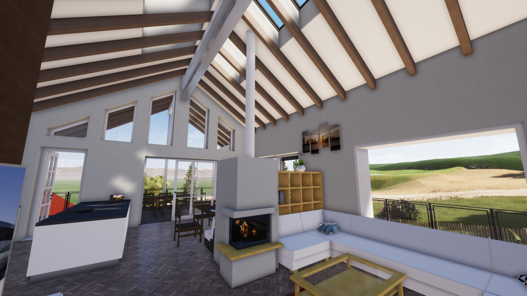

One thing I noticed, and I hope you haven't already mentioned this: a fireplace right next to the sofa. Is that really the plan?
A window seat behind the sofa. Why is the sill at 50cm (20 inches) instead of at the height of the sofa backrest? Then it wouldn’t be a window seat anymore, but as shown, it doesn’t really make sense.

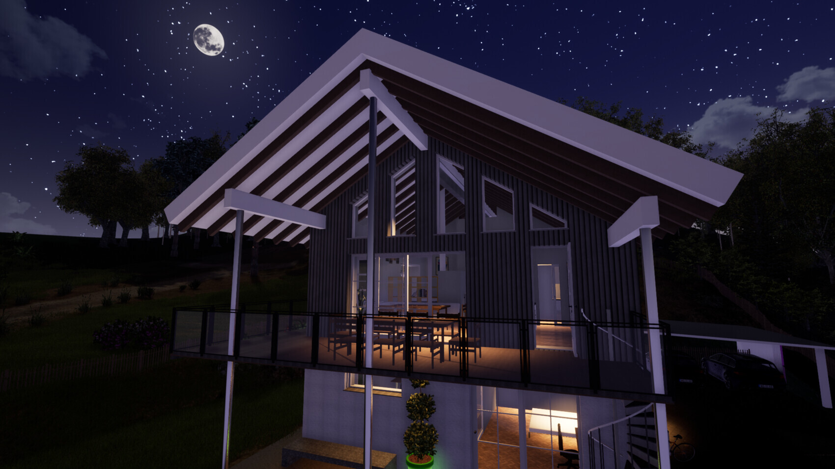

Ah, with the moon and stars – not bad either.
For me, 5 m (16 feet) would be too much. Too uncomfortable. You’d have to heat all of that. And before you bring up “climate change,” you’d probably have to cool it all as well. But okay, if it’s worth it.

Window seat behind the sofa. In this case, the window seat is on the outside, acting as a bench. Indoors, it would obviously need to be positioned higher.
