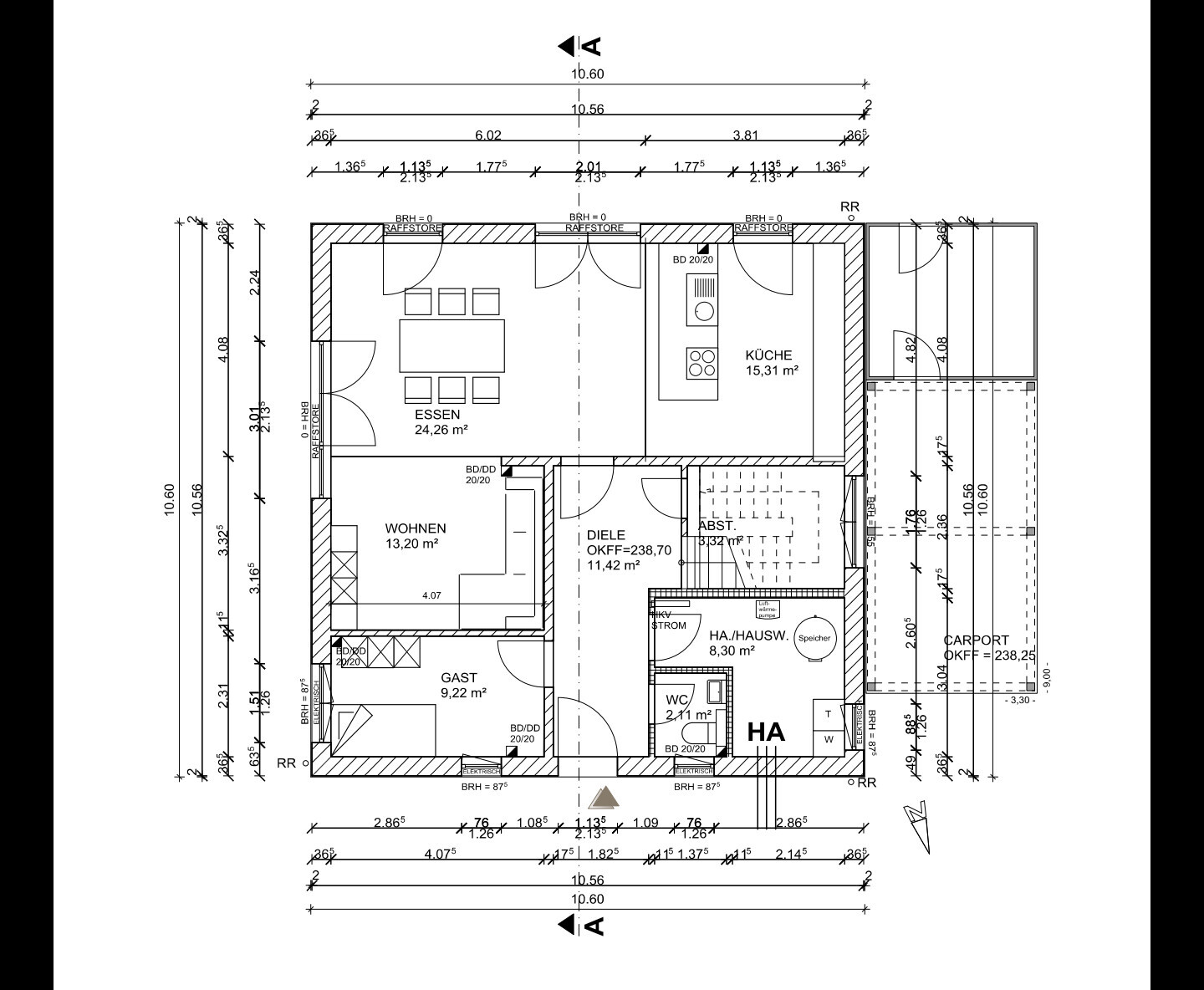

- Where could it still be optimized? Would you recommend different window dimensions or sill heights?
- What do you think is poor or what would you do differently?

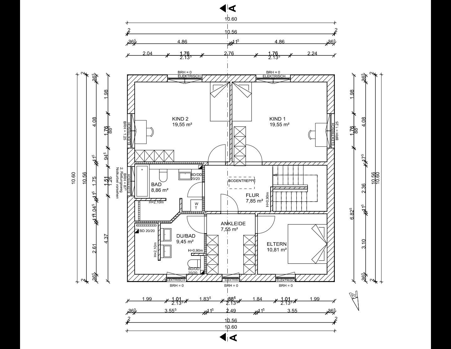

- A partition wall will be added in the walk-in closet. That would theoretically allow watching TV from the bed. I am considering a lightweight wall. I plan to place a 211cm (83 inches) Pax combination wardrobe in the closet. The closet is planned with a raw width of 218cm (86 inches). Do you think 218cm is enough for the Pax once the walls are plastered, or how wide should the rough dimensions preferably be?
- Is the hallway on the ground floor too narrow?
- Would you raise the ground level? The house would be 40cm (16 inches) below street level. If I build a terrace into the garden, it would be about 1m (3 ft) difference. You could raise only the house level, resulting in approximately 1.6m (5 ft) difference between terrace and garden. I don’t know anyone living below street level. Raising the garden would probably not be allowed without permits, and affected neighbors likely wouldn’t agree. On the sides of the house adjacent to neighbors, raising is permitted only up to certain limits. I am overwhelmed with the decision.
- Do you have any ideas for arranging the sofa differently and placing the TV sensibly? My husband doesn’t want the sofa back facing a window. I still need to get used to placing the sofa in the middle of the room.
- Is the kitchen size sufficient for a nice kitchen with an island?

So you mean the partition wall maze between the master and children's bathrooms? I had definitely already suggested using gypsum board for that. But my main recommendation was to return to a functional initial design, especially since the cost of the drywall complications for your floor plan tinkering was clearly high enough for you to ask for a remedy. When you revisit the design, you could also consider completely omitting the bathroom separation (even though it would be a pity, considering the proposals for the partition wall layout).
No, it’s not just about the partition walls, but all the walls. This includes the utility room and guest WC as well. They are currently being built with limestone sand blocks. Is this necessary for sound insulation?
Here are the current floor plans. The kitchen and living room haven’t been switched back yet.
The bathroom/toilet layouts have been slightly shifted/improved.
The ledge in the dressing room on the upper floor has been removed. Instead, there is now a ledge more centered in the guest room.
Do you think this is a problem?
I haven’t seen anything like this before, or maybe I just didn’t notice.
Would you accept it like this, or for example, hide it by moving the door towards the bottom of the plan and having it open against that wall (i.e., towards the window)?
