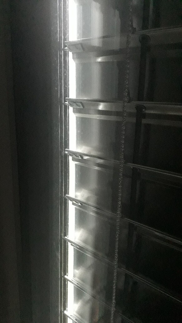

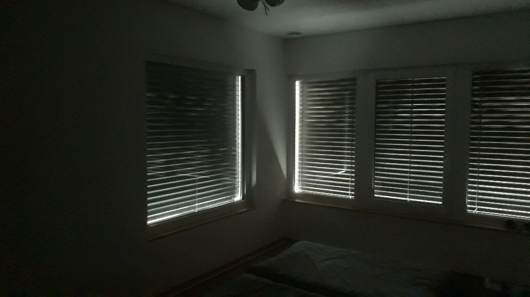

Light blocking is done exclusively with Roma CDL blinds, and at least we haven’t had any issues with them. They don’t make the room completely dark, of course, but provide more than enough darkness for undisturbed sleep. The following photo was taken yesterday afternoon (with sunlight outside), but it’s only somewhat representative since the camera increases exposure:
The CDL slats close completely flush with each other, and there are no holes for guide cords or similar. The only light comes in at the sides (between the track and the slat) and from below (we have natural aluminum window sills, which reflect light quite well). The horizontal “light stripes” you see are actually just reflections of the back edges of the slats. We have a lot of fixed glazing with relatively thin frames, and the bottom null position isn’t quite right yet (I think the blinds could be lowered about 2cm (0.8 inches) further). Whether it would get darker with real windows and a deeper null position, I don’t know, but I could imagine so.
We currently do not have wind sensors, and even in strong wind, I have not had any concerns about stability. We have experienced rattling blinds maybe three or four times in the ten months we’ve lived here. Interestingly, only in the bedroom... I suspect this is due to alternating suction and wind pressure caused by the corner of the house. We don’t have this issue in the living room, which also has very large window surfaces.
So much for the CDL advertisement 😉. Still: to achieve absolute quietness and complete darkness, roller shutters are probably the only solution. Therefore, roller shutters are likely the better option exclusively for bedrooms. For all other rooms (including children’s rooms), I would always choose blinds—and the CDL are truly a great choice there.

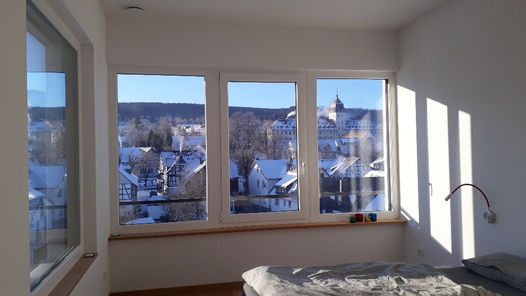

Our bedroom has large windows facing east and south, and we have no neighboring buildings or trees, nor do we use curtains or anything similar inside:
[ATTACH alt="20210212_090047_resized_1.jpg"]65539[/ATTACH]
Darkening is done exclusively with Roma CDL blinds, and at least for us, they work perfectly fine. It’s not completely dark, of course, but more than enough for undisturbed sleep. The following picture was taken yesterday afternoon (the sun was shining outside), but it is only somewhat indicative since the camera automatically adjusts the exposure:
[ATTACH alt="20210920_160326_resized.jpg"]65540[/ATTACH] [ATTACH width="111px" alt="20210920_160413_resized_1.jpg"]65541[/ATTACH]
The CDL slats close completely flush against each other, and there are no holes for guide cords or anything similar. The only light comes in at the sides (between the rail and the slat) and from below (we have natural aluminum window sills that reflect well). The horizontal "light strips" are actually just reflections on the edges of the slats. We have a lot of fixed glazing with relatively thin frames, and the lower zero position isn’t yet correct (I think the blinds could be lowered by about 2cm (1 inch) more). Whether it would be darker with true windows and a lower zero position, I don’t know, but I could imagine so.
We currently don’t have wind sensors, but even in strong wind, I haven’t had any concerns about stability. We’ve had rattling blinds maybe three or four times in the ten months we’ve lived here. Interestingly, only in the bedroom... I suspect this is due to alternating suction and wind pressure caused by the corner of the house. We don’t have this problem in the living room, which also has very large windows.
That’s the CDL promo done 😉. Still, it’s probably only with roller shutters that you’ll get total quietness and complete darkness. So roller shutters are probably the better option in a dedicated bedroom. In all other rooms (including children’s rooms), I would always recommend blinds – and the CDL ones are a really nice solution. I can only say that we have RAL 7016, and for us it is significantly darker. Only some light comes in from the sides, but it remains dark nonetheless.
