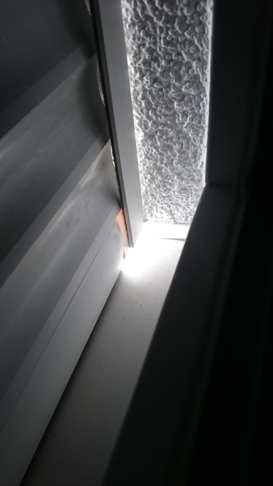

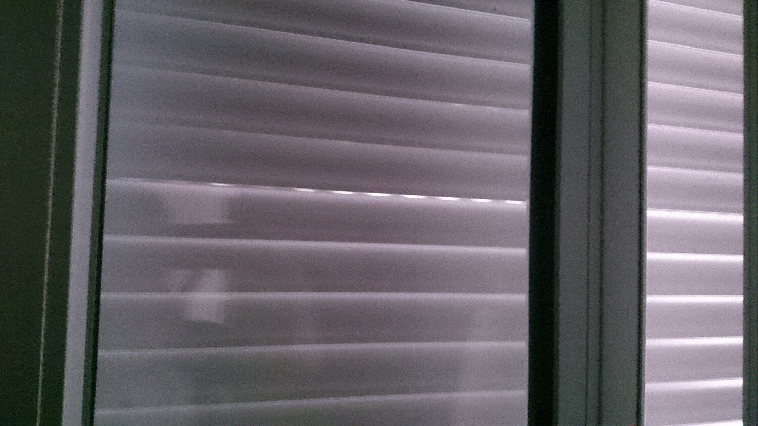

- In the bedroom and the children’s room, not all slats close properly. In the bedroom, it’s 3 slats, and in the children’s room, 2. Naturally, light comes through here.
- Additionally, I get a lot of light coming in (from 5 a.m. onward, because it’s the east side) because the side rails don’t extend all the way down to the windowsill, but stop about 3 cm (1.2 inches) before it!
So, on the right and left sides, light shines strongly through a gap of about 3x1 cm (1.2x0.4 inches).
The roller shutter installer says these side rails must not go all the way down to the windowsill because of rain. But 3 cm (1.2 inches) is quite a lot!
Of course, I don’t expect complete darkness, but something reasonable. However, with these large gaps on both sides plus the slats, it’s impossible to sleep from 5 a.m. in the summer...

Even if the guide rails do not extend all the way to the windowsill, the bottom of the window frame should still provide light protection.
The roller shutters should extend beyond the glass edge, that is, also over the approximately 10cm (4 inches) frame, so that no light can come through.
If light passes through the gaps between the slats, the roller shutters are not fully closed at the bottom. They should be, but in your case, it doesn’t sound like they are.
Please upload a photo of the lower part of a guide rail.

fraubauer27 Jun 2016 11:38ypg schrieb:
Even if the guide rails do not extend all the way to the window sill, the bottom of the window frame should still block out light.
The roller shutters should extend beyond the glass edge, so also beyond the approximately 10cm (5 inches) frame, to prevent any light from coming through.
If light passes through the gaps between the slats, it means the shutters are not fully closed at the bottom. They should be, but in your case, that does not seem to be the case.
Please upload a photo of the lower part of the guide rail.
Attached is the light penetration below the guide rail.
Regarding the slats: 2-3 lock together in the middle of the roller shutter! So the roller shutter does run all the way down!
F
fraubauer27 Jun 2016 11:45ypg schrieb:
Even if the guide rails don’t extend all the way to the window sill, the bottom of the window frame should still provide light protection.
The roller shutters should extend beyond the glass edge, meaning they should also cover the approximately 10cm (5 inches) frame, to prevent any light from coming through.
If light passes through the gaps between the slats, the shutters are not fully closed at the bottom. In your case, it doesn’t sound like they are.
Attached is a photo of the slat.
Did he cut something out there? For us, it’s also not a 100% seal because the roller shutters sit on a facing brick layer, but this is quite unusual.
I might consider attaching a "rubber lip" there that would seal the gap and, if necessary, give way slightly (in case it closes unevenly again).
