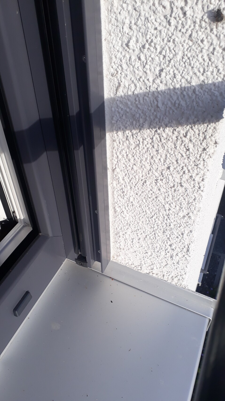

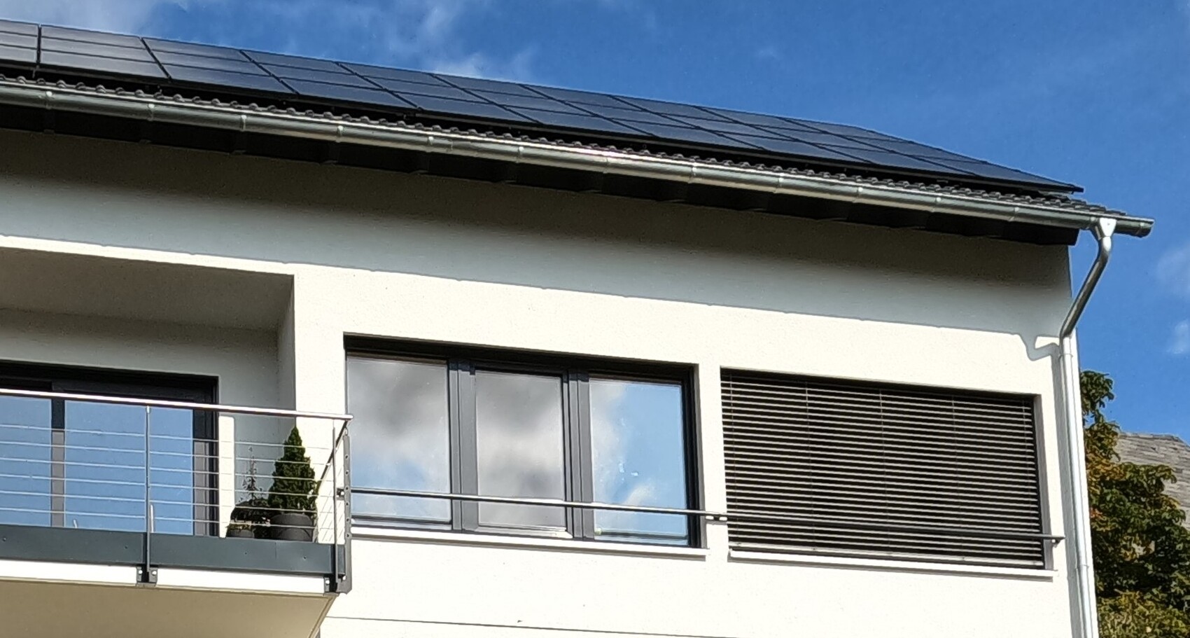

@Nixwill I took some photos for you:
Window frames and guide rails in RAL7015 (Slate Gray), window sill in naturally anodized aluminum, external blinds (venetian blinds) in gray aluminum. The photo shows the gray aluminum more clearly than it appears in reality: from the inside you barely notice it because it disappears in direct and diffuse light, and from the outside you only see it if the blinds are fully closed (so at night, which usually isn’t relevant 🙂 ).
My concern regarding heat buildup is less about heating the interior space (which likely isn’t a problem) and more about the material expanding and potentially warping. This is probably not an issue with the external blinds, but definitely a concern with the window sills. Also, powder coating in color is more complex, more expensive, and more prone to scratching than anodized aluminum. Additionally, older powder-coated metals often show a faded, dull appearance after years of UV exposure. I don’t know if this is still an issue with newer or improved processes—I just chose to play it safe.
