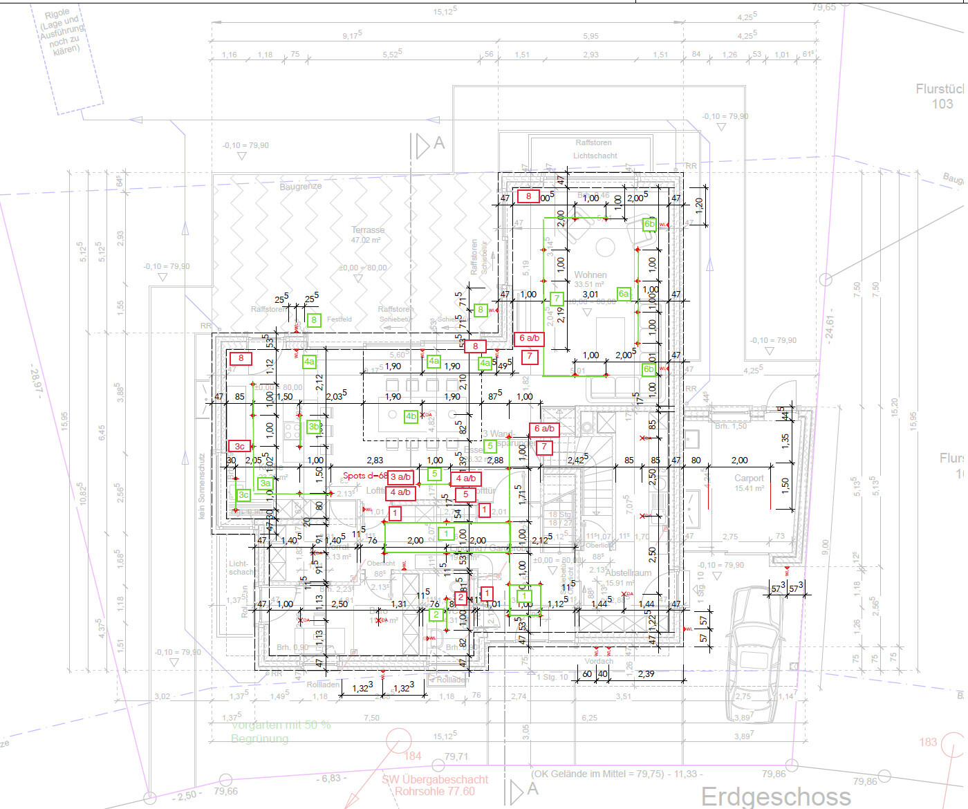

we are currently working on the lighting design and smart home setup for our single-family house.
Lighting Design
We have a large kitchen, living, and dining area that should be illuminated according to its different uses.
The first step involves planning spotlights to be installed in the thin concrete ceiling.
The main planning comes from our lighting designer, but we would also like to get some feedback from the forum.
The lights should not all be on at the same time but controlled in several switching groups – turned on, off, or dimmed depending on the usage.
In the attached document, the planned spotlights are marked with red circles, the wiring is shown with green lines and boxes numbered, and the switches are indicated by red boxes with numbers.
The stair lighting is not yet planned; according to our lighting designer, this will be planned and decided during the shell construction phase.
What do you think about the plan? Does it fit the floor plan? Are there perhaps too many spotlights? Where could floor and table lamps be placed?

Fliederhaus2518 Feb 2024 18:04kbt09 schrieb:
I immediately noticed the countertop in the kitchen directly above 3 c... how is it going to be illuminated? Good point! Wall cabinets will be installed here. Underneath them, lights will be fitted to illuminate the countertop.

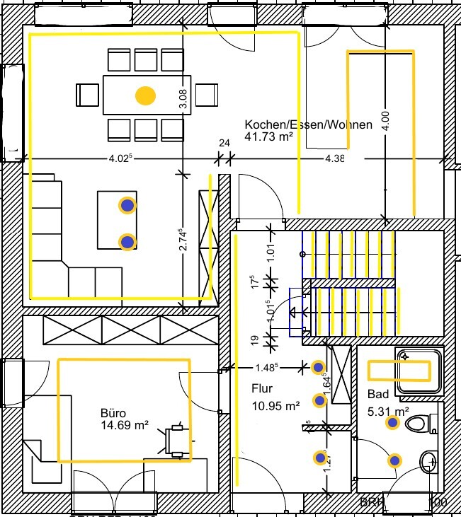

Numrollen24 Feb 2024 09:47Hello,
I have a similar unresolved issue. KNX is fixed. I have 5x 1.5mm² (5x 1.5mm²) cables in the ceiling (more in the living room) and it’s unclear whether DALI is necessary. It also involves higher costs, more complexity in case of faults, and requires a gateway.
However, my main concern is the lighting itself. I am a big fan of dimming, including time-dependent control. I don’t like lights that glare, so spots aren’t ideal for me. I would prefer to use a lot of LED light strips. Does that make sense, or am I missing something? Power consumption would be a concern.
And is DALI simply a MUST here, or can I still use a KNX dimmer?
In the picture, the yellow lines represent LED strips. Along the wall they are indirect, and in the kitchen area and bathroom they are direct.
