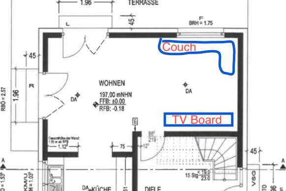

does anyone happen to have their TV positioned under a band of windows and could share a few pictures with me?
If you had to choose, TV under the band of windows, couch opposite, allowing a view through the patio door on the same side as the TV
or
couch under the band of windows (with the garden behind, patio door basically on the couch wall, and the view then towards the opposite wall with the band of windows.
Does anyone have either of these setups?
Thanks and best regards
or
Apart from the fact that I would never install a ribbon window with a 175cm (69 inches) sill height in my living room, as it would give me a complete basement feeling, I would rather lean towards this option:
however, with the sofa arm on the right side of the layout.
In general, I would probably add another window on the right side of the layout and also plan the upper wall differently.
Thank you for your feedback. The leg to the right is planned for the next sofa.
There is deliberately no window on the right side in the plan because the parking space is outside there, and a carport is intended to be built in that area. Currently, your suggestion is also my favorite. That's why there is the strip window. Placing the TV in front of a regular window would not have been an option at all.
