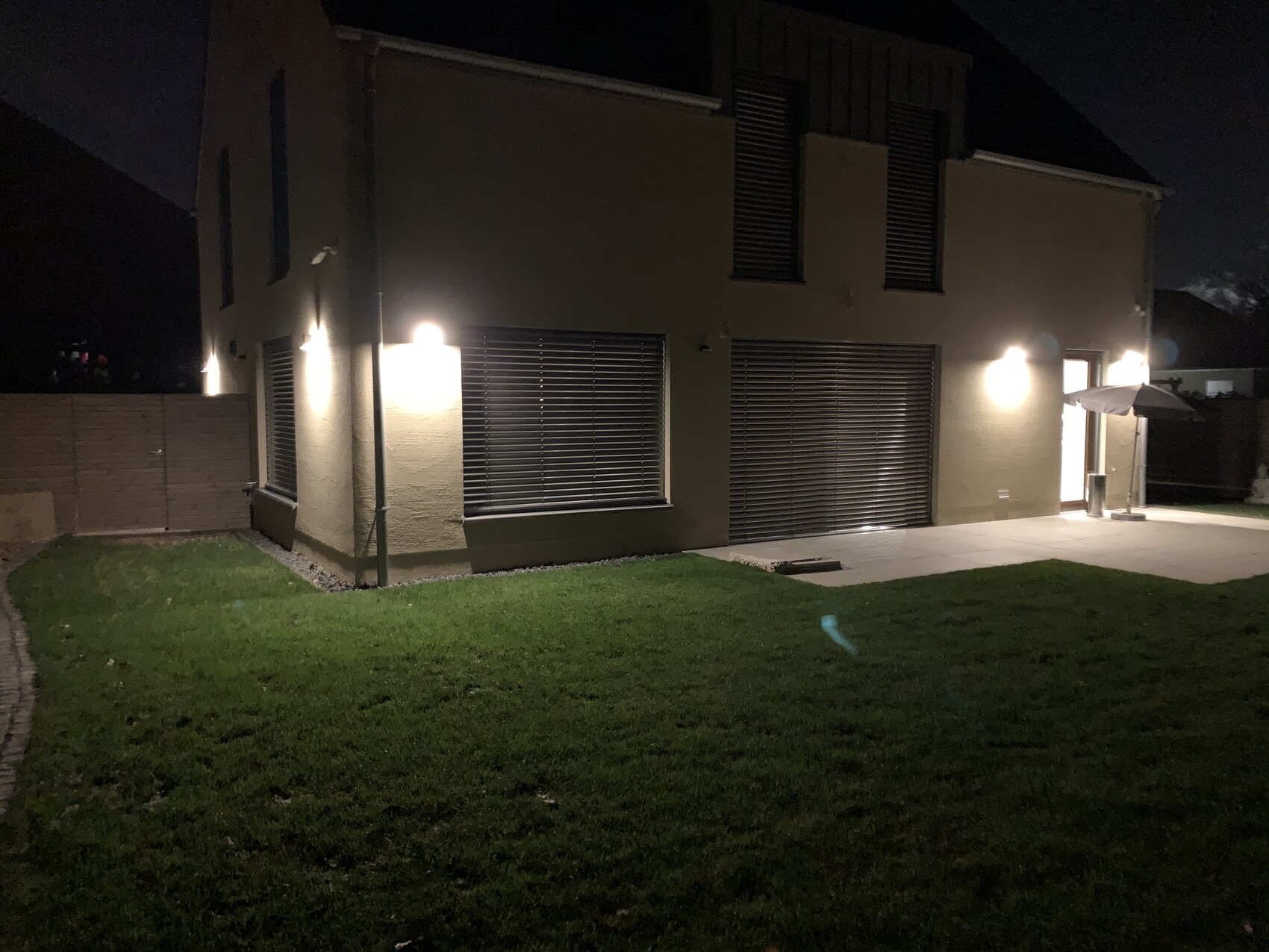

Maybe a few more details about our garden. It’s about 250sqm (2,690 sq ft) and @rick2018 has a very good memory – the garden is laid out like a U around the house. Along the fence, we have a curved mowing edge, but the rest is very straight and linear. The legs of the U are exactly 3m (10 feet) from the neighbor’s property. We actually planned to place the Robbie at the end of one of the legs as well.
The lawn is completely level, no slope, no sharp angles. What we’ve noticed by now is that our soil is quite clayey; when it rains heavily, real puddles form and the lawn remains muddy for a long time afterwards. Does that affect the choice or general use in any way?
For your information, here are some pictures of the garden.
Left side...

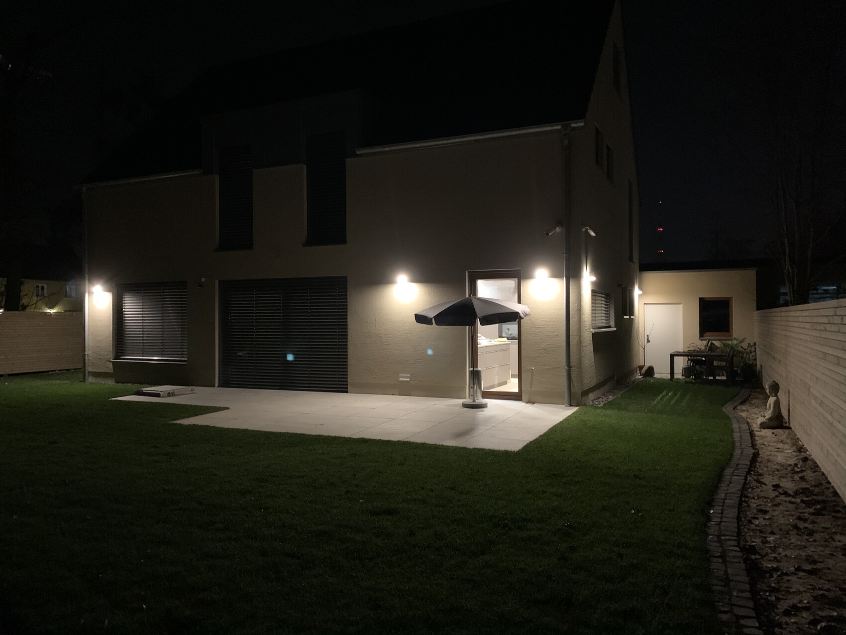

Right side. (Please ignore the “umbrella.” That’s our current shelter :p)
Closer view of the right side. Here the little shed for the Robbie is planned. To the right, under the garage window.
Is that really a bad position?

The charging station can be ideally placed in front of the garage, especially since, as I can see, you have paved that area :-) I would lay the guide wire in a U-shape and set 3 or 4 different start positions for the mower on the guide wire in Robonect. This way, the entire area around the house will be nicely mowed.

@Tarnari: For Robbys with search cables, a 3m (10 ft) width is tight because the required distances between the search cable and the boundary wire cannot be maintained. However, you can easily use Robbys that navigate into the charging station by following the boundary wire.

The location of the station is not ideal. Width-wise, it just fits if you place it in the middle. However, it will always be in the walkway from the door. You can either place it on the existing slabs and run 4-5 small empty conduits underneath (1 x BK left, 1 x SK 1, 1 x power from the transformer, 1 x SK 2, 1 x BK right), put it on the lawn which means there will always be grass around the station that you need to trim, or lay additional slabs to place the station on.
The advantage of placing it in the corner is that you can manage with just one locating cable easily.
Thanks to the level terrace and the edge borders, you have great conditions for a robotic mower. You can install the boundary wires directly along the edges, so the mower drives a bit over them and no stripes are left uncut.
