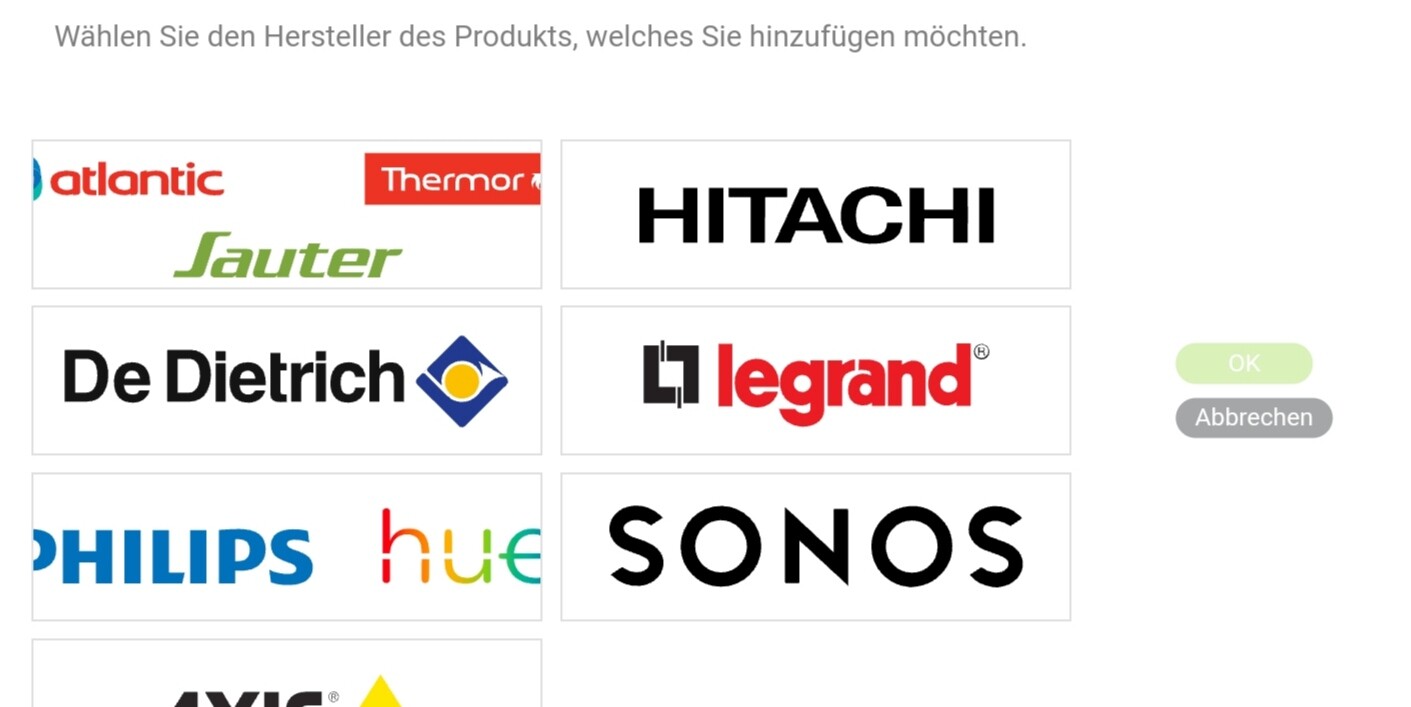

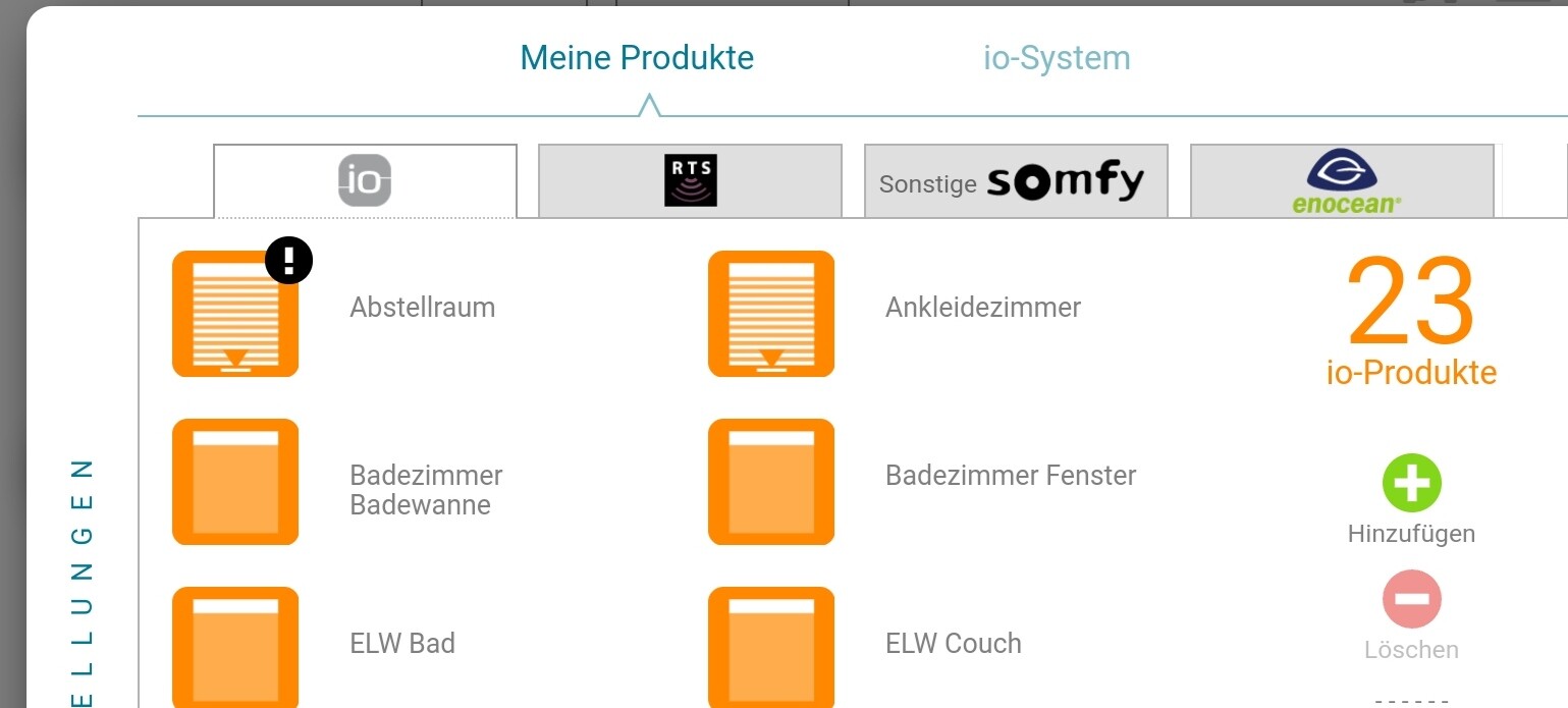

Ah, so with the wall switches you made, it’s just as Hangman described! That’s a very, very well done solution!
tomtom79 schrieb:I know, that’s why I really liked the idea with the screenshot 😎.
On the left side, you always get scolded by the admin.
