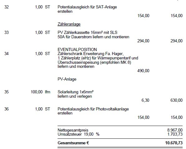

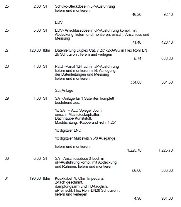

I have been a silent reader until now and would like to share my experience. We are building with a local general contractor and have included a certain number of power outlets and light points in the package. We spent several hours with the electrician going through the shell construction, and the following offer was created.
I’m sharing this with you as information about current prices (Aachen area). I would also appreciate any feedback if you notice anything. Here is a summary:
- Additional power outlet €55
- Additional light point €50
- Cat 7 wiring in 6 rooms (always double outlets) €1,728
- Satellite system + wiring in 6 rooms €3,150
- LED spot 5W €50
- Stairway orientation light €96
We originally wanted to discuss photovoltaics separately. However, the electrician has already included part of it in the offer.
The spots and orientation lights seem quite expensive to me, especially since the light point is charged separately.
Christian
![Site list: power/IT outlets, patch panels, satellite system, cable overview[/ ALT]](/attachments/86074/)

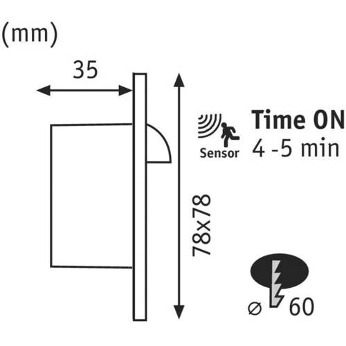

By the way: in the utility room I could almost use 8 power outlets, and in the bedroom I would miss a two-way switch if you’re already investing a lot.We still haven’t finalized the bedroom setup; we’re still considering options.Overall, I’m a fan of indirect lighting. Especially in the evening, we rarely have the ceiling light on, and when I get up to use the bathroom at night, I don’t necessarily want to turn on a bright light. The electrician offered me switchable night lights for a steep price of €96 each.
Here, I’m thinking more of recessed lights with motion sensors, which I want to source and install myself. I had something like the "Paulmann 92923 LED recessed light with built-in motion sensor, fixed 2.7W LED, glossy white" in mind, costing about €20 each.
What does the electrician need to prepare for this? A junction point inside a flush-mounted box that isn’t switched off but basically always on? As you can see, I’m not very knowledgeable about electrical setups.

MachsSelbst3 Jun 2024 13:25Alright. The electrician, of course, wants to make money and uses a mixed calculation. He charges a flat rate of 55 EUR per outlet, whether he has to install an entirely new cable or simply expand a basic outlet to 2, 3, or 6 (which you can do yourself if you have the proper training, even if the walls are already wallpapered, painted, tiled, or similar)...
For the emergency lights, he needs to run a cable to each one and intends to install a switch for them as well. That costs more.
So, I don’t think it will be significantly cheaper for you if you ask him to just install the flush-mounted boxes and pull the cables without the switches. He’s not stupid and knows exactly that you want to install the lights yourself; he will still make his margin from you... what else can you do? If you want it done, you have to buy it from him...
