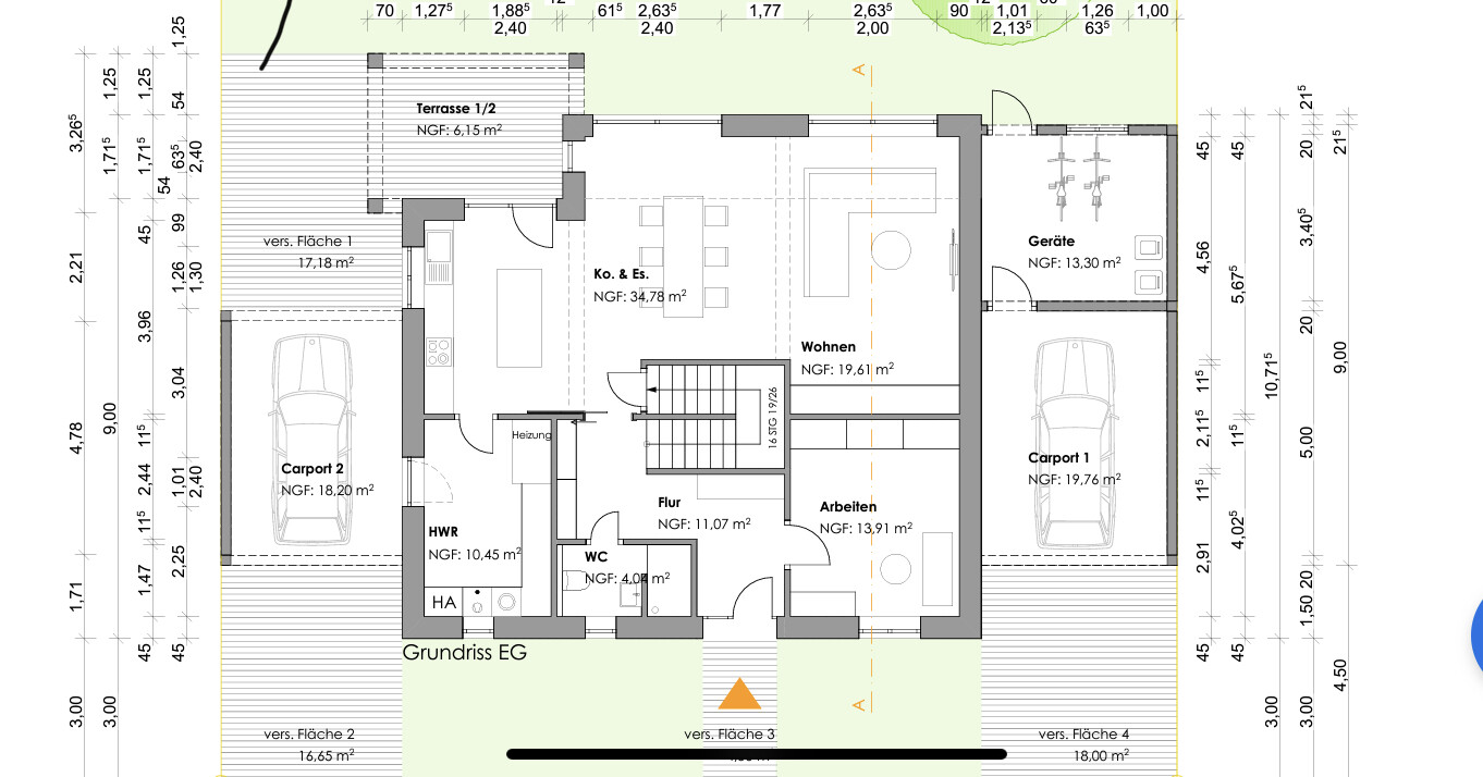

Thank you @11ant for still having a clear memory of our house. However, I don’t really see many similarities. Where do you see them?
Ground floor plan: living/dining area, kitchen, office, hallway, WC, utility room, heating, stairs, carports, terrace.

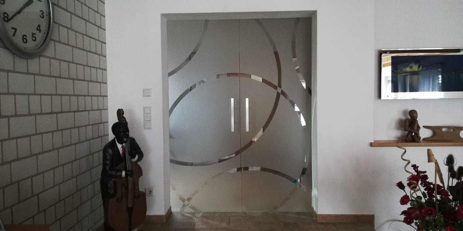

Sliding doors belong on the Enterprise 🙂
I don’t agree. Mine looks nice and is quite practical since it closes automatically.
Hallway with glass door featuring a circle design; on the left, a jazz musician statue with a cello, on the right, flowers.

I didn’t mean an identical twin-level resemblance. More like in the “spirit” of what I believe the original poster envisions as the final result; and otherwise (but only limited to the style) in the house’s shape and carport. My gut feeling tells me they will be similar in price. Would you like to estimate the budget “after settlement” here?

That’s exactly what I meant. On the Enterprise, the doors are self-closing, even with the softest “whoosh” sound you’ll find in recording studios. I share Yvonne’s view that in reality, they don’t operate so effortlessly or intuitively. Tell me more about your self-closing mechanism and the fees involved (and whether it’s attractive enough to be used on the door leading to the hallway/seating area in front of the wall as well – otherwise, that one tends to stay open forever).
