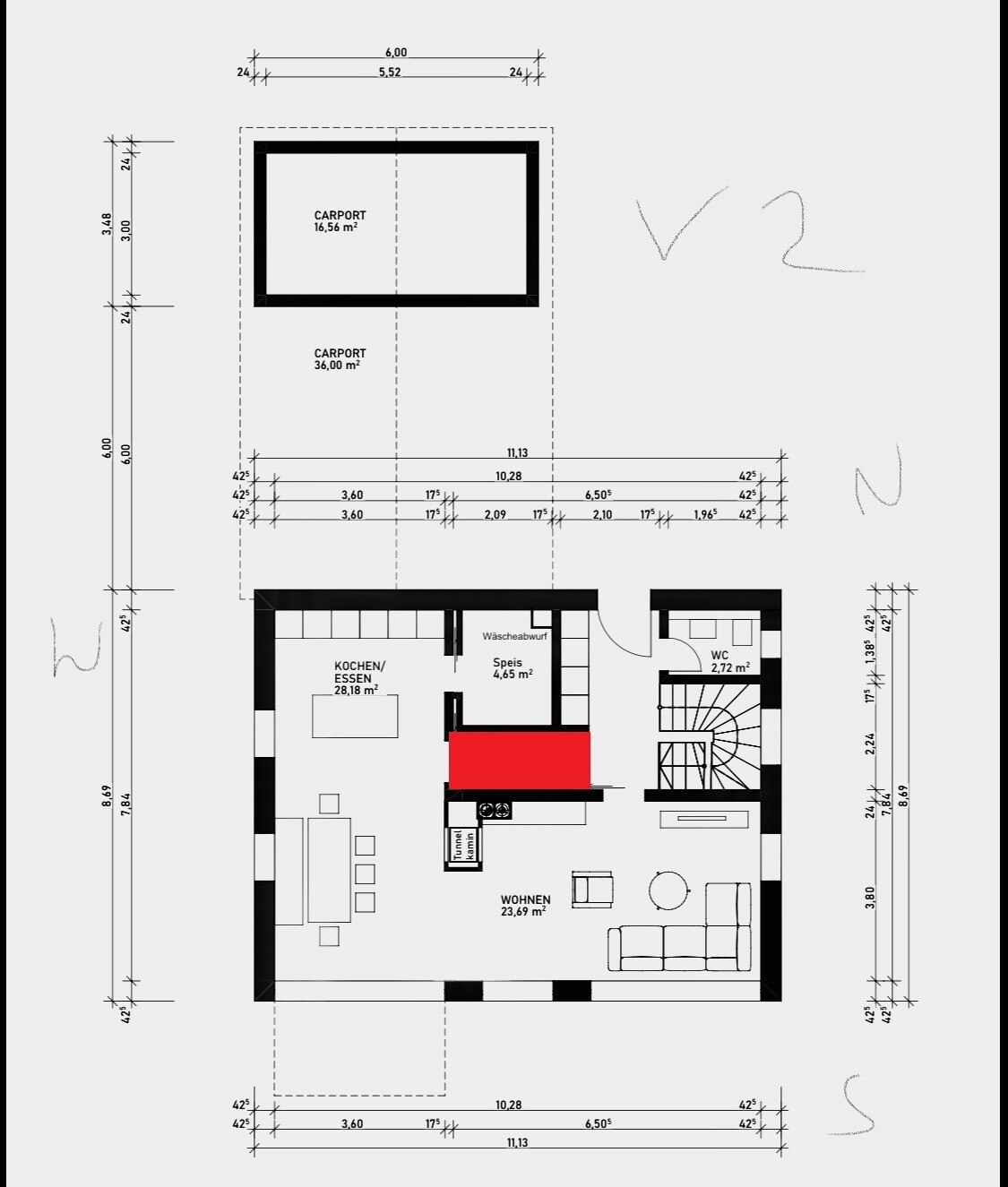

Hello everyone. We worked on two versions with our architect and aren’t sure which we prefer. There is a stove bench next to the stove in both.
The windows throughout the house are not final yet; we still need to discuss them.
We plan to build a carport between the house and garage. Do you think the kitchen window makes sense even though it basically faces the carport? We think at least you can see the children playing and who is arriving.
To the east is a single-family house, to the south a large meadow, and to the west the street, which is very quiet since it is a rural area.
This is my first post; I hope I’ve done everything correctly—if not, please forgive me in advance.
Looking forward to your suggestions. Best regards

evelinoz schrieb:
What is the purpose of the red area?
[ATTACH alt="einfamilienhauszwei-varianten-grundriss-vom-architekt-469002-1.jpeg"]57073[/ATTACH]Thanks @evelinoz 🙂11ant schrieb:

Kathianni7 Feb 2021 12:03We want to have a door to the kitchen. I also think that it is unfortunately poorly designed.
