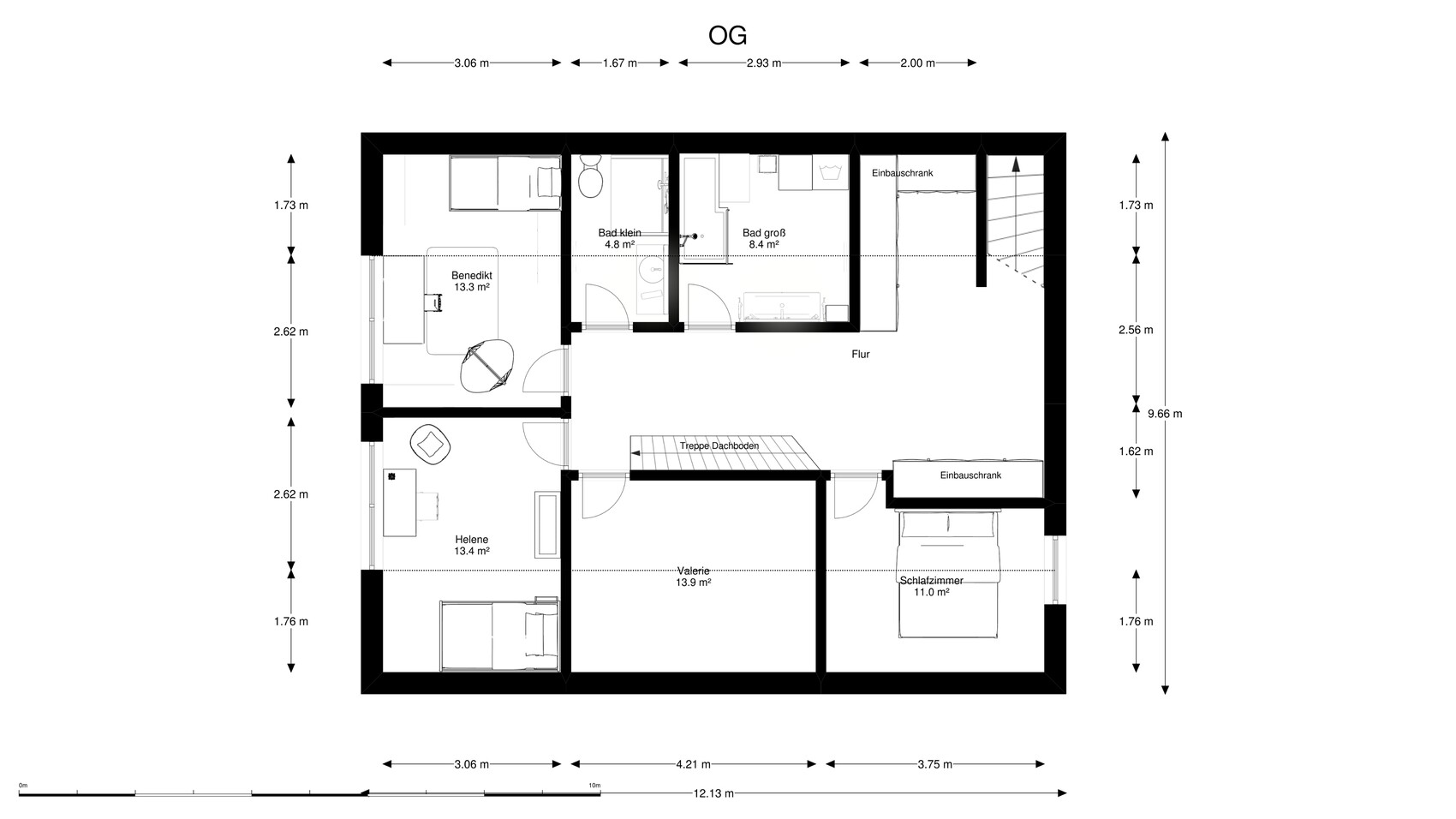

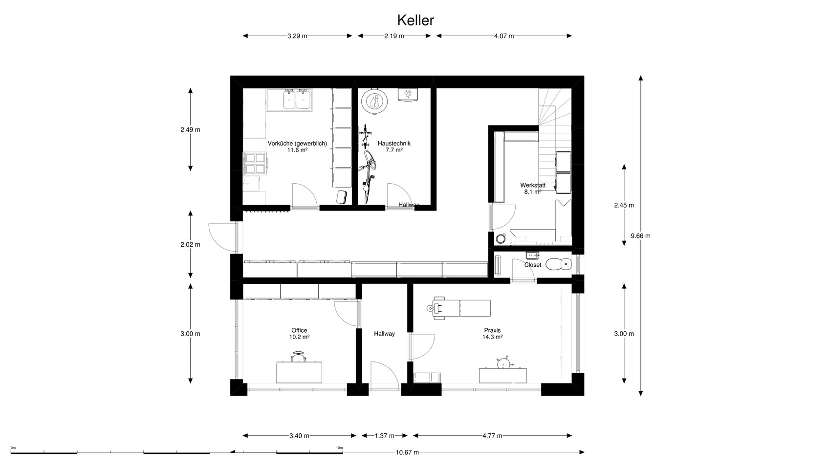

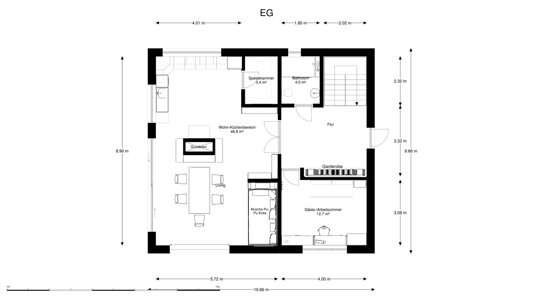

Things are getting serious for us: we're moving into the detailed planning of our building project. I would really appreciate your feedback on our amateur floor plan design. We are building in the Ore Mountains, in Germany’s highest-altitude town, Oberwiesenthal. Here, prices are still similar to those in former East Germany (I have compared and there is a significant price difference). So, here we go...

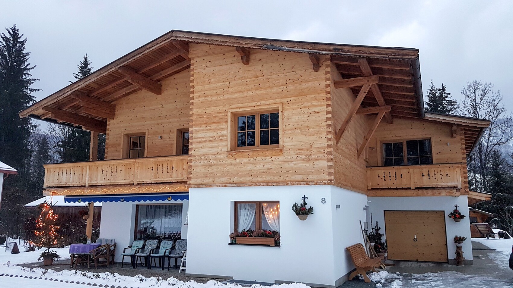

- Country/wood house (basement and ground floor with white plaster exterior; upper floor and roof structure with wooden planks in Tyrolean castle look)

- Basement partly used commercially (my wife’s naturopathy practice and my office, with separate access from outside/south)

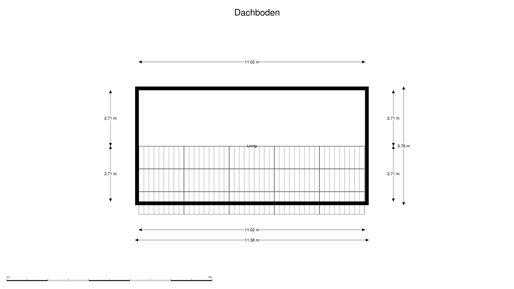

- Attic: half storage, half sleeping/chill area for our children with friends or guests

- Therefore, a second entrance in the basement on the west side is planned, including a simple cloakroom and storage room for skis or mountain bikes in summer and work clothes after gardening

- In the basement there is a prep kitchen for the Prijut12, which I will operate starting May 2020 (a rustic wooden hut with a modest menu and great location for drinks)
- In the prep kitchen, before the main winter season, we want to a) prepare and freeze food, or b) cook fresh meals in larger quantities and sell them right opposite at Prijut12 (about 80 m (260 ft) away)
- The kitchen in Prijut12 is very small

- Open living and kitchen area
- Interaction with children and friends while cooking, for example
- Cozy “shell-pu-pu” corner including TV
- My father implemented this in his holiday home
- It is very cozy
- Large lounging area
- Curtains cover the TV (it disappears from daily view)
- Second small bathroom on the first floor
- When our two daughters enter puberty, they will have their own hygiene area

- Does this floor plan make sense regarding building technology/piping routes, and can the forum identify flaws for daily use?

@philipok ... if you come back after 3 months looking for answers, it would be helpful if the floor plan at least included a north arrow and, ideally, if a site plan showing a sketch of the house’s location was added in the new post or at least linked to the post number where it is shown in this thread. Otherwise, everyone interested has to search for it individually ... not very practical.
Was the upper floor a full story? If not, then the 2-meter (6.6 ft) line from the roof is missing.Hi kbt09 ... sorry for the missing information! There is no site plan yet. It is currently being prepared. And yes, the upper floor is planned to be built as a full story.
