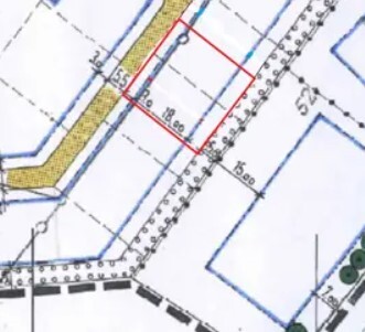

What is planned there in the southeast?
Site plan with red building outline on terrain plan.

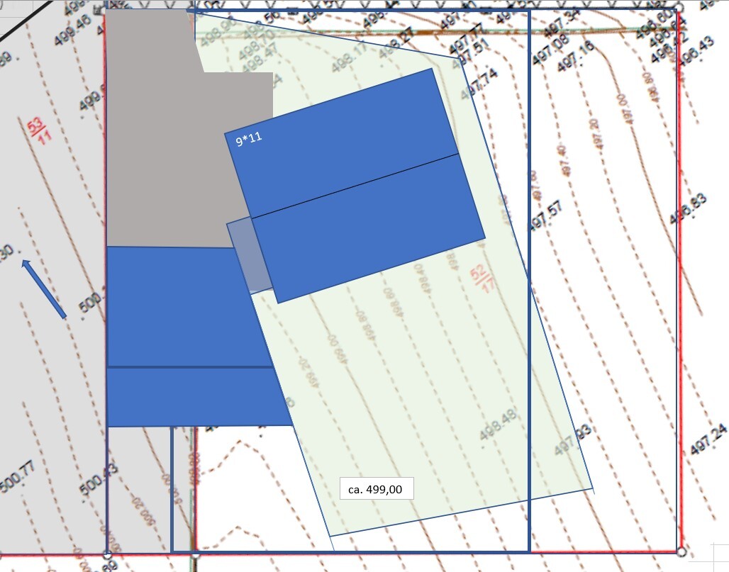

hanghaus2023
11 Feb 2023 09:16
If it were my property, I would plan as follows: no basement, but with a large storage room instead. This should qualify as a detached house.
Site plan with blue building areas on parcels, measurements, and price approx. 499.00
11 Feb 2023 10:29
Dachshund90 schrieb:
For these reasons, the green layout was suggested as an alternative
The green layout wouldn’t be my choice. Maybe you mirror something like that… but to build only on my own west side? No thanks…
And while we are on the subject, since we get along well with the neighbors to the north, it’s still unclear whether we want to place the garage directly on their boundary, as it could potentially shade their terrace.
Forget it: wherever the garage blocks someone's sun, it will feel like pitch dark inside the house.
A neighbor who tends to complain rather than accept things will _always_ raise objections. No matter how subtly or low you build: your house will bother them.
hanghaus2023 schrieb:
The garage cannot comply with the Hessian building code.
Still, I’m surprised this garage wall—essentially a “two-story” structure—even comes from an architect. I would reconsider if I needed approval and rather opt for plan c, d, or e.
