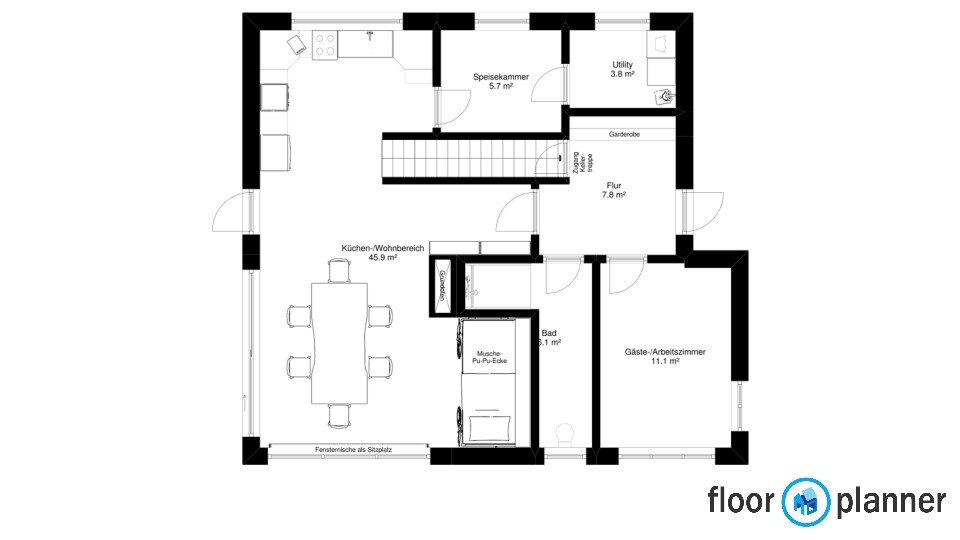

Attached are the floor plans and an example house from Bavaria, which serves as a reference for the exterior cladding look.
Attic floor plan: large rectangle with railing/grid partition and dimension lines (11 m).
Ground floor plan: living and kitchen area, pantry, bathroom, corridor, cloakroom, guest/workroom
Basement floor plan: prep kitchen, building services, workshop, office and practice rooms with doors.
First floor plan: corridor, four rooms, two bathrooms, stairs to attic, built-in closets.

... is nonsense. It is clearly a client forum here, not an architects’ club.
You asked whether "one" should plan the ground floor first, or what we recommend: usually (ground floor = entrance and living areas, upper floor/attic = sleeping areas) I suggest starting with the upper floor because it is more detailed. Also, as a layperson, it’s easier to “think” about downpipes from the top down.
Then you said that regional architecture was basically born out of necessity. Yes, but that’s actually the root of all regional building cultures. And you don’t exactly distance yourself from that: I see your design as very typical of Germany/Austria/Switzerland Alpine style, and in broad terms, it would look just the same if built 300 years ago from log beams. Except for bathrooms instead of washing at the well or mountain stream, it’s practically an original Alpine hut or seasonal mountain pasture dwelling. Where you place the toilet, you tend to make the room as narrow as a bowling lane. Narrow stairs, cozy tightness, the alcove, the walk-through pantry — a herdsman back then would have built it very similarly. If you told tourists the practice used to be a sheep barn, they’d believe it.
With all due respect to the fact that every family may have their own particular style of coziness, this only partly explains the peculiarities of your planning style, and to a greater extent seems to be due to awkwardness, which is, of course, understandable for a layperson.
A professional, who also doesn’t have to be an “urbanite” and can understand you culturally well, would in my expectation come to a “more generous” architecture. Especially in mountainous regions — as I said, in Germany/Austria/Switzerland and also Italy very similar to each other — much building culture is reinterpreted, i.e. respectfully updated for the present day.
I’m just waiting to see what the planner comes up with. According to him, he will give the whole thing the appropriate Erzgebirge-style touch...

The three floor plans for the basement, ground floor, and upper floor add up to 250 sqm (2690 sq ft) of living space. I’m excluding the attic. You skillfully left out all the hallways.
Also, the basement has living space quality, which means it costs as much as the ground and upper floors.
For new builds in 2019, we calculate about 2,000 € (USD equivalent) per sqm (about 185 sq ft) of living space or 400 € per cubic meter (at least that was my architect’s estimate in 2018).
This works surprisingly well for many projects with mid-range standards. And that’s without additional construction costs (house connections, civil engineering, drainage, fees, architect, energy consultant, etc.), exterior work, kitchen, garage, etc.
I think it’s becoming clear now! I’m also building right now with an architect, including a basement and slope, so I know what I’m talking about when I say your 480k € - 500k € won’t be enough. Unless it’s a shell house and you do absolutely everything else yourselves.
Pffff, that’s tough. I have friends who built three years ago: 170 sqm (1830 sq ft) of living space, partially finished basement (3 children’s rooms). They were around 350k € (USD equivalent) – but they did a lot of work themselves, especially outside.
I’ll simply discuss this openly and honestly with the builder again. Thanks anyway for the feedback on this.

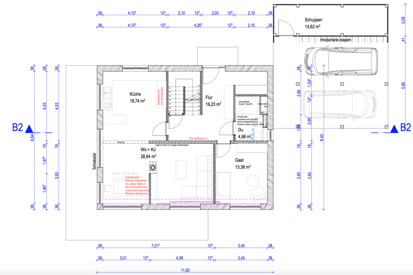

Hello forum, are there any participants who would like to provide feedback on the current status of the floor plans?
Floor plan of a building complex with hobby room, technical/workshop area, two work rooms, corridor, storage.
Floor plan of a house with kitchen, living room, corridor, guest room, shed, garage for two cars.
Floor plan of a house: bedroom, three children's rooms, corridor, two bathrooms, and balcony.

@philipok ... when you come back after 3 months and want answers, it would be helpful if the floor plan at least had a north arrow and, ideally, if a site plan with a sketch of the house marked on it was added to the new post or at least linked to the post number where it appears in this thread. Now everyone interested has to look for it individually ... not very practical.
Was the upper floor a full story? If not, then the 2m (6.5 ft) height line for the roof is missing.
