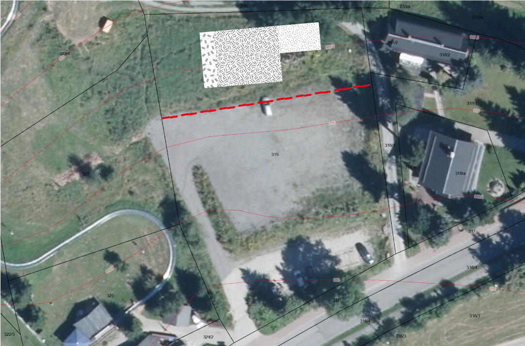

Basically, I miss the slope information here. It would be helpful if the plan included some contour lines to see how you access the garden from the ground floor.
Right now, you seem to fall deeply through the sliding door on the ground floor and risk getting hurt.

Here is the site plan including contour lines. The upper floor will be wider than the ground floor. On the right, I have also marked the carport area.
Aerial view of a property with plots, buildings on the right, red dashed line indicating terrain course.

5 Feb 2019 18:46
Is that a summer toboggan run on the left?
