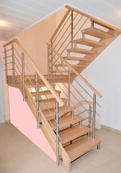

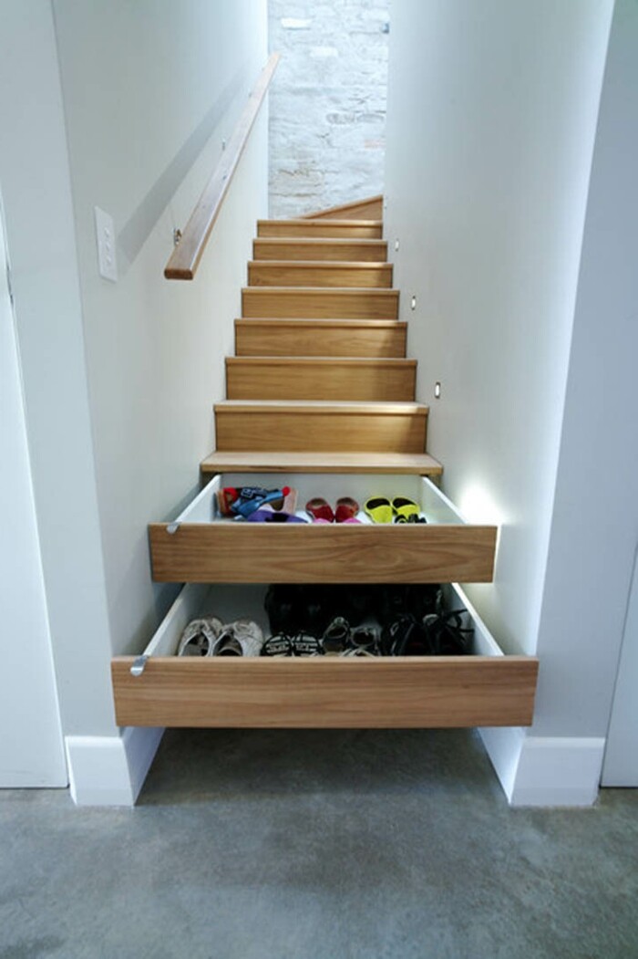

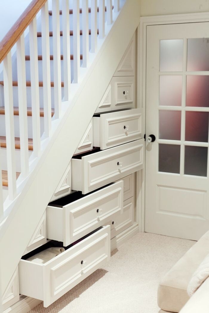

- Storage space in the hallway: I attached a picture of a staircase in the hallway to show how we imagine it. Shoes and bags go there. We have seen this setup used by a family of four. Jackets, as mentioned, will go in the utility room. Also, I appreciate the suggestion about the niche between the utility room and the restroom. Thanks for that @kaho674.

We already understood how you’re imagining the space under the stairs. A few shoes will fit there. You just shouldn’t expect too much, and the gain in space is probably modest compared to the effort. The area to be built under is only this one (I’m standing on pink):
For functioning drawers, you need a supporting structure and enough clearance inside from the stair treads. That will take several more centimeters on top. In the end, you might get about five drawers. But okay, every centimeter counts.
