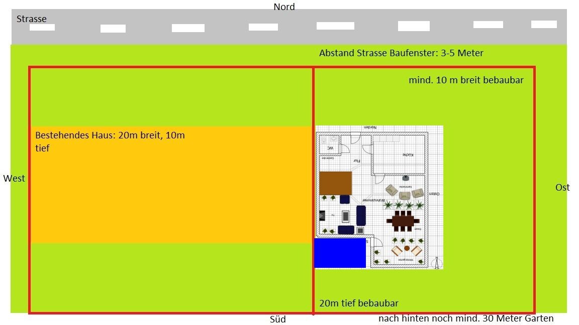

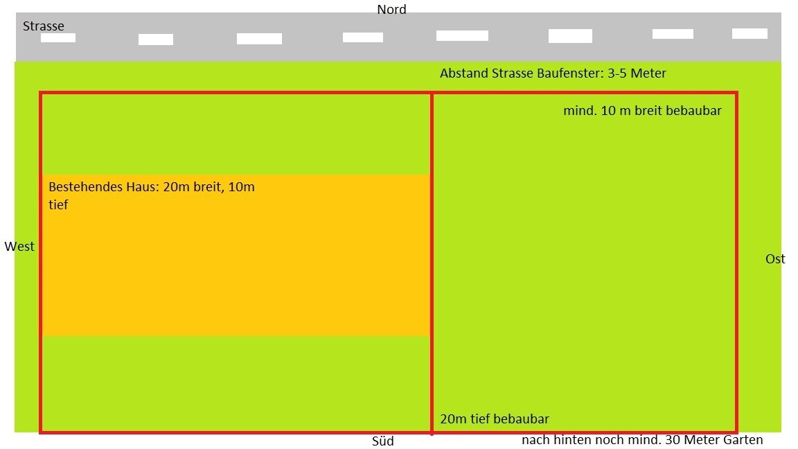

You should try placing your planned house on the plot first 😉
I meant the area marked in blue now:
The house plan roughly placed in the site plan oriented to the north (which is usually easier).
And then it would be good if you
then you could draw it roughly to scale onto the site plan. That way, you can get an idea, which you obviously already have in mind, but we don’t 😉.
kbt09 schrieb:
The way you are positioning your house, the 5 m (16 ft) wide terrace corner would be directly on the boundary of the existing building.
Hausbauer1 schrieb:
The house has a parking space at the front on the east side, then a garage, and behind that is a lawn with some trees. The house on the plot initially has a path leading from the terrace down into the garden, followed by normal grass, flower beds, and a few trees. The existing house is set back 8 to 10 meters (26 to 33 ft) from the street. A garage is located on the east side of the house, shifted towards the south. That would be demolished for our house. In front of it are double-row parking spaces, room for up to four vehicles.
Yes, correct. On the east side, it’s about 15 meters (49 ft) to the property boundary. There will be another house plot with a garage on the boundary, a parking space in front, and a garden behind it.
Hausbauer1 schrieb:
Well, the location is really good, central yet quiet. The area consists almost entirely of well-maintained single-family houses with nice front gardens. The problem is that the plot is in the wrong town, about 30-40 km (20-25 miles) away from the actual target destination. 40 km (25 miles) away from what? Work? Family, friends, or all of the above?
If it’s “just” work, you can always find a new job if needed. It’s different with family and friends. You can’t just drop by quickly anymore.
We also chose a building plot quite far from my family. However, it is close to my husband’s family and near the workplace. But if everything is just a compromise, I wouldn’t do it.

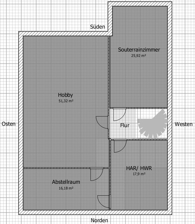

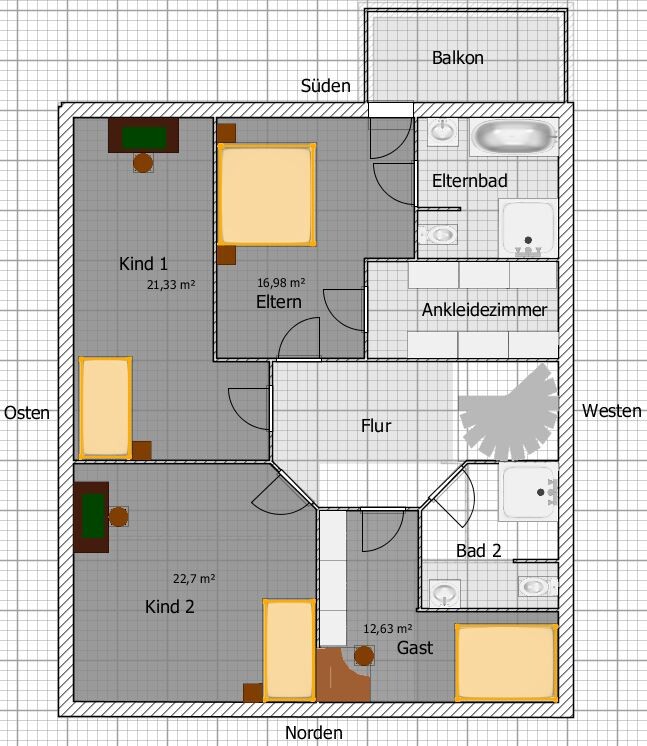

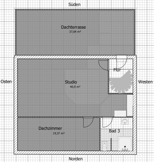

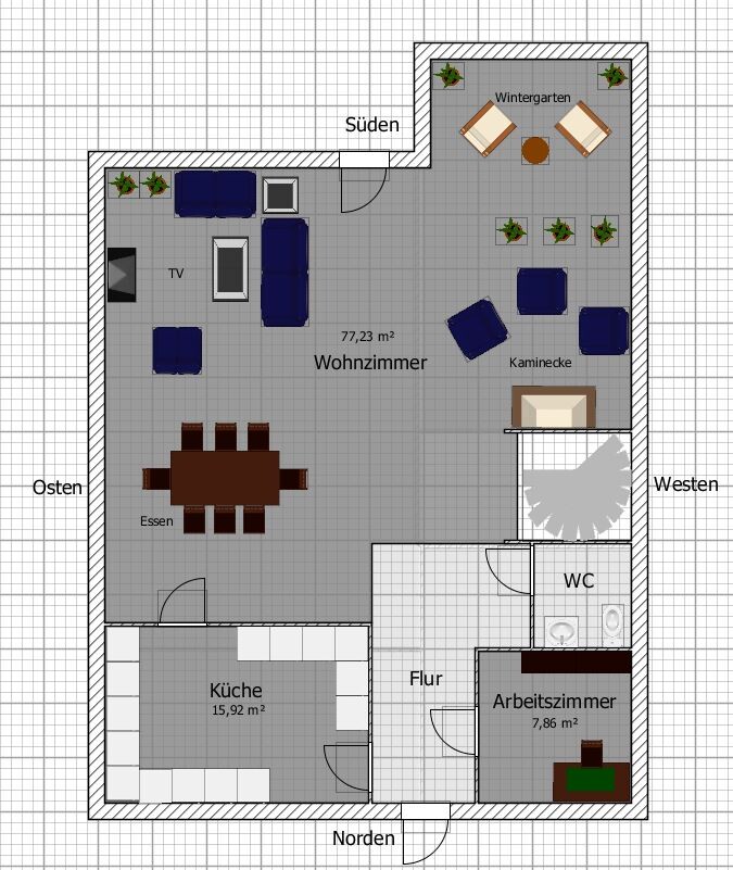

A few more questions and comments:
- Roof terrace practically on the 2nd floor... what do you expect from that? Carrying an evening glass of red wine up two flights? How does the roof terrace look in relation to the neighboring house?
- The three seating areas in the large open-plan space... what do you expect from the separation between couch/TV, fireplace, and conservatory area? For the conservatory, is it intended to be a real conservatory, meaning an extension, or more of a glazed corner of the house? If so, the floor above would also have an area similar to the roof terrace—how should that be covered? I could imagine the couch/TV area being somewhat more separated so it doesn’t disturb the others and isn’t disturbed by activities like playing games.
- Kitchen
Hausbauer1 schrieb:
open kitchen, cooking island: closed, unclear Number of seats: 6–8 - How high will the raised basement be? In other words, how much will it protrude above ground level?
- Guest room:
Hausbauer1 schrieb:
Overnights per year: 100 Really 100? It seems counterproductive if the guest room is in the basement and the nearest bathroom for showering is two floors up, in the kids’ bathroom. - Home office... do two people really need to work remotely occasionally or full time? There were originally at least two workspaces requested, but now there’s only one, which could be in the guest room or accommodate two people in one office. I would plan a space that can easily be divided with a partition wall into two separate offices.
What about the layout below: conservatory on the ground floor, then two floors, then the roof terrace, and finally a shed roof on the remaining part—how does that all fit beside the existing house?
Regarding closed kitchens... are you thinking of a separate kitchen or a dining area? If there’s an island, I recommend considering how the kitchen space will be arranged.
Maybe consider placing a kitchen and large dining area near the terrace, separate from the seating islands with armchairs.
Will guests stay for longer periods? Then it might be better to accommodate them in the attic with a bathroom. That might also make the terrace more useful, following the principle that guest and host have some separation at times.
The multipurpose room is designed for about 20 people, plus or minus. For a family of four, seating areas will likely remain unused in everyday life.
I also find it hard to accept the idea of having to look all the way from the far end of the house into the cloakroom or bathroom. Or having the mail carrier able to see me sitting on the sofa.
If industrial buildings with their mandatory large halls are taken as a model, more money will probably be spent on metal mesh and concrete than in a typical residential building. Using plants as room dividers is more reminiscent of a restaurant.
The planned fireplace flue on the upper floor is located directly in front of the bathroom.
And if I’m not mistaken, a roof terrace is at least partially included in the calculation of living space. So, if the knee wall is supposed to be over 2 meters (6.5 feet) high and the basement is designed as a raised basement, we are basically looking at a four-story building – it’s not as if a “basement” doesn’t count as a floor if it is built with ceiling height suitable for living space.
One probably does not even want to argue about the “aesthetics” of the house to be built here.
This plan is approached quite naively. At present, it can only be called a plaything, which certainly has its fun reason to exist, but is not suitable at all for detailed and realistic planning proposals.
Setback requirements and other regulations are not taken into account at all. While a high floor area ratio might allow some flexibility, there are still many considerations in the case of a two-part division.
It would be helpful if a site plan of the property with neutral measurements were provided.
Your image is only an interpretation, which is hard to understand.
