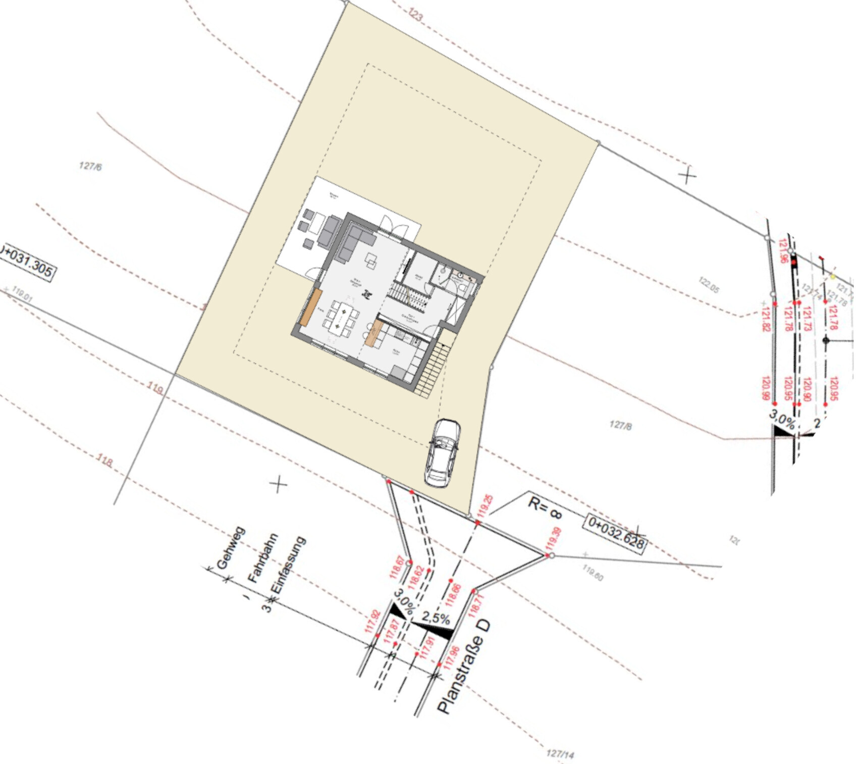

Hi,
after our first design turned out to be unrealistic budget-wise based on the initial offers, we discarded the plan with a basement and integrated garage.
The new plan is to build a lower ground floor on our south-facing slope, including a bedroom, two children’s rooms, a family bathroom, and a utility/technical room. Then on the ground floor, there would be an open living and dining area, a small pantry, a wardrobe area, and a shower bathroom. From the ground floor, you would then access the northwest garden and the terrace. The main entrance should be on the ground floor. We would prepare the attic for a future conversion or possibly integrate an office there if the budget allows. For now, the office will be set up in the second children’s room in the basement until it is needed! A carport or garage should be located on the south side or, if possible, on the east side.
Has anyone here completed a similar project or is currently planning one? Photos or ideas of floor plans would be great!
We would appreciate any feedback in any form. I have attached the list of details about the plot as well as a site plan! Our plot is number 6!

Pinky03012 Nov 2020 17:10
I also can’t imagine that an open-plan office connected to the living area is a good idea in terms of noise.
I agree that the bedroom is too small. I don’t think having a walk-in closet inside the bathroom is a good idea. On one hand, because of the moisture, and on the other hand, with four people, there will already be a bottleneck in the bathroom. If you also need to use it for clothing storage, it will probably get even worse.
I have no idea how much a mezzanine like the one you’re planning for the office would cost. Is it much cheaper than just designing a regular attic? Placing the kids’ rooms under the roof, and the office and bedroom in the basement could help ease the situation.

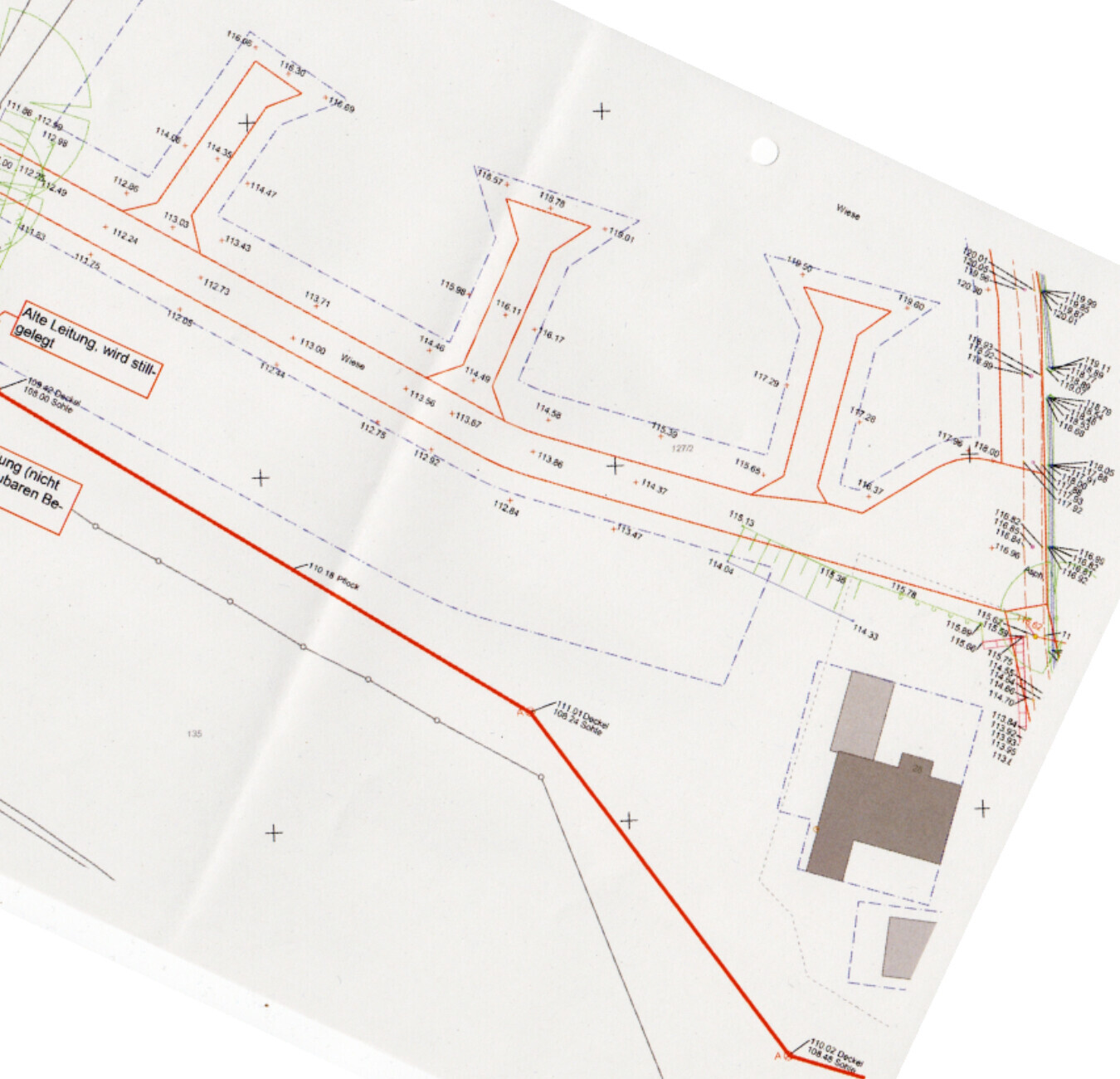

Wow, the exterior stairs in this design really remind me of https://www.hausbau-forum.de/threads/2fh-Grundstück-mit-herausforderung.35966/.
The elevation plot seems to have north at around 9 o’clock (?), but unfortunately it shows very few elevation points on the property – does the slope continue evenly in that direction?
Sorry, I should have rotated the plan… north would be at 12 o’clock on the elevation plan.

11ant2 Nov 2020 18:40
DaniMartinez schrieb:
Sorry, I should have rotated the plan.... North would be at the 12 o’clock position on the elevation plan
Several plans needed to be rotated, and north was only correct on the development plan. I have corrected this:
