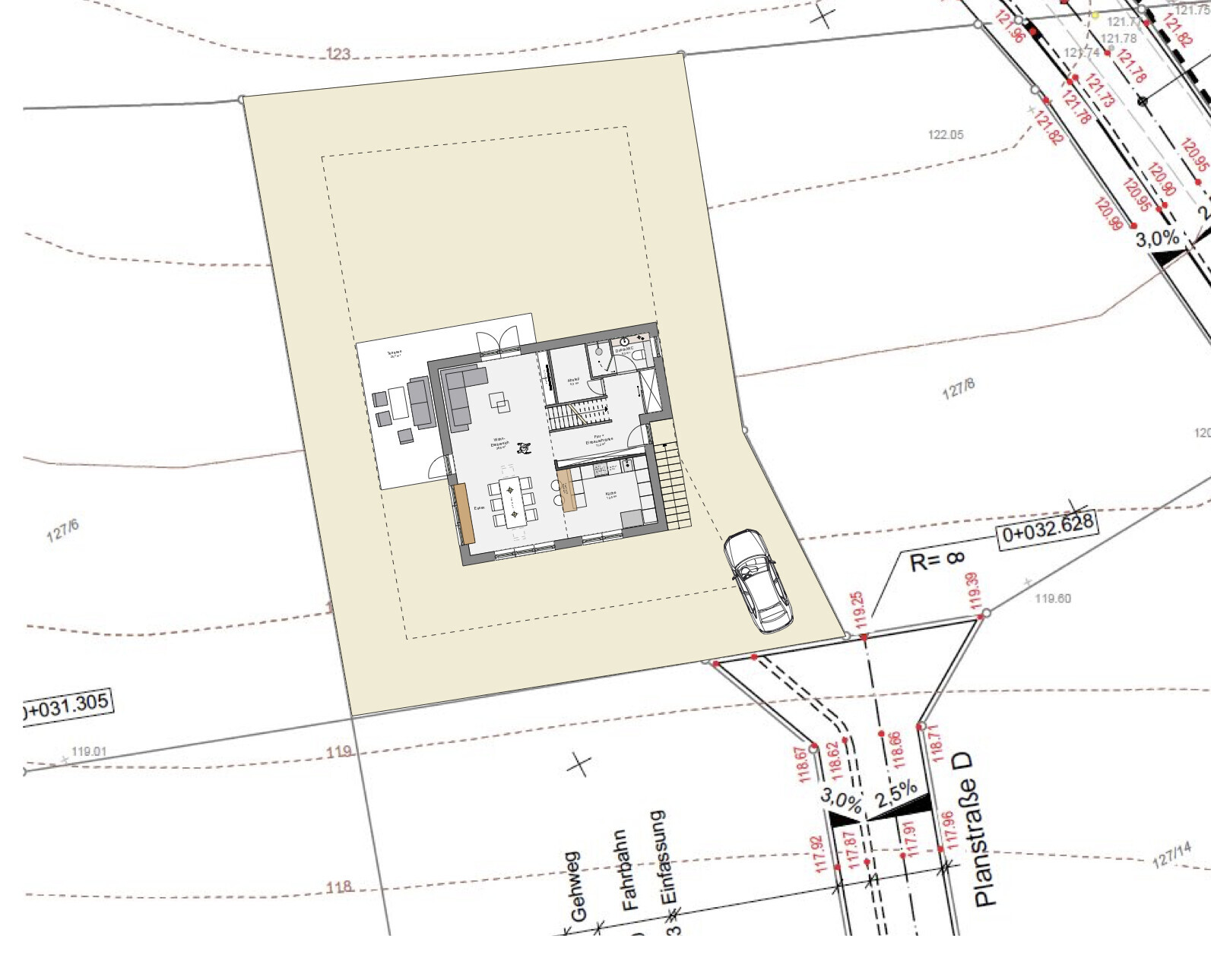

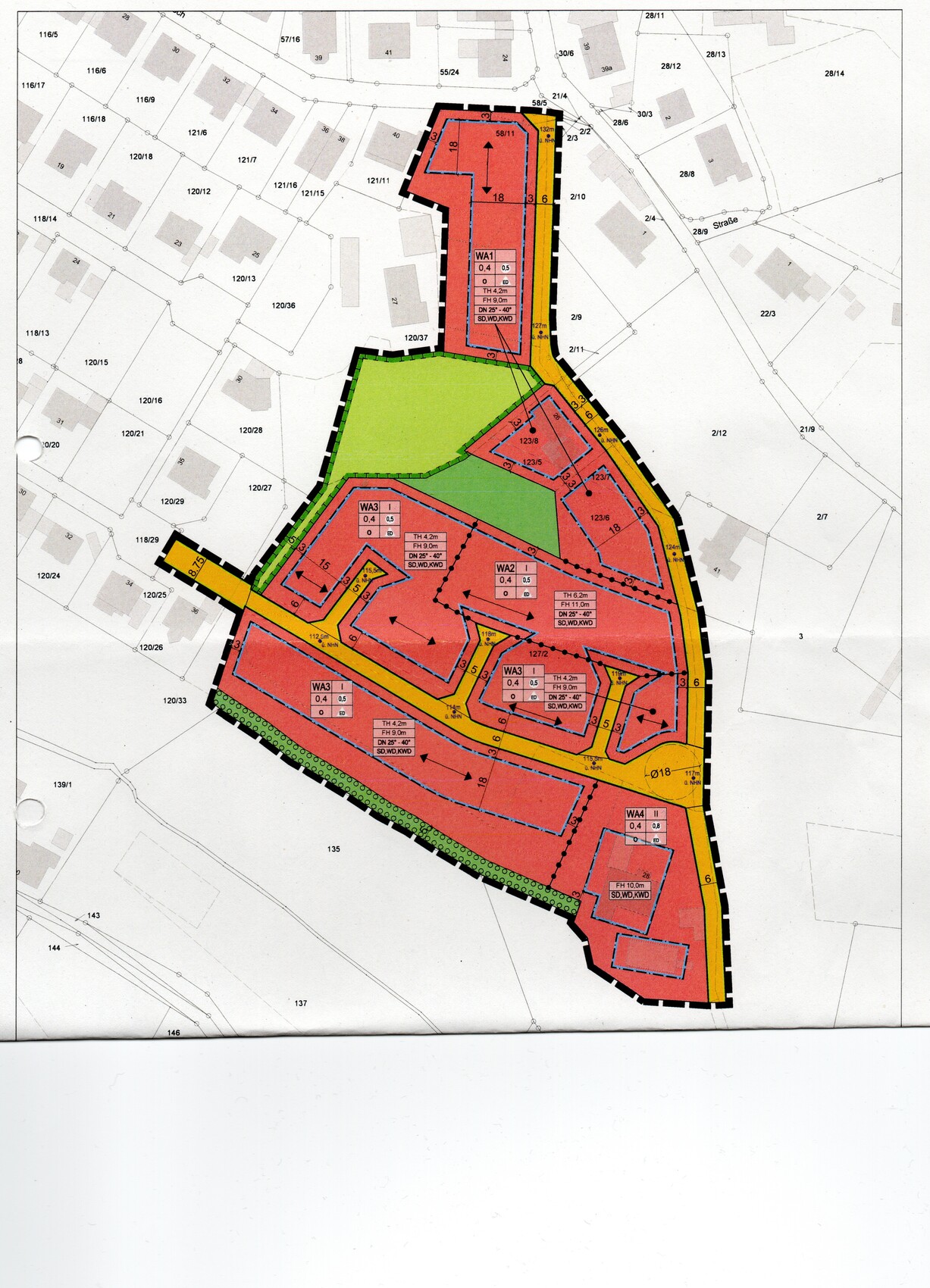

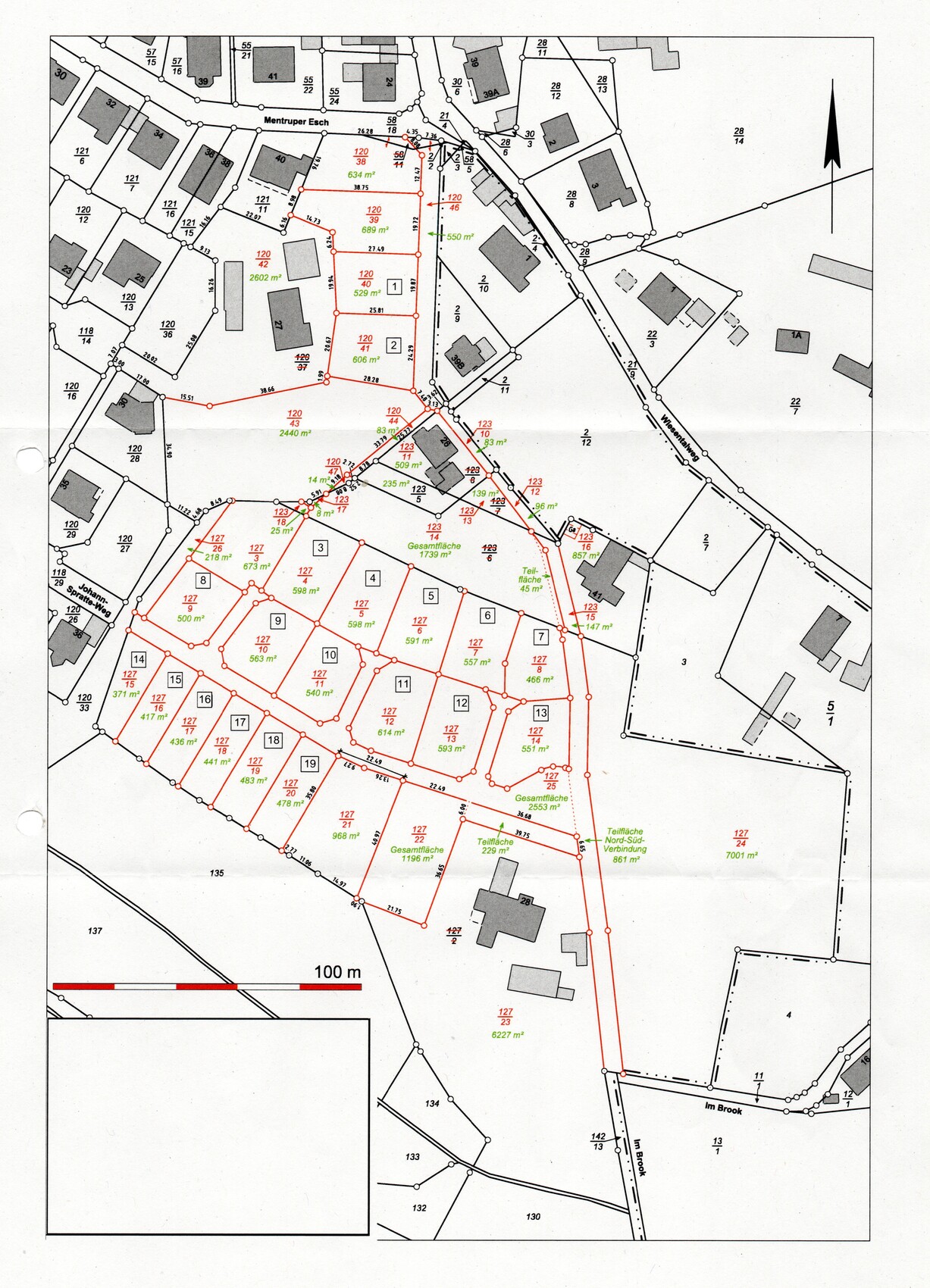

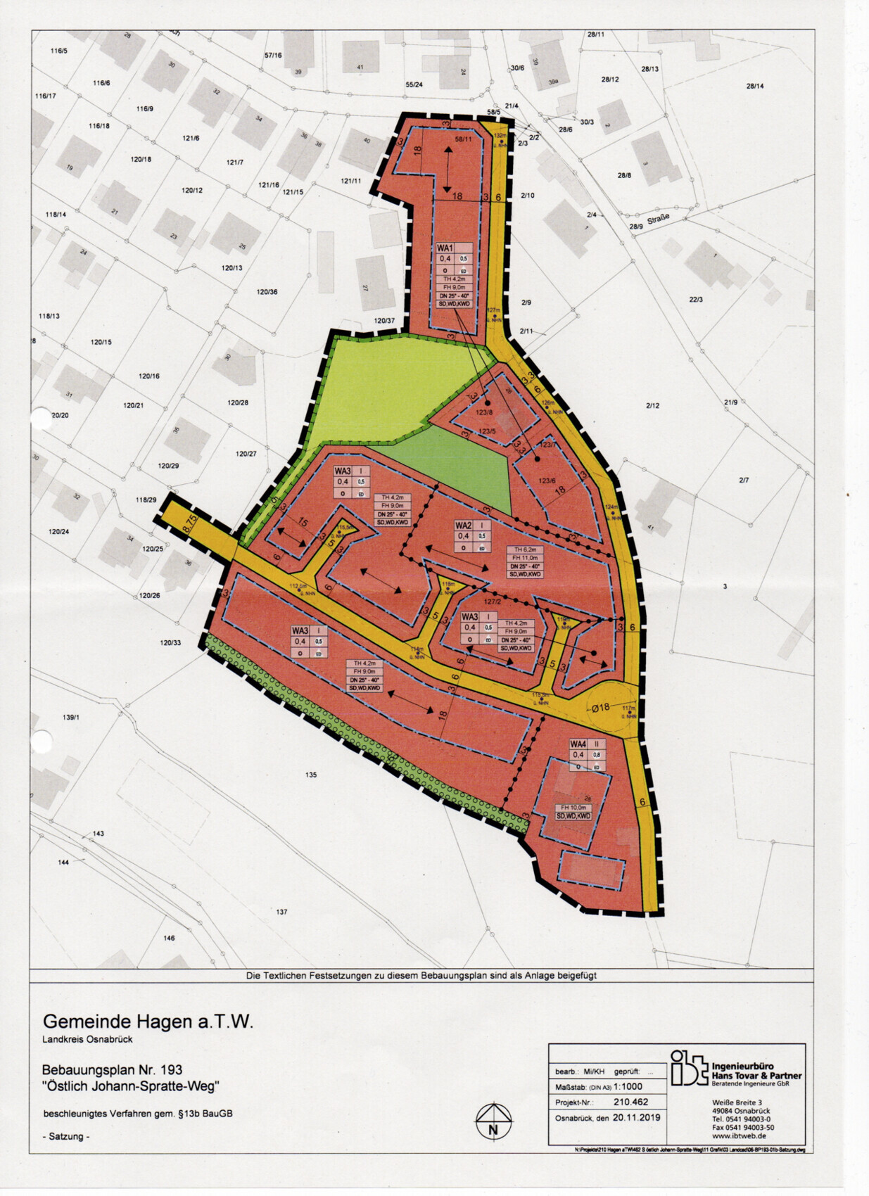

We would appreciate any feedback in any form. I have attached the list of details about the plot as well as a site plan! Our plot is number 6!

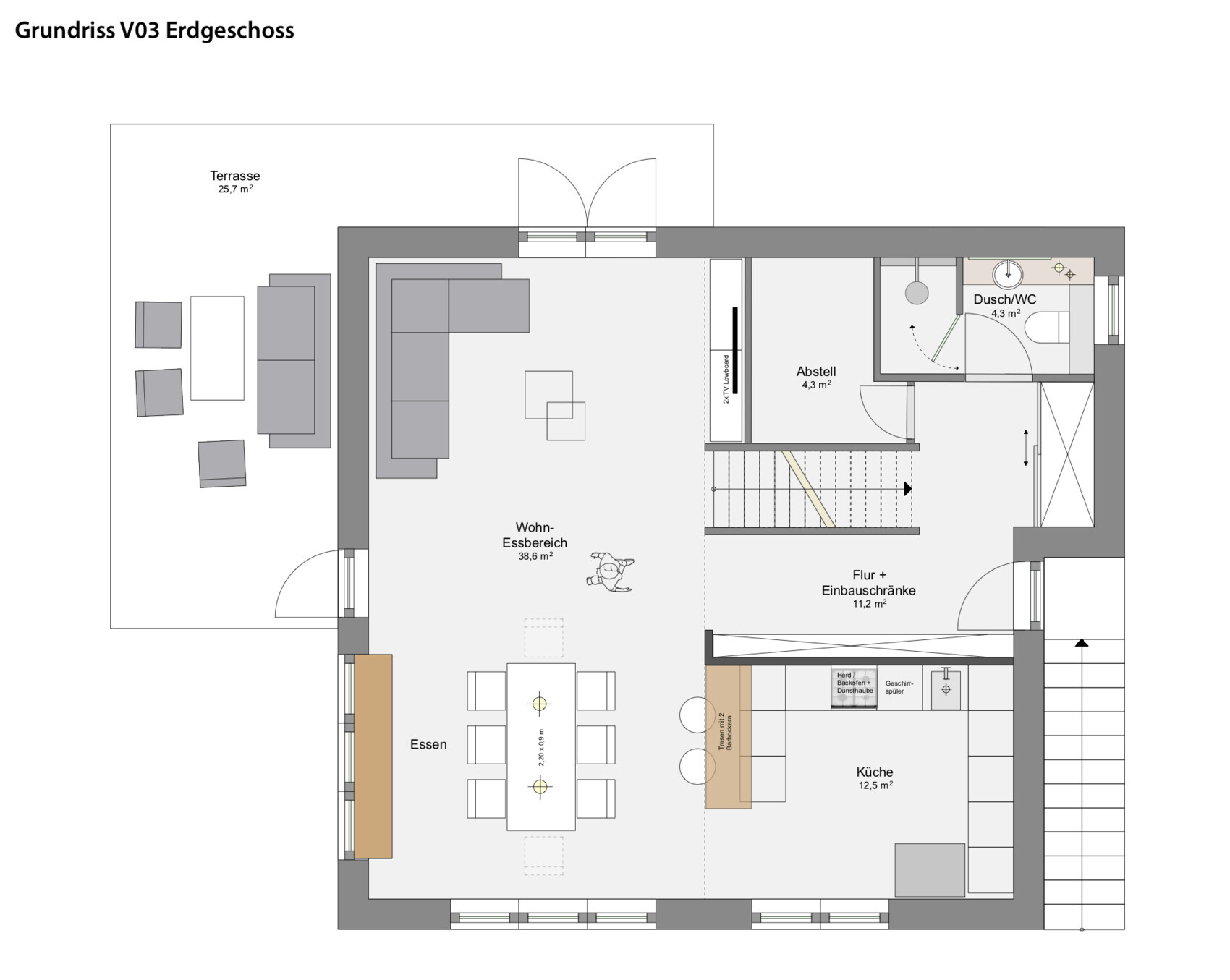

DaniMartinez2 Nov 2020 15:5011ant schrieb:
Wouldn’t it make more sense to aim for fewer rather than more square meters?
Please add a site plan with elevation details. Yes, but previously, including the basement, it was over 200 sqm (2150 sq ft).

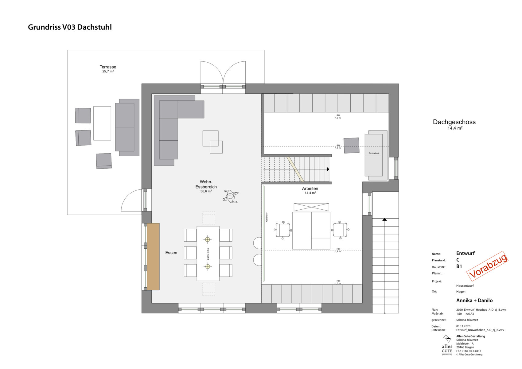

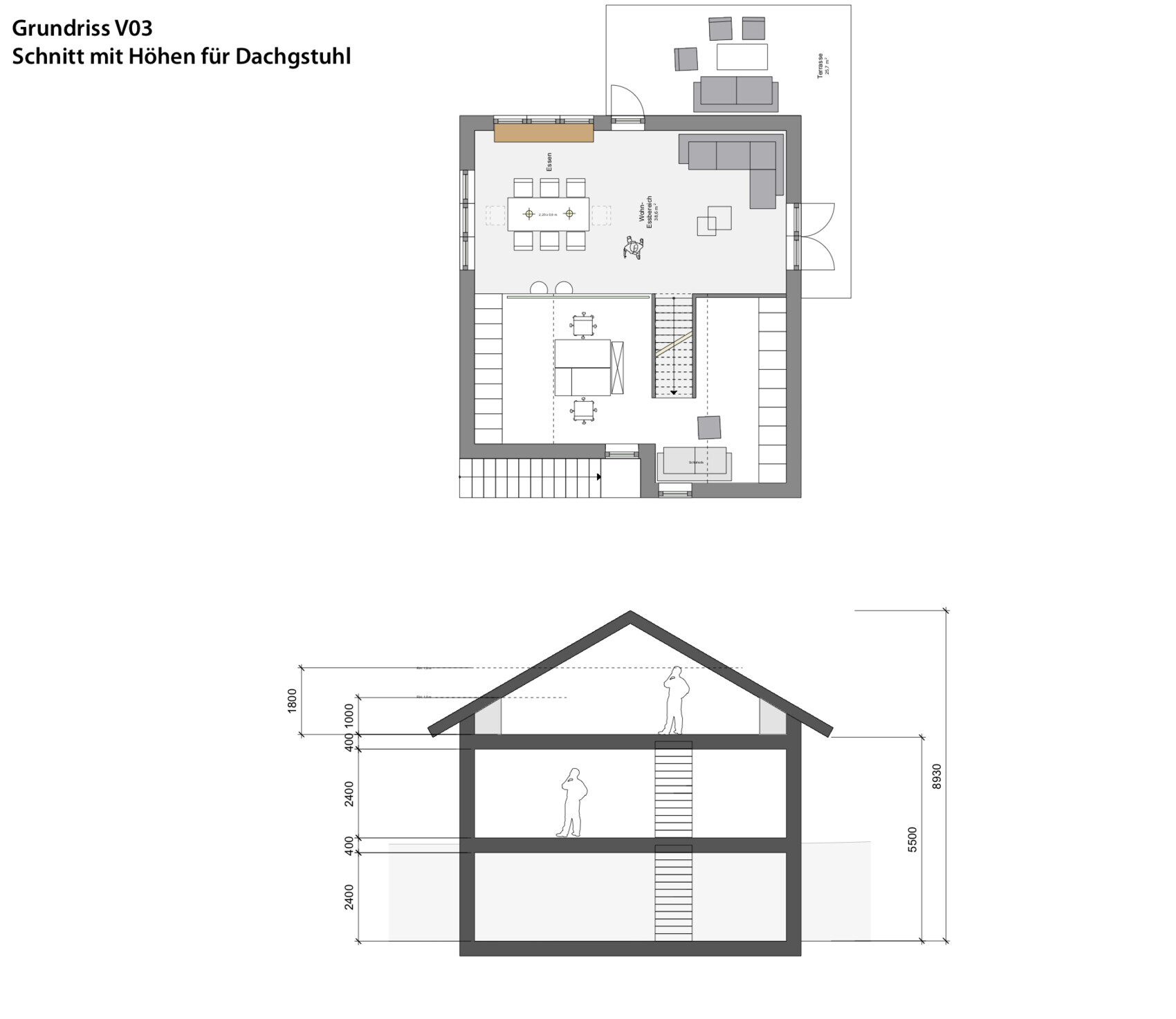

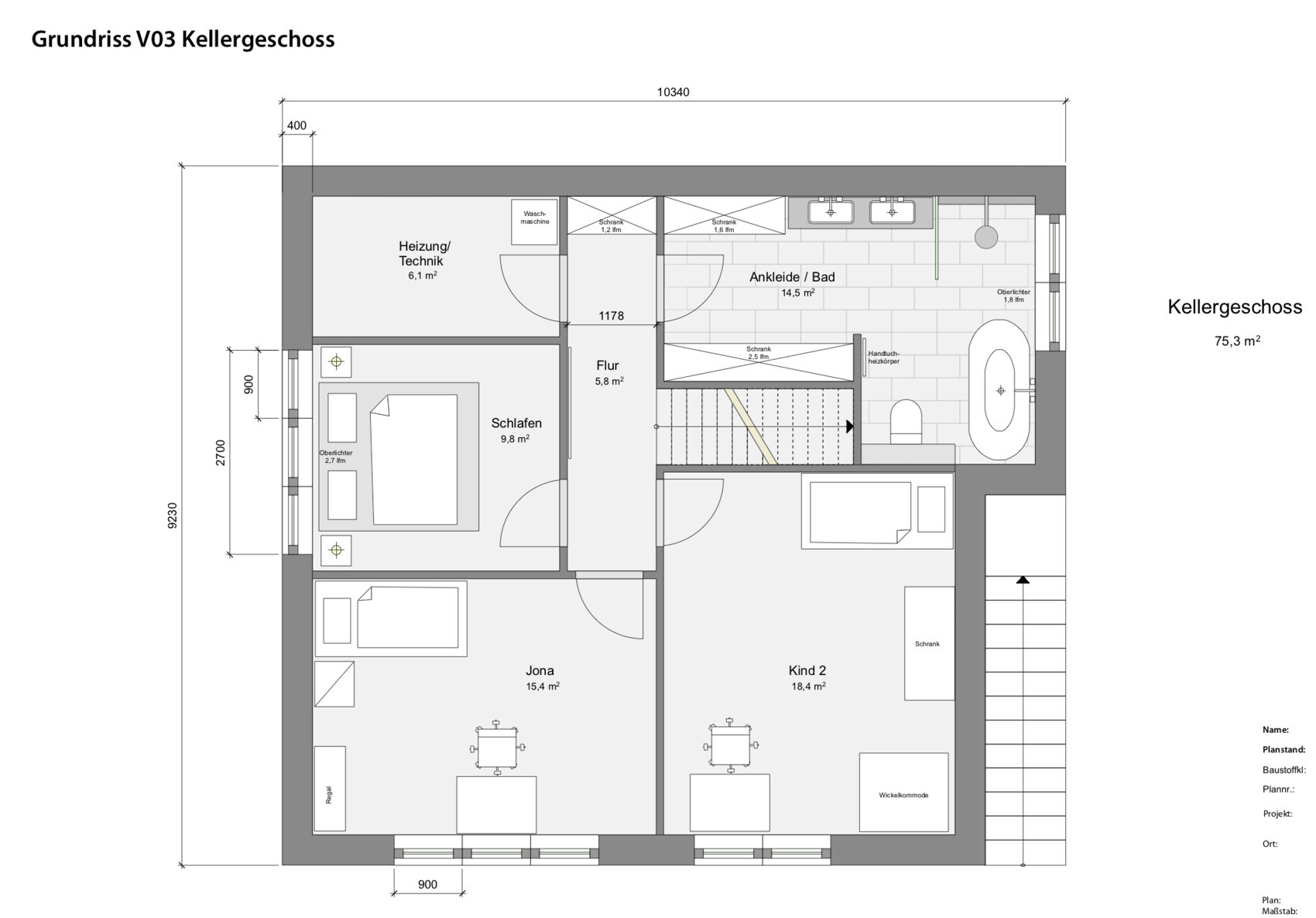

I’m now posting the new floor plan! Although we don’t like the design of the basement in particular. We would like to widen the basement so that the too small utility room and bedroom become larger! The basement would then need to be completely redesigned! But first, I wanted to get your opinions on the floor plan!
- If I were you, I would carefully reconsider widening the house. Making it bigger is always the "easiest" solution, but it also leads to a chain of additional costs, and the entire symmetry axis and structural integrity can change. You’re essentially altering the whole house, not just the basement. I think you already have enough space. We also thought about this when our rooms felt too small, but quickly moved away from it since the lot isn’t endlessly large.
- If you leave out the shower in the guest bathroom on the ground floor and add that space to the storage room, you’ll save quite a bit and gain extra room. I’ve heard from many homeowners that they might use the guest bathroom shower only 2-3 times a year, so it’s essentially wasted space that also requires cleaning and was expensive to install.
- In the basement, I would rearrange so that the rooms on the left become slightly larger, while those on the right naturally become smaller.
- What I don’t quite understand is having two living/dining areas on both the ground floor and the upper floor. Do you really think you’ll carry the meals up to the upper floor consistently over time? I see more potential there for additional guest, recreation, or storage rooms. I would also question the terrace upstairs since you already have one on the ground floor. (Costs!) --> However, prepare it as an expansion option.
DaniMartinez2 Nov 2020 16:23Mr.T2000 schrieb:
- If I were you, I would think carefully about widening the house. Making it bigger is always the "easiest" solution, but it also leads to a domino effect of costs and can affect the entire symmetry and structural engineering. You’re actually changing the whole house, not just the basement. I think you already have enough space. We also considered this when our rooms felt too small, but quickly moved away from it since the plot isn’t infinitely large either.
- If you omit the shower in the guest bathroom on the ground floor and add that space to the storage room, you save quite a bit and gain room. I’ve heard from many homeowners that they use the guest bathroom shower only 2-3 times a year at most, so it’s basically wasted space that also needs cleaning and was costly.
- In the basement, I would shift the rooms so that the rooms on the left become somewhat larger, while those on the right get a bit smaller.
- What I don’t quite understand is having two living/dining areas on the ground floor and first floor. Do you really think you will carry food upstairs regularly over time? I see more potential for additional guest, recreational, or storage rooms up there. I’d also question the terrace above since you already have one on the ground floor. (Costs!) --> But you could prepare for a future expansion.
Hey, cool, and thanks for the feedback!! So, I have to quickly explain about the first floor! It’s basically just supposed to be the office, which will be open to the living area... I’ll upload a picture to show roughly what it will look like!!
