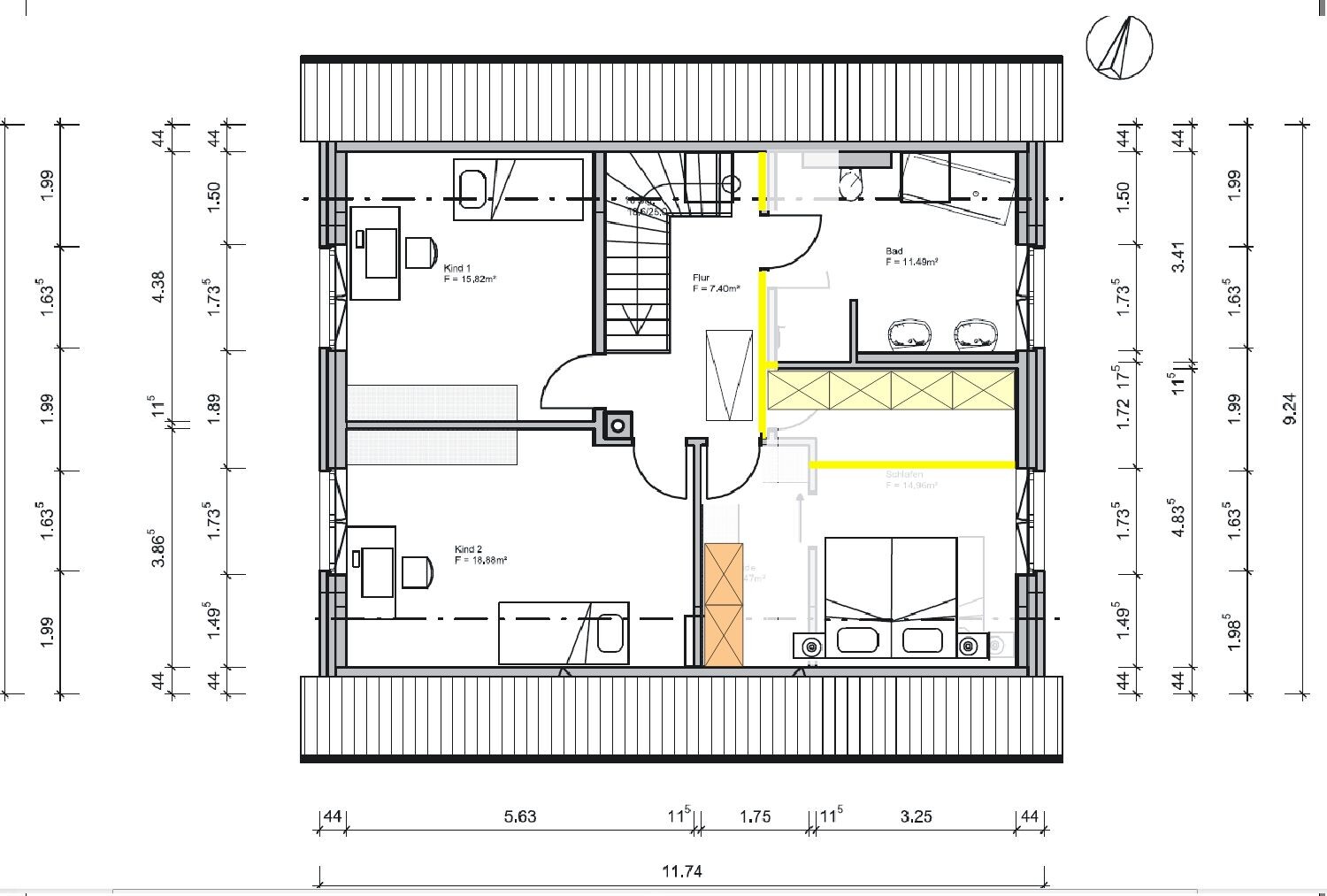

We’ve been busy over the past few days working with our construction company to refine the floor plan. Attached is the current version. We are quite satisfied with the ground floor for now. We will probably have the coat closet cutout removed and instead have the living room door shifted slightly so that a wardrobe can be placed in the corner between the utility room and the living room door.
What do you think about the ground floor?
We definitely still need to work on the upper floor. The bedroom and the walk-in closet definitely need to be larger.

kbt09 schrieb:
On the upper floor, I would arrange the bedroom/walk-in closet differently.
That’s a great idea, thanks!
