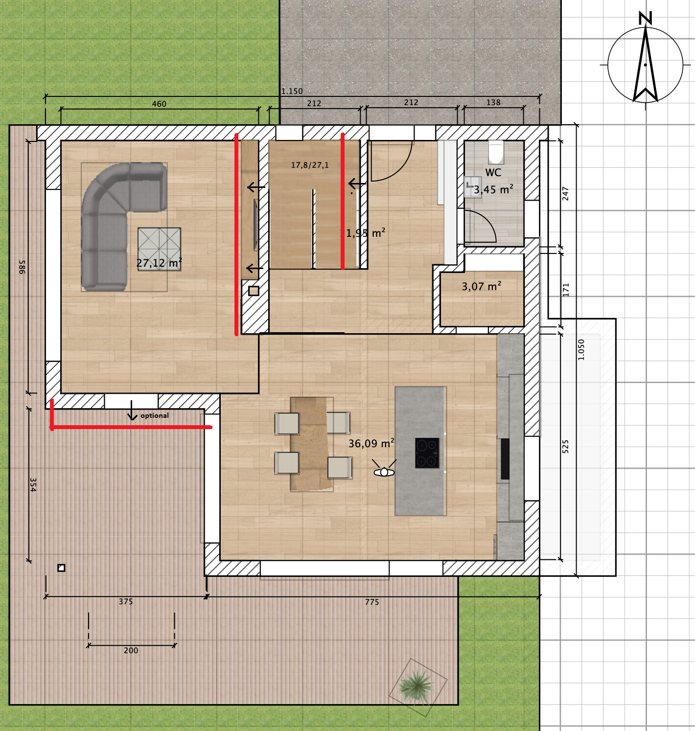

- Staircase from ground floor to upper floor should start in the dining area and not be visible from the living room
- Living room preferably on the west side, as we both work very long hours
Who did the planning?
Do-it-yourself, using various floor plans as templates
Straight staircase, layout of living, dining, and kitchen areas, corner fireplace
What do you not like? Why?
I am unsure if the rooms upstairs might be a bit too narrow due to the straight staircase. This could be improved with a landing staircase, but that is just a minor point to accept.

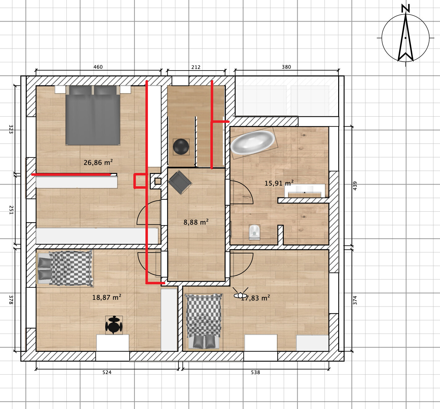

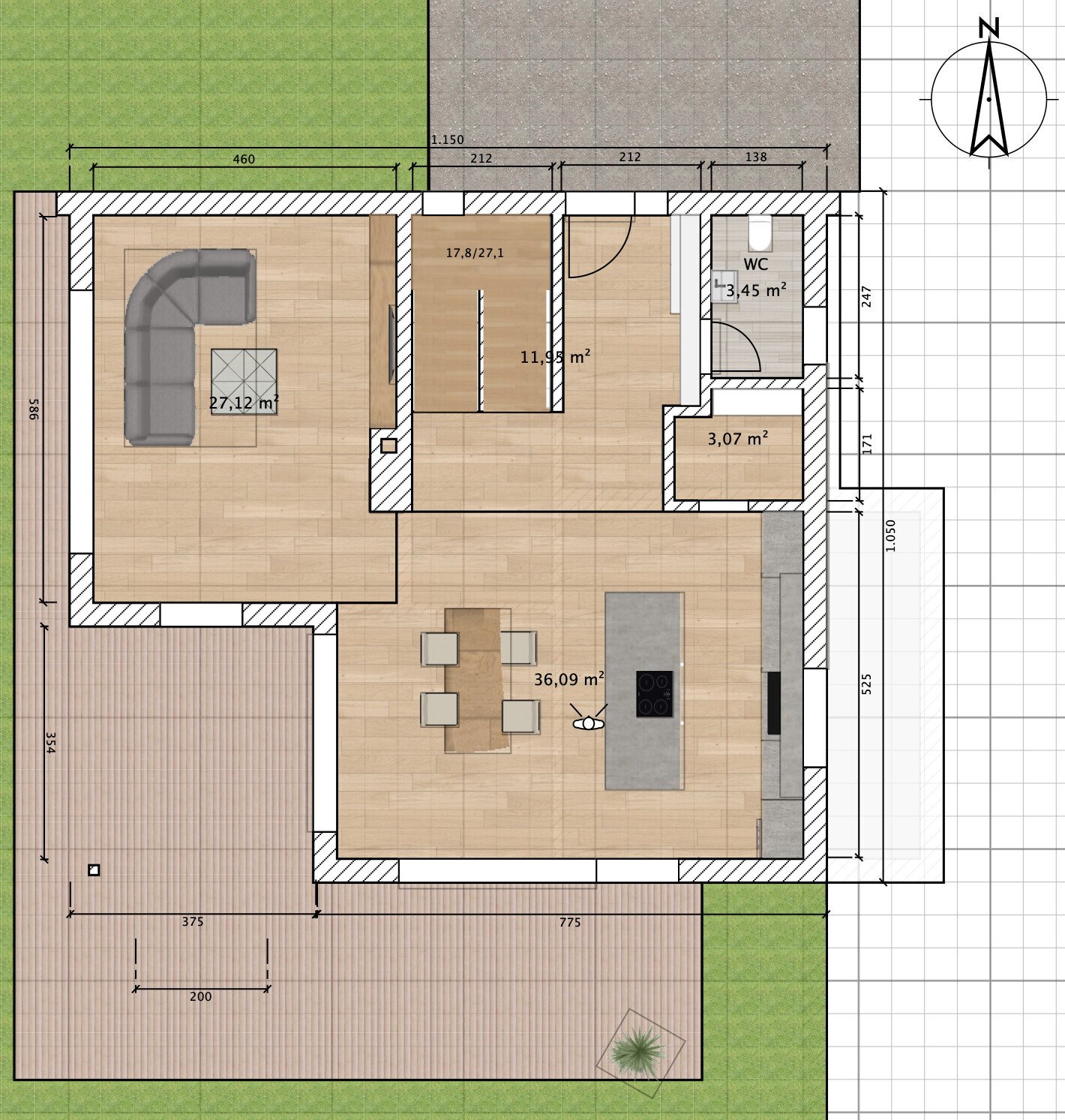

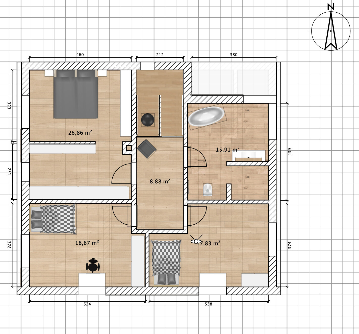

benediktr3 Oct 2019 12:17Progress is slow but steady on our end. The plot has been leveled, and we have found our partner for the planning. We have also revisited the staircase design in detail and concluded that a landing staircase suits our needs better.
By now, we are very satisfied with the upper floor and have no more change requests. However, I am still not 100% happy with the ground floor, specifically the entrance area (situation with guest toilet, cloakroom, and the sightline towards the kitchen island).
So, once again, a question to you all if anyone has ideas. The condition is that the room and staircase positions remain the same. We also want the living room depth to be at least 4.60 m (15 feet). We have visited various model homes and friends’ houses to check these dimensions.
I will share the basement level later. Hopefully, you might still have some suggestions.

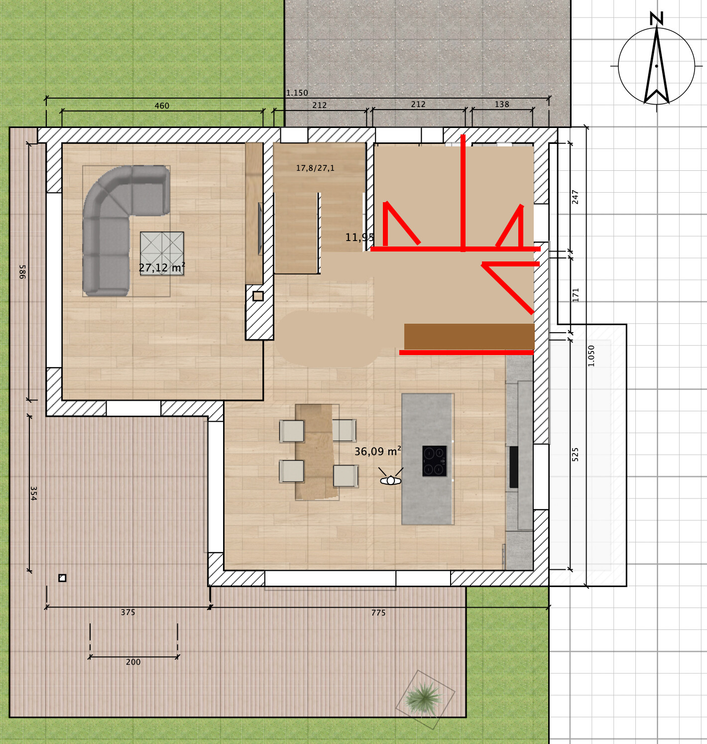

The problem will be that you haven’t planned for a cloakroom or wardrobe space: you are looking at a pile of jackets that are in use during autumn and winter, as well as shoes and bags. There is hardly any space for a chest of drawers, chair, mirror, or closet.
It seems no professional was involved who would consider these aspects. Also, the pantry is more of a nuisance, and the kitchen is too long...

Basically, I already like your floor plan quite a bit. To improve the entrance area, you could move the wall between the living room and the stairwell about 20-30cm (8-12 inches) towards the living room. A width of 4.20-4.30m (13 ft 9 in–14 ft 1 in) in the living area is more than enough, especially since you visually have a spacious view towards the dining area. This doesn’t hurt the living room (on the contrary, it makes it cozier). As a result, the stairwell shifts westward, which relaxes your entrance area! You’ll then have enough space to plan a generously sized wardrobe/coat storage.
Upstairs, it doesn’t affect the master bedroom or the kids’ room if the wall/hallway moves 20-30cm (8-12 inches) westwards as well. You have more than enough space in the bedroom and even a very large walk-in closet.
Alternatively or additionally, you could add a small privacy wall as a room divider or visual break, extending from the fireplace towards the stairwell. About 1.5-2m (5–6.5 ft) are enough. This creates a new sightline and prevents your dining/kitchen area from looking too much like a ballroom. Unfortunately, many people nowadays tend to design (too) large spaces and then wonder why their rooms feel uncomfortable.
I made a sketch for you (see attachment)

I hope you might still have an idea.Would it be possible to have the entrance on the east side? If so, I would probably reduce the kitchen size a bit, move the entrance including the cloakroom to the right side of the plan, and place the toilet plus pantry next to the stairs. The goal is also to interrupt the sightline from the front door to the dining room.B

The issue will be that you haven’t planned any cloakroom space: you’ll be looking at a pile of jackets that are used in autumn and winter, along with shoes and bags. There is hardly any space for a chest of drawers, chair, mirror, or wardrobe.
No expert seems to have been involved who would consider such things. Also, the pantry is more of a disturbance, and the kitchen is too long...

I made a sketch for you (see attachment) Thanks for your suggestions and sketches. It’s definitely an approach. We actually had that in the plan at one point but discarded it because of the depth. The sofa should be at least 0.5m (20 inches) away from the window. (Yes, I know, floor-to-ceiling windows and sofa ) There will be fixed glazing. I also definitely find the cooking/dining area too large. I think we are getting tangled in too many wishes with a fixed room layout.

Would it be possible for the entrance to be on the east side? If so, I would probably reduce the kitchen a bit, position the entrance including the cloakroom on the right side of the plan, and place the WC plus pantry next to the stairs. The goal is to interrupt the sightline from the front door to the dining room. Access from the east might also work, but probably more northeast, since the street slopes from north to south. I thought the elevation plan was uploaded in the previous post.

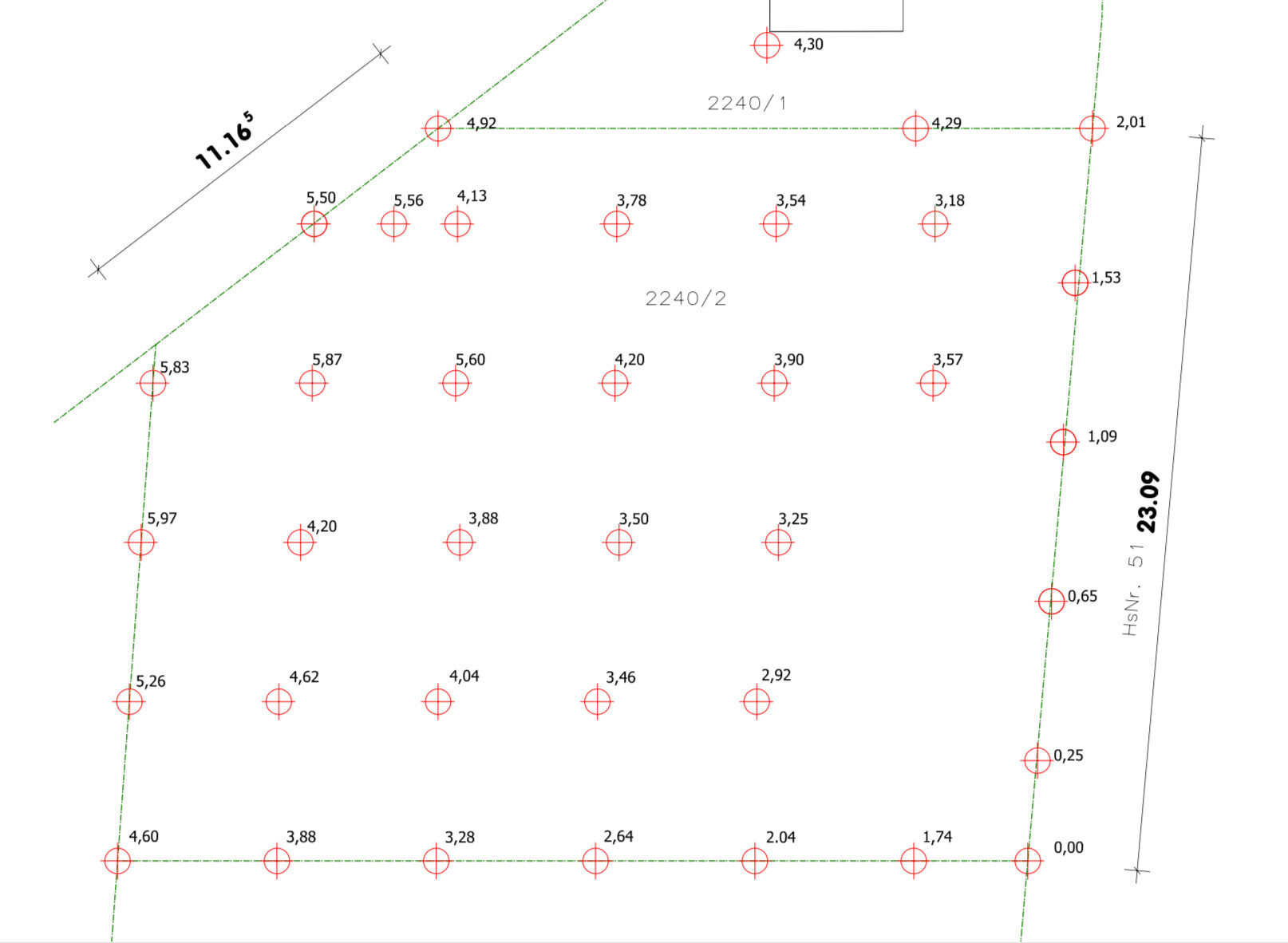

I thought the elevation plan was uploaded in the previous post. There’s no north arrow on it—I had to check if it’s oriented correctly.
The setback on the east side is still a bit unclear to me. It doesn’t look like 3m (10 feet) to me, and I can’t really see the boundary line.
If the slope is that steep, relocating the utilities would definitely be some work, and you’d probably need to build up about a meter (3 feet) of fill. However, if you’re excavating a basement, I don’t think that makes much difference. I do believe it adds a lot to the overall comfort and feel of the home.
The stair landing was shortened a bit—so it’s longer at the top on the other side.
