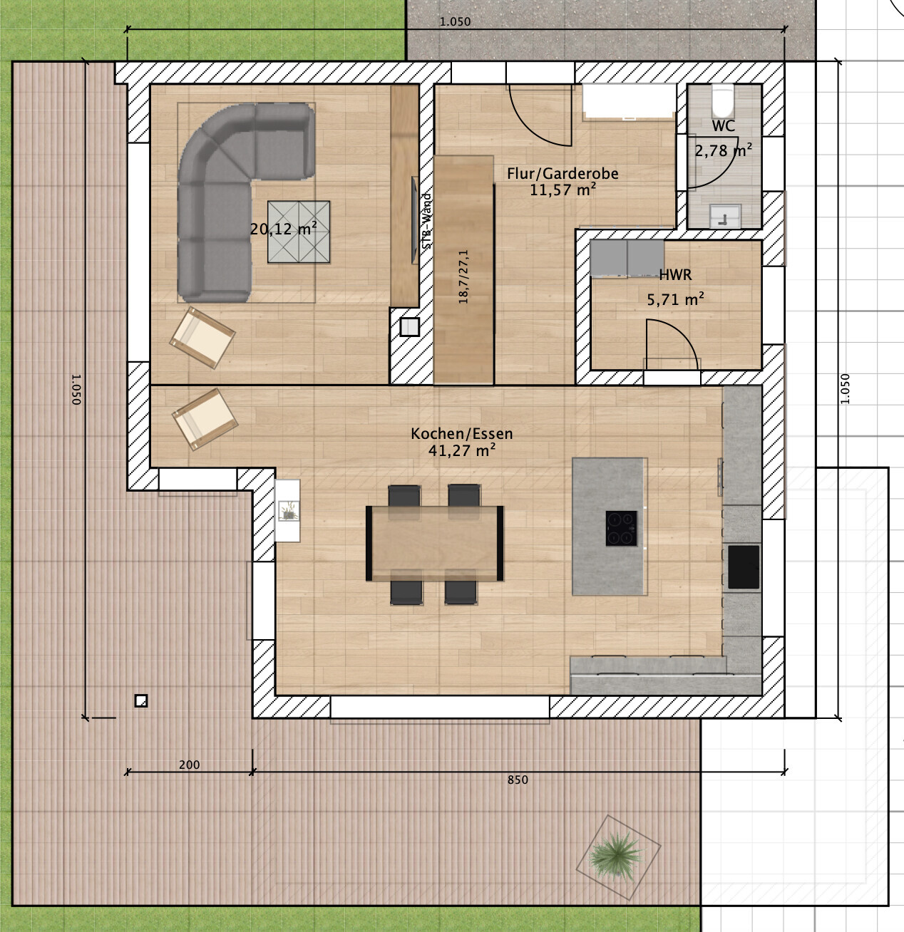

Unfortunately, I cannot provide a site plan at the moment. Therefore, here is a screenshot of the property. I have roughly traced it on the ground floor plan. The exact orientation definitely needs further planning. It is plot number 51.

benediktr23 Jun 2019 19:32ypg schrieb:
I would place the coat closet against the interior wall and make it larger as a half-room, and reposition the bathroom door for better access.
I would rotate the staircase 180 degrees.
I would likely make the utility room accessible from the hallway and place the tall kitchen cabinets along this short wall. I would skip the base cabinets on the lower side of the plan and instead install a panoramic window or patio door there, so you can be outside while cooking.

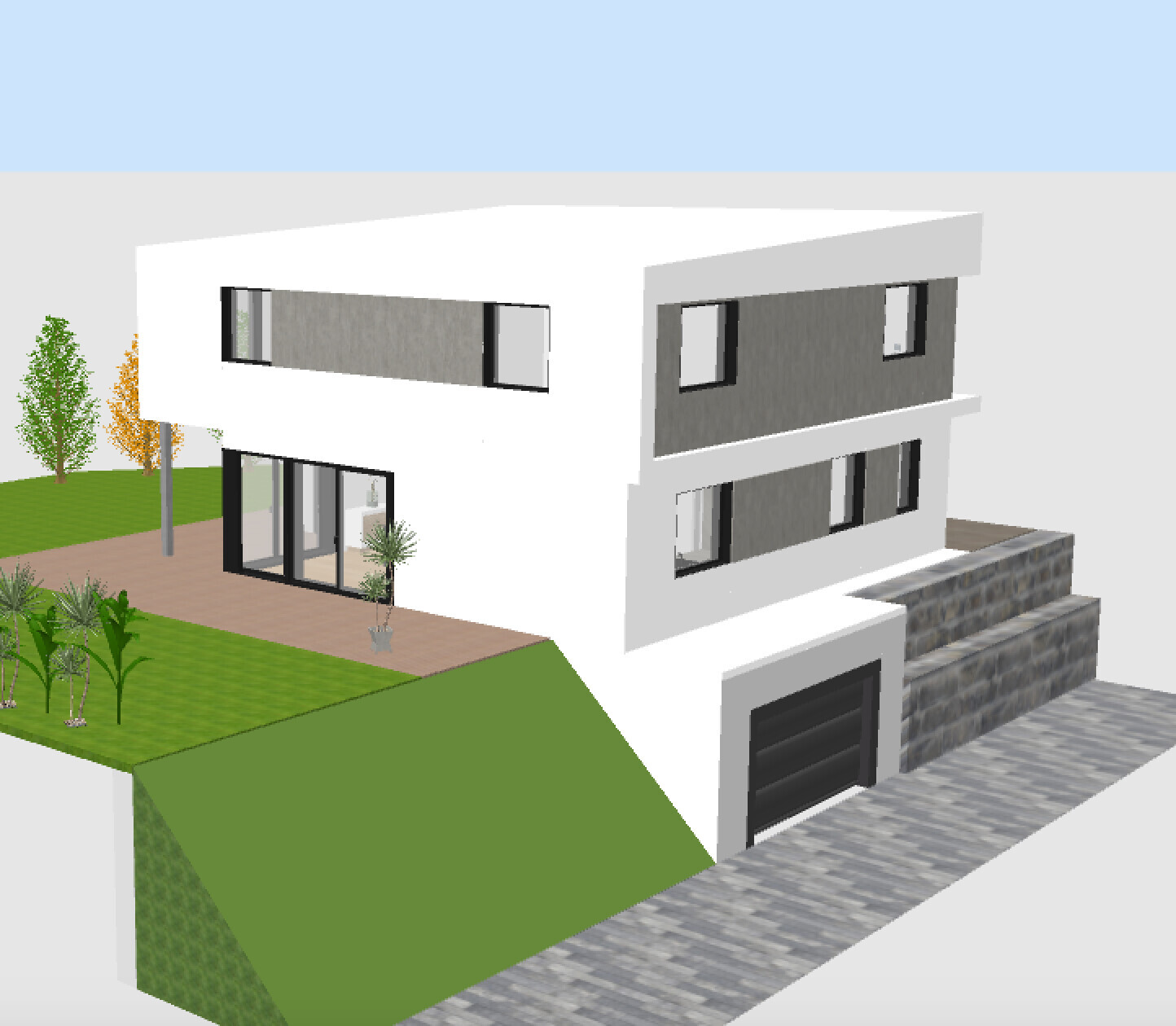

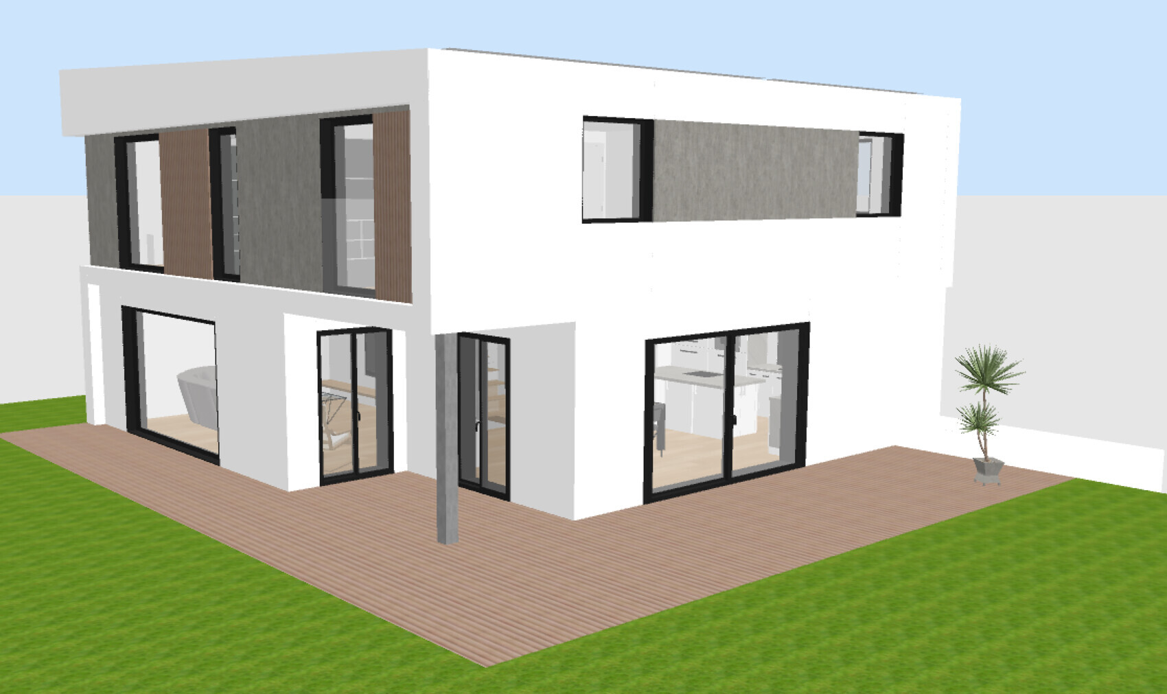

Upstairs, I would also make several changes to the bathroom: relocate the door, move the toilet next to a window, and adjust the drainage to connect with the guest toilet... Now with a large panoramic sliding window on the south side with access to the garden. What do you think of the elevation? Is it too busy?

What do you think of the design? Is it too busy?Tough question. Honestly, what bothers me the most is the column. Is it really necessary? Otherwise, it’s not a disaster—just average, I’d say. Is average enough?benediktr schrieb:
What do you think of this design? Is it too busy?That’s not what I meant. I would have aligned the terrace window on the right with the upper right window.
benediktr24 Jun 2019 19:14kaho674 schrieb:
Tough question. To be honest, the column bothers me the most. Is it really necessary? Otherwise, it’s not a disaster—just average, I’d say. Is average good enough? I actually like the column. Tastes just differ. Average should be enough considering the budget. What would be “not average” or a highlight for you?
That’s not what I meant. I would have aligned the patio window on the right with the upper right window. I know. We’re still unsure whether to have access to the utility room from the hallway. If yes, the tall cabinets could go against that wall and I would have space for the window you suggested.

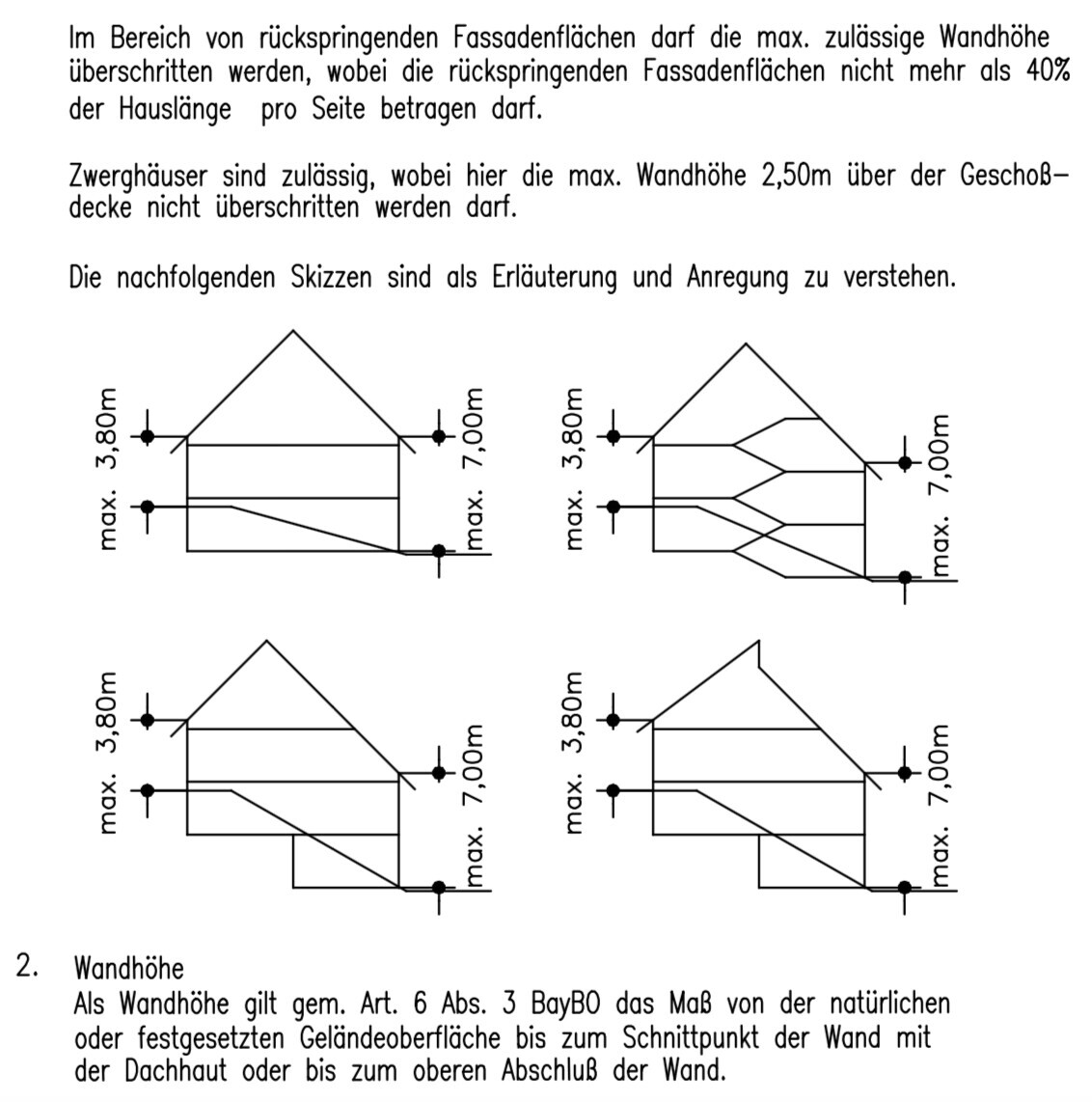

benediktr6 Jul 2019 21:09I have another question regarding our development plan, which appears to be stricter than expected. First of all: There have been some exemptions granted for neighboring houses, as the person responsible at the building authority has already informed me.
My question specifically concerns the maximum allowed heights. It states that in areas with recessed facade sections, the maximum permissible wall height may be exceeded.
Does this mean that if I build two full stories set back over a basement, a permit might be possible?
It is roughly meant like this:
Unfortunately, I can’t illustrate it better in the software, but the slope is more of a bank, and the actual house stands on a level area.
